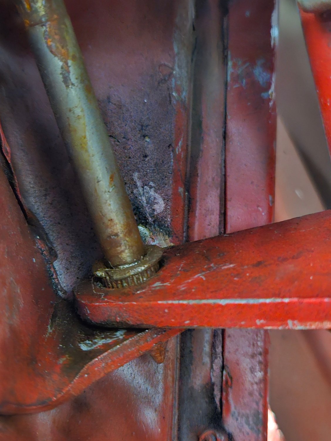

I replaced the upper and lower hinge pins on my car about tens years ago with a kit that added greasable pins on the upper hinge to remove the rivets. Around this time last year I noticed the door was sagging more and found the lower bushing in the lower door hinge had worked its way up on the hinge pin. Using punches and screwdrivers I was able to get the bushing about halfway into the hinge before giving up. A year later and I have the same problem again: Sagging door, lower bushing walked up, can only beat it back in halfway with a screwdriver/punch.

The lower bushing was installed upside down. The flange portion should be facing down holding the bushing captive.
The hole size on your car looks excessive so it isn't pressed in, it's just kinda held together with unicorn dreams.
Put a floor jack under the rear of the door and pull the pin, flip the lower bushing & reassemble- done.
If there's not enough room for the bushing flange, spread the door side hinge a tiny bit.
The door is heavy and will be wobbly when the lower pin is removed, might want another person to steady it. Watch those fingers!!

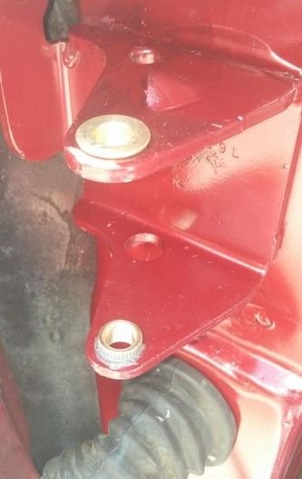

Bushings correctly installed.
