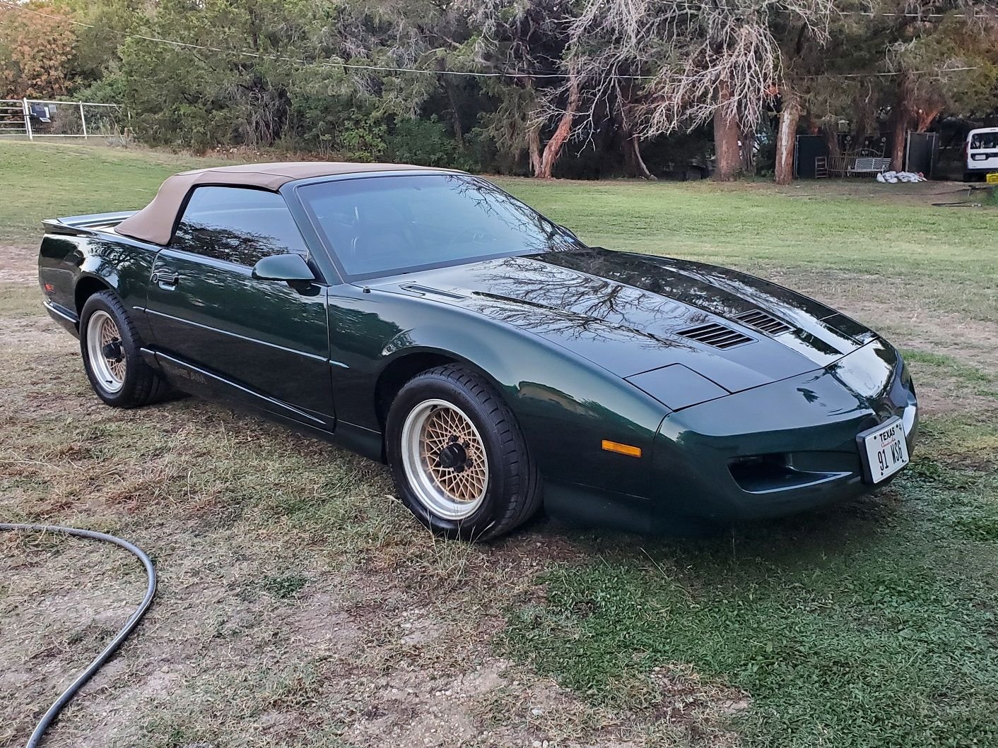

Hey Guys....
Curiosity for y'all.....Looking for opinions. I could live with it, but in comparison, I'm irked....
Yesterday I drove my 91 TA Vert because it was just the perfect "drop top" day......that was after having driven my 94 TA Vert and my DD 15 Silverado Crew back to back to back......and in comparison, the 91 does not appear to have the same braking power using a proportional comparison of brake pedal application.
I realize that I may be comparing apples and pineapples. (As you know, the 91 has front disc and rear drum, with single piston calipers up front, and the other 2 vehicles have disc brakes at all 4 corners) but I'm under the impression that the fronts are 80 to 90% of the braking power.
I have records on the car from Day 1, but I have not checked to see when the brakes were last replaced or there was a fluid flush, and I'm not convinced that a fluid flush would make a difference anyway. I also don't remember if the brake lines are rubber or braided stainless, either, since it's been a while since I removed the wheels.
I see it pointless to change the rear drum brakes, but would like an improvement in the front. I have Powerstop on many of my vehicles.....so what would you think about the Powerstop K1482-26 kit just on the fronts, for perhaps an improvement? I really don't want to get carried away with replacing calipers or anything like that......
Thanks!
