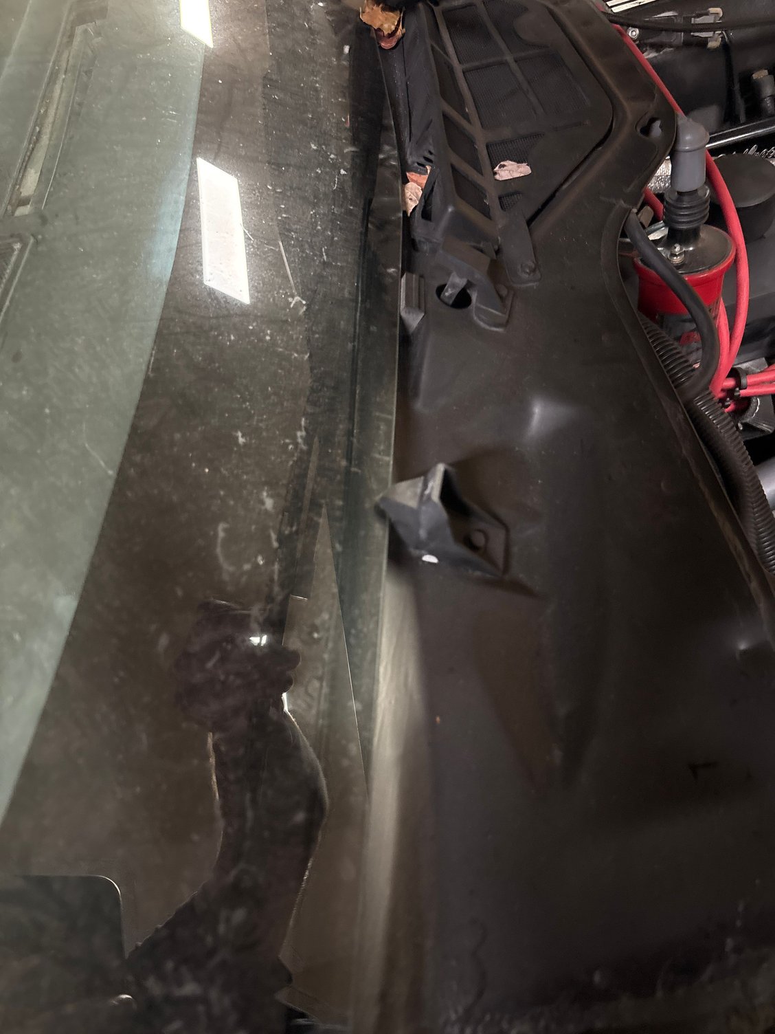

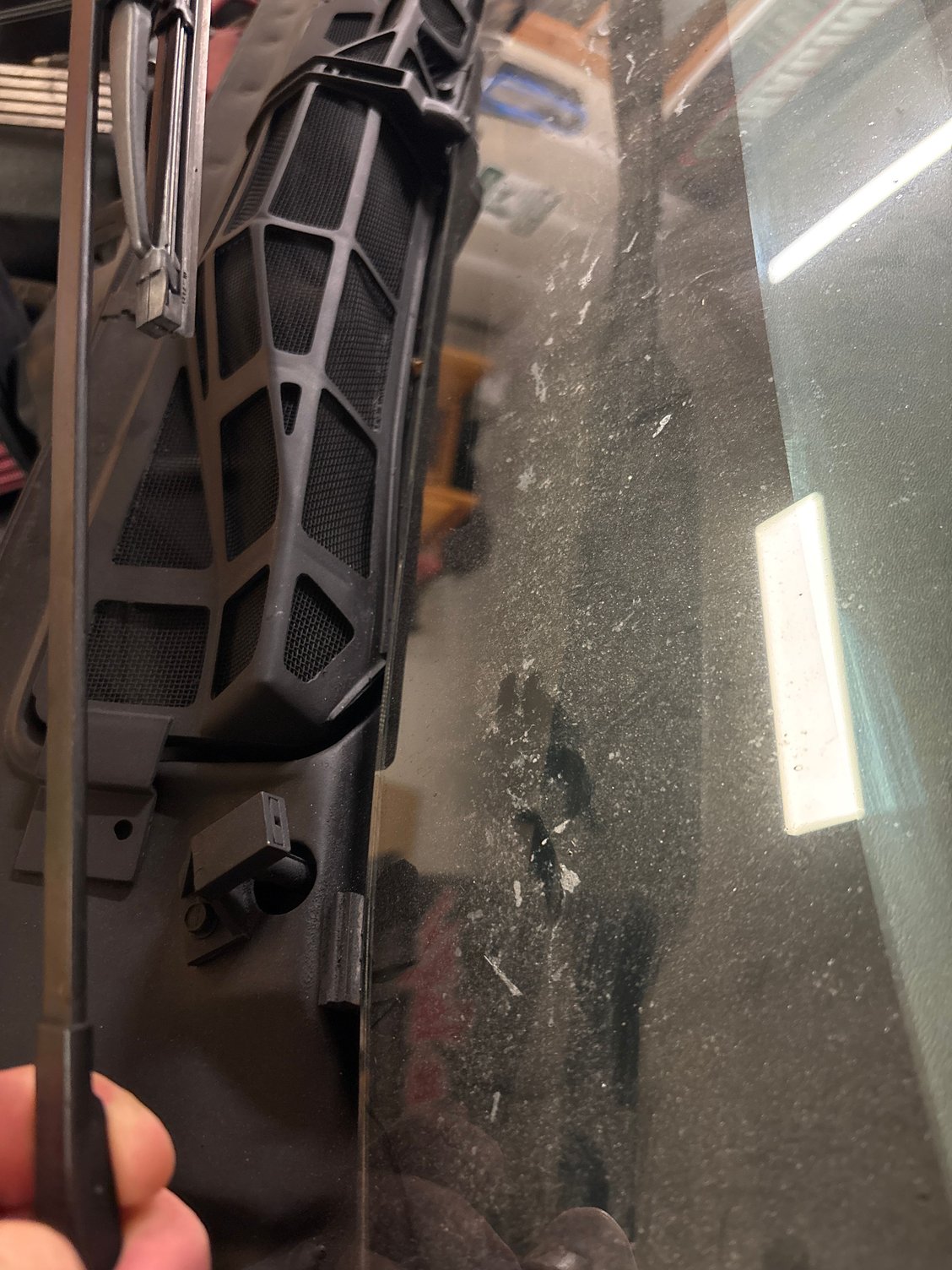

Hi all. Looking for a photo of the stops/mounts that the lower edge of the windshield sits on. Car is painted and new windshield going in soon, but it's been so long since I took all of that stuff off I need a reference photo of how it goes back together.
From the photos I have, it looks like the passenger side had a black plastic bracket that was also the resting mount for the passenger side wiper. The driver's side windshield mount is harder to tell from my photos.

This is my 82. It's a new windshield as of last year when it was painted.

That’s perfect. Thank you
