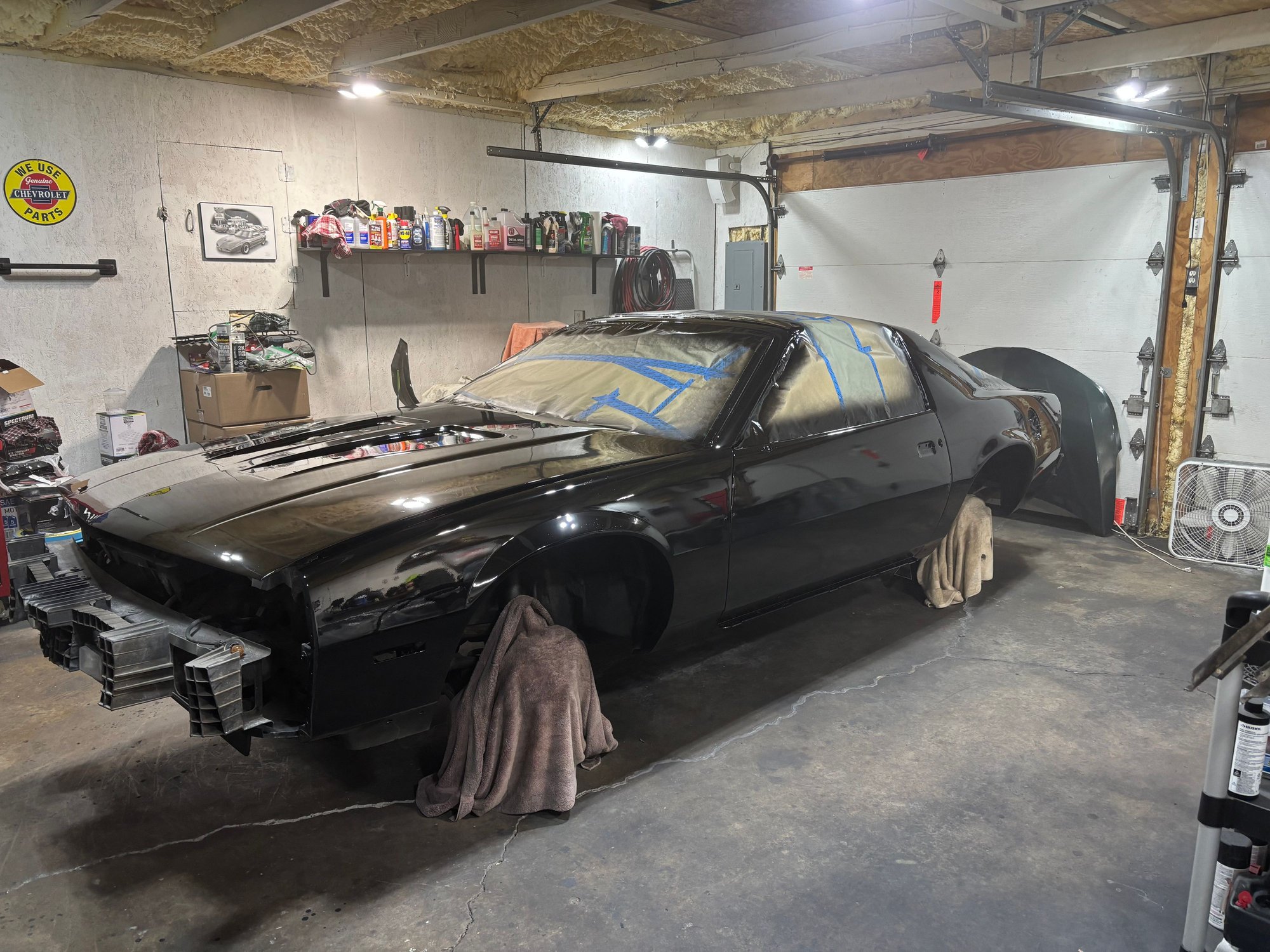

Looks great! Any special prep to the shop area to get ready for the paint?
I am planning on draping my entire garage in plastic and getting the floor wet.
Honestly, that was my plan too, but when I painted my ground effects, I had very little contamination, at least nothing that won't be removed when I cut/buff. It was the same with these parts. This weekend I plan to shoot the car. I believe I will sweep the floor and wet it down, just to be safe.

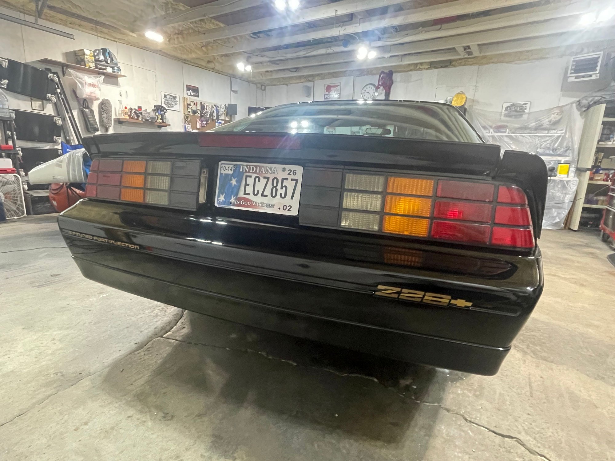

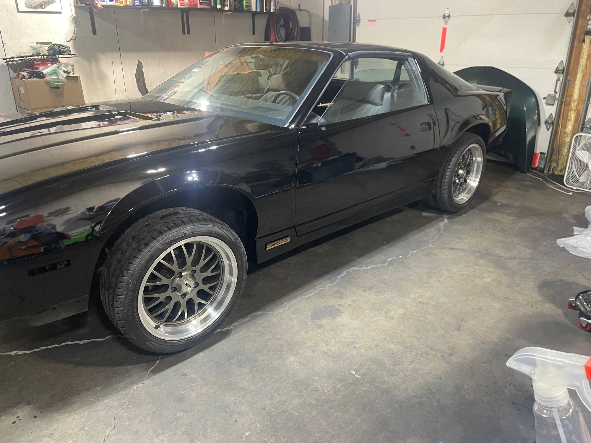

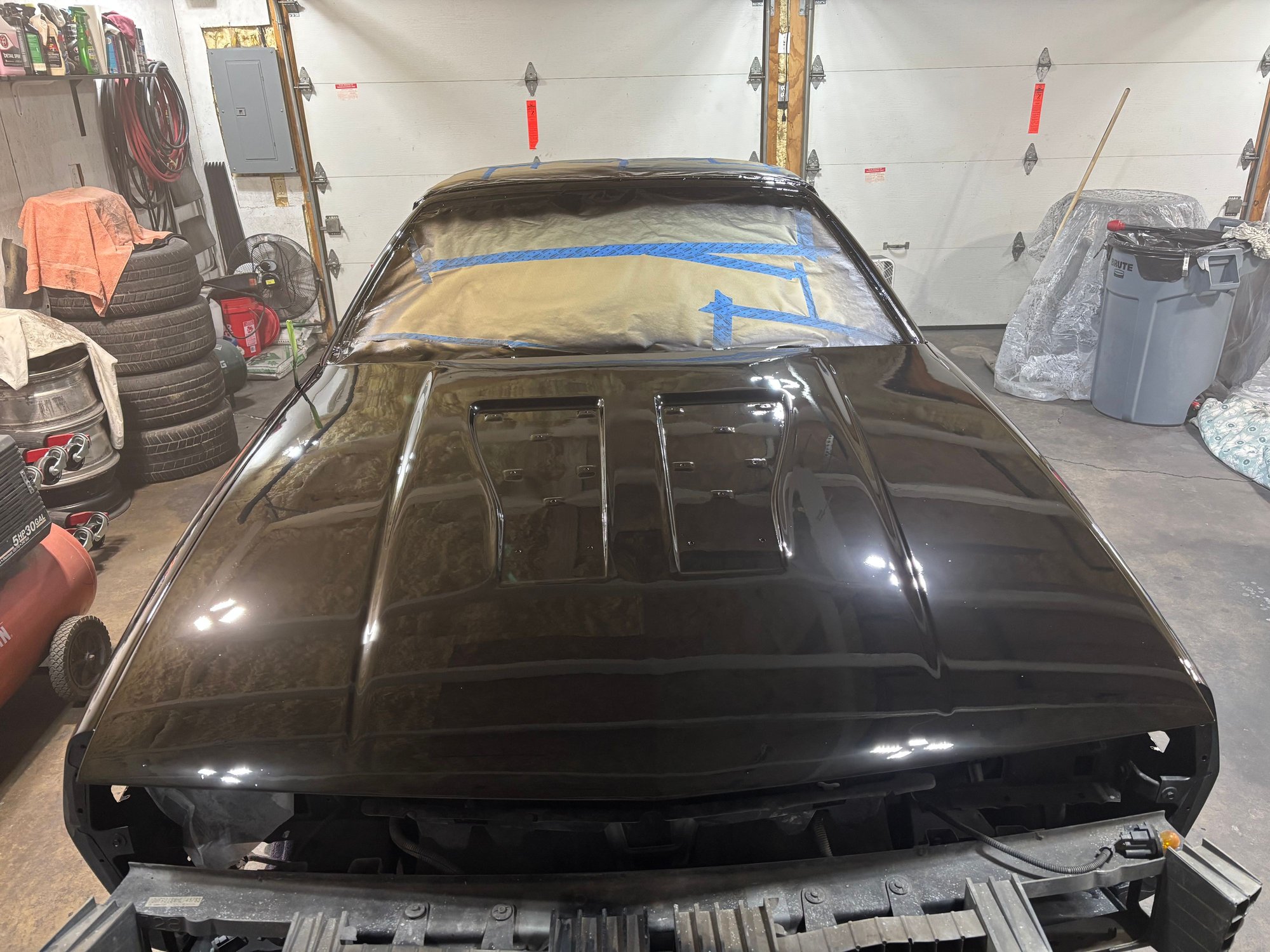

Got the car painted today. Not a perfect job, but once cut/buffed, it will definitely be good enough for pleasure cruising…

Thanks man, it’s for sure more Maaco than Mecum, but I knew being a first timer and black, it wasn’t going to be perfect!

Amazing progress. I can't believe how nice the rims turned out.

Thanks. Yes, they did a nice job on the rims. It’ll be presentable when reassembled…
It's better not being perfect and that you painted it and it didn't cost a fortune to do like at a professional paint & body shop. Plus you didn't get trapped in paint & body shop Hell waiting your entire life to get it done.
It not being perfect and costing a fortune means your mind can rest at ease when driving it and enjoying the car like it should be enjoyed. It it gets nicked and dinged you can repair it yourself.
The best part is you can take pride in the job you did and you get to tell people you painted it.
I'm proud for you and the job you did.
let it sit for a few days, sand the clear with 800 and put 3 or 4 more coats of clear over it.
you might not need to buff it then, and itll look that much better

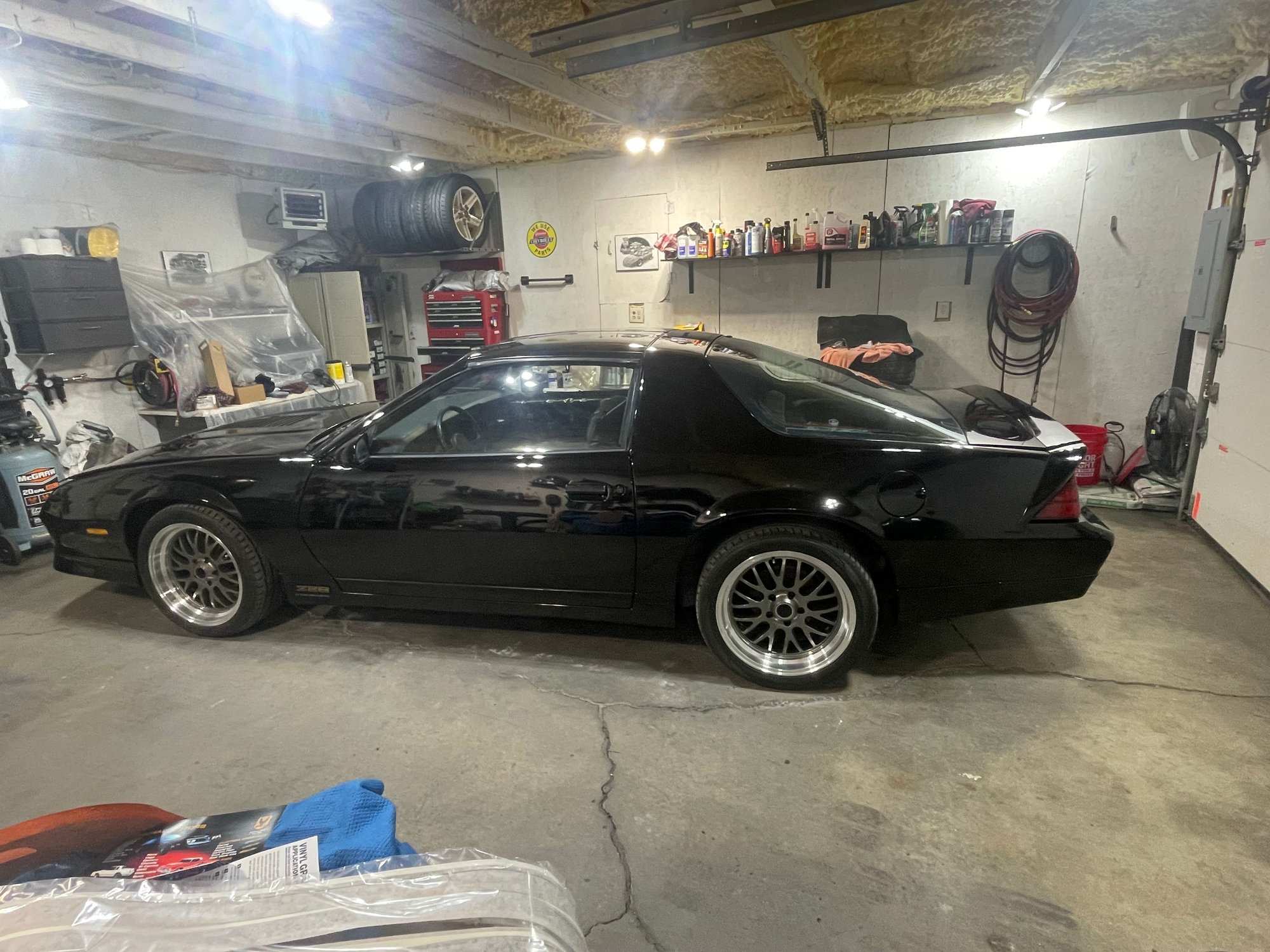

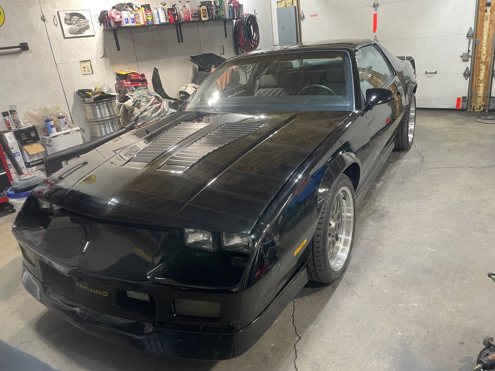

Final product…. I am going to run it like this for a bit, but I have the gold wheels and Phoenix Graphics, that I will put on later. It is on a tender, so I don’t have the hood all the way closed and I need to tweak the back hatch a bit yet

Very nice. A glossy finish on a black car distracts from minor paint imperfections. Sure, the imperfections are apparent when people are right there examining it from 5 feet away, or when cameras are focused on the car at close range, but when that shiny black car drives by, it'll turn heads, and nobody will notice any imperfections.
I think the car looks good without decals and stripes and especially without body side molding. I'm a black and silver guy, not a black and gold guy (although we have both in Vegas lol), but the simple gold accents look nice on the solid black car. Gold wheels, gold rocker emblems, gold bumper emblem and front license plate name in gold (which answers another thread from TGO's past about gold or silver front license plates) will stand out on the solid black car without any decals or stripes.

Agreed, as long as you aren't right up on the car, it looks pretty decent, but making a show car wasn't the goal as it will be driven. Thanks for the positive reply!
