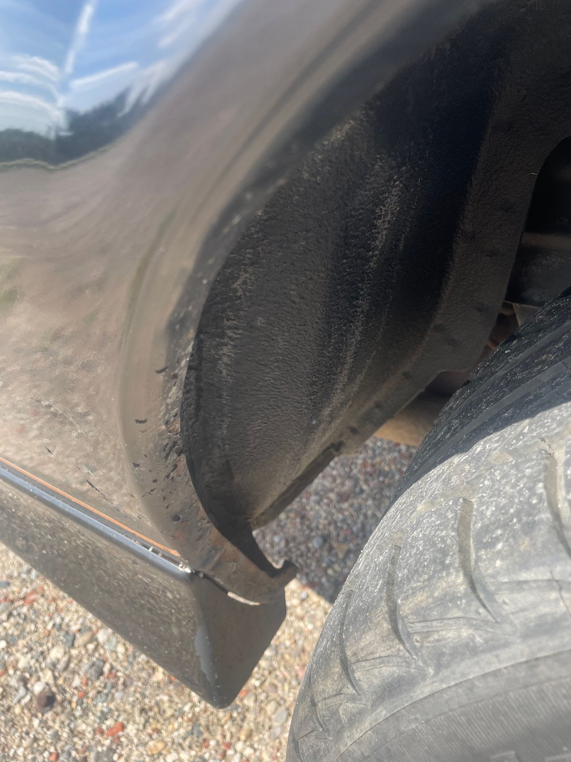

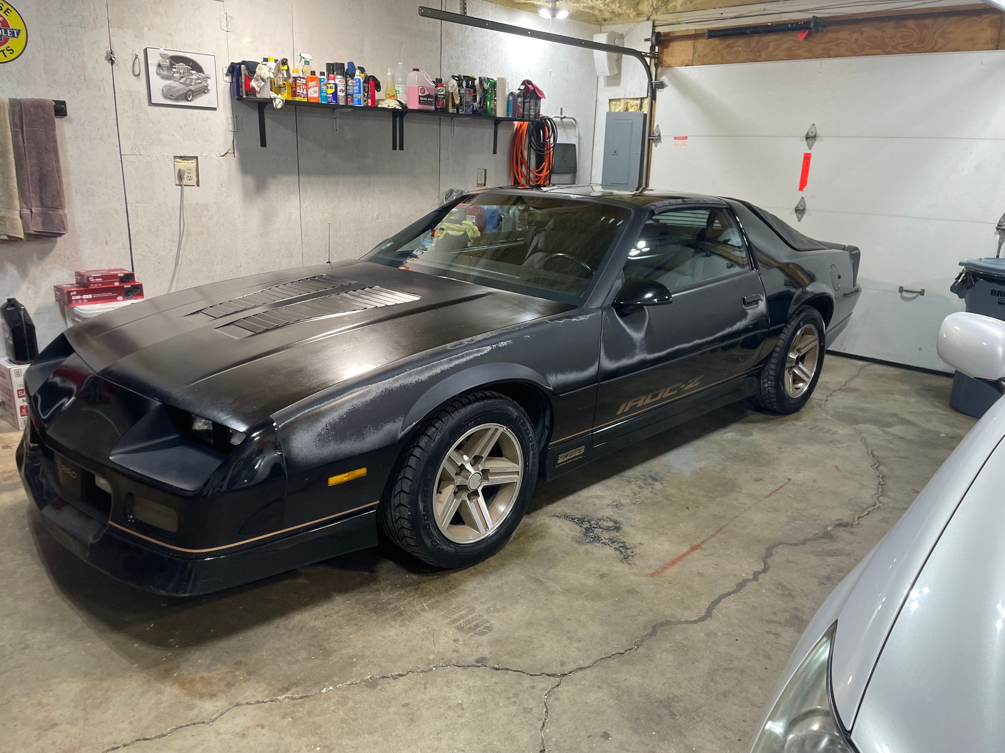

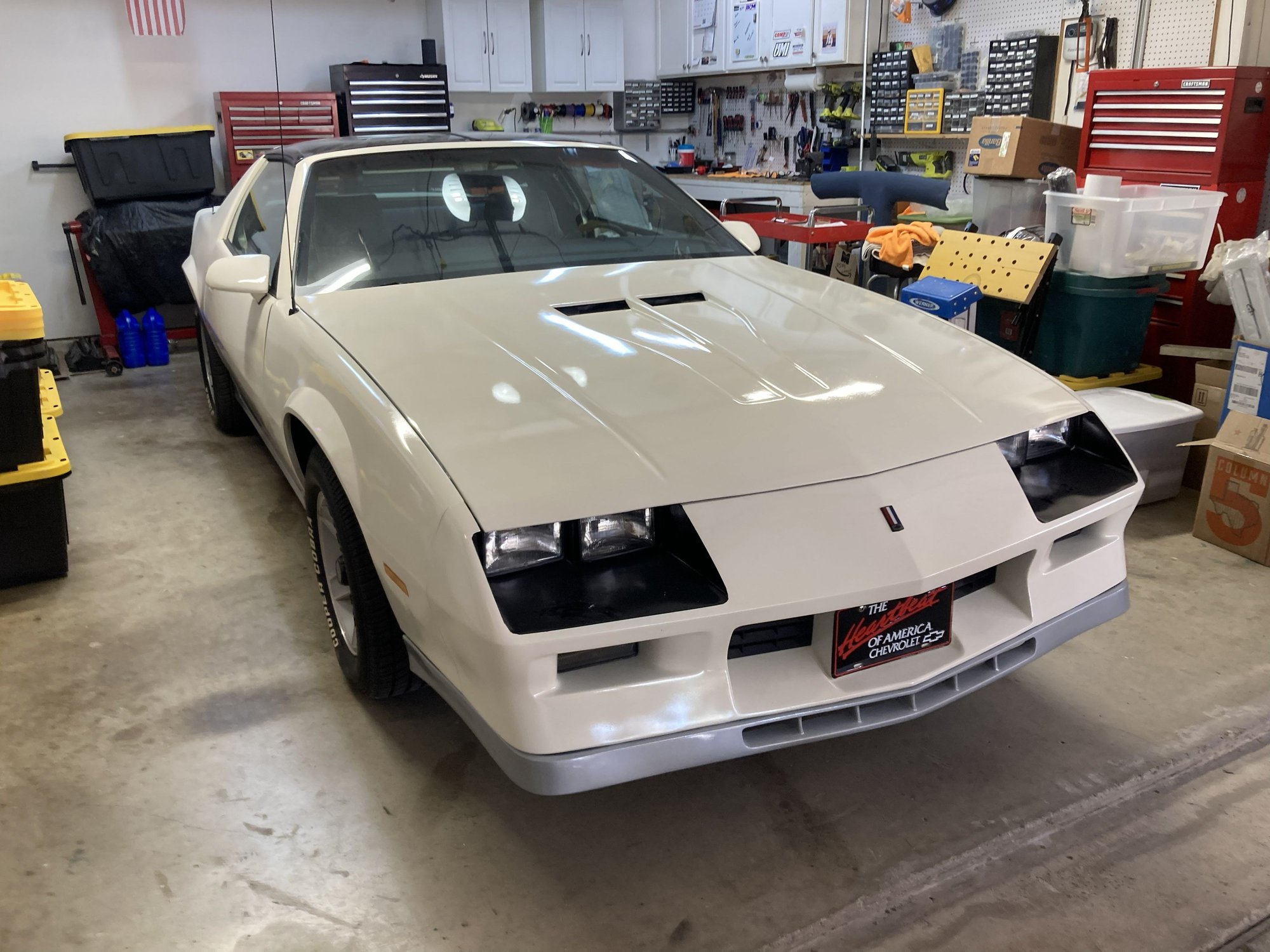

At 55 I have decided to try my hand at painting a car... My normal paint/body guy is going to give me direction as I go. I found this car, body is clean as far as rust, but we do have a door dent to repair. I figured this was as good a car to start with as any as the odometer shows 92K miles, but the numbers don't line up, so who knows how many miles it truly has. It runs/shifts great and doesn't leak any fluids which is another plus! Tear down has begun....I'll try to add photos as I go along.

relpalce the door.
by the time you do the labor and materials to fix that dent, a $50 replacement door will be much easier.

Originally Posted by bk2life
relpalce the door.
^^This, IMHO. That dent is in the worst spot! The door crash bar is behind it, making moving the skin metal back out a real challenge, if you can do it at all. The dent goes all the way back to the back edge/seam for the outer skin, so that'll be an extra challenge to get right in the door jamb and the skin. Additionally, if you don't pull/push it out, the amount of body putty will result in a really bad repair showing up sooner, than later.
Maybe try your hand at pulling it out while you search for a rust-free replacement door, and see which happens first?
Those rub strips do not look OEM. Pull and replace with something that looks more OEM-like, if that's even possible. Alternately, leave them off for a cleaner look.
Prep is 95% of the paint job. That paint is very tired, I'd get rid of all of it if you can. I put some 'sweat equity' into a paint job on my 71 Trans Am, spending about 3 days wet-sanding the primer getting ready for paint. By day 2, I could feel the imperfections in the surface where I was working. It's a great skill, but I didn't keep up with it. Sadly, the painter/body guy took some shortcuts that eventually showed through after the paint was applied. Where there was no body work, though, the finish was awesome!
Other than the dent, and the clear coat that has left the chat, that car looks pretty clean! Nice catch!!
The actual body work/dent repair is going to be done by my paint/body guy. I will go with whatever route he suggests on the door. He is very good (doing work currently on vin#001 1970 Camaro), so I trust his judgement. Once he has the door dent, other small dents done and body panels aligned, I will then start the sanding process.

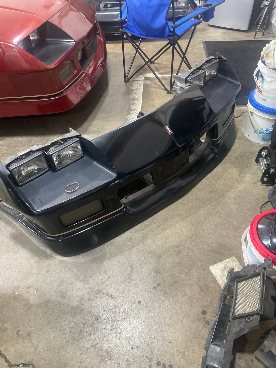

You folks that do this for a living…HATS OFF TO YOU!!! If I never have to take the front off of one of these cars again, I’ll be ok with that.

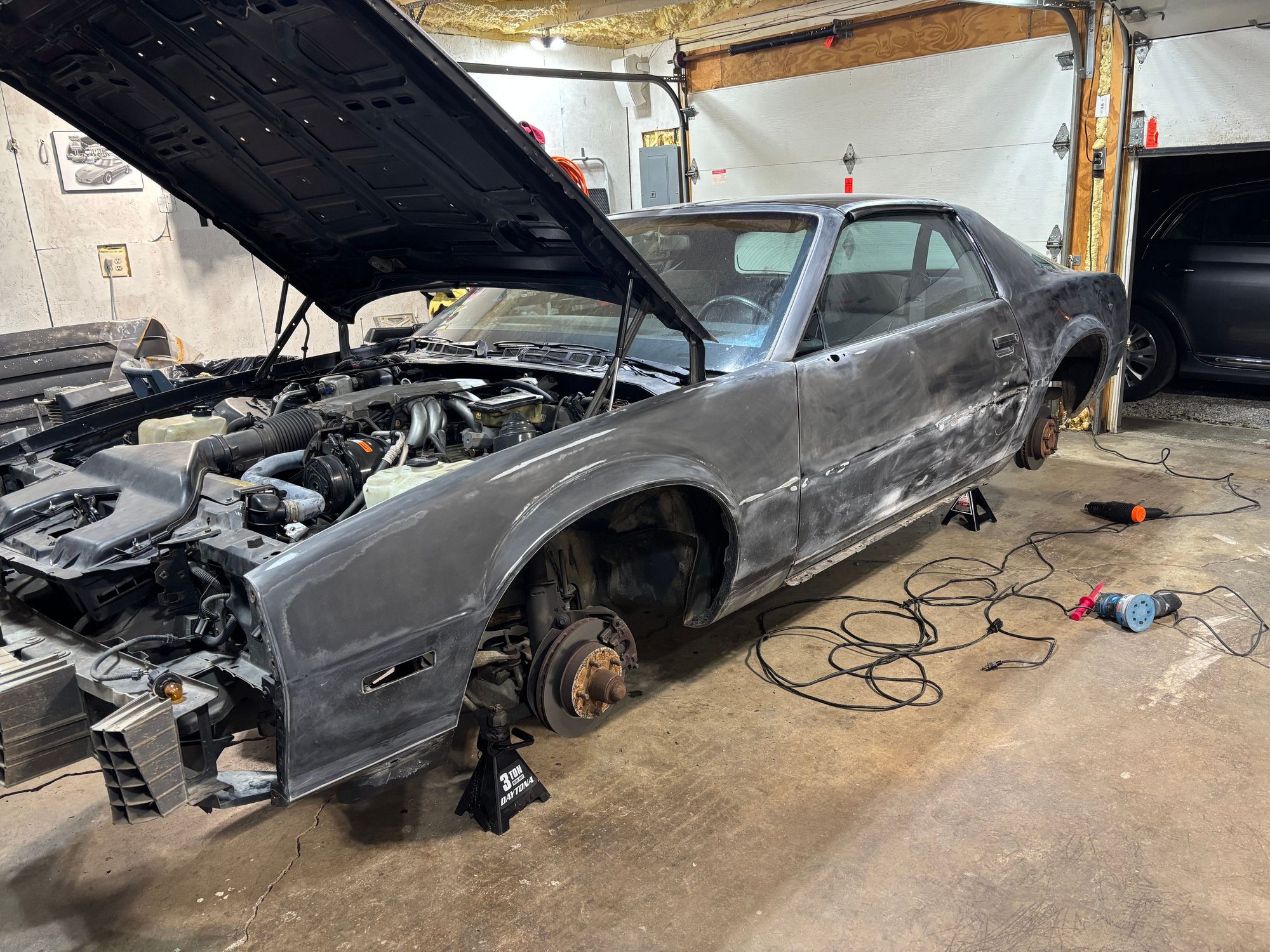

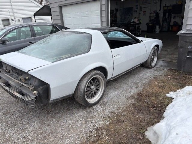

Not that I have my wife's master bath project done, I can get back to the car. Got the wheels off, need to get the tires swapped over to the old set of 91/92 wheels i grabbed for $100. Will be taking the Iroc wheels down to LKQ for refinishing next week. Will be starting to sand on the car this weekend!

I'm not a paint and body guy, but I'd suggest doing whatever possible to repair and retain the door. That's the door (jamb) with the GM decals, by which future judgements will be made about the car. At most, replace the skin, if possible, but not the whole door. With a pro doing the body work, I'd think he's probably capable of saving the door.
The decals can be reproduced https://www.ecsvin.com/
They need to be ordered through a licensed body shop though. Hopefully the OP's friend can help with that part.
I agree. My guy says he can fix the door and I've had him do enough work that I trust what he is telling me.

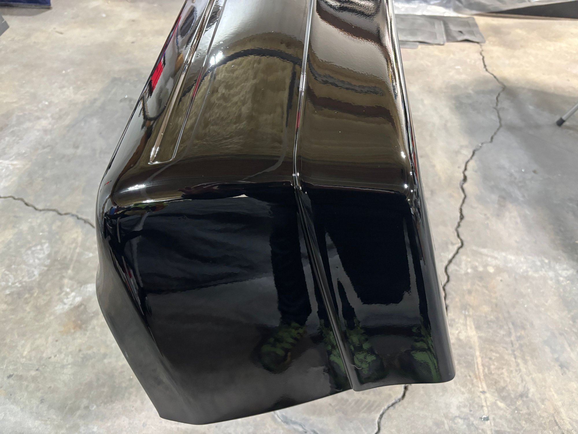

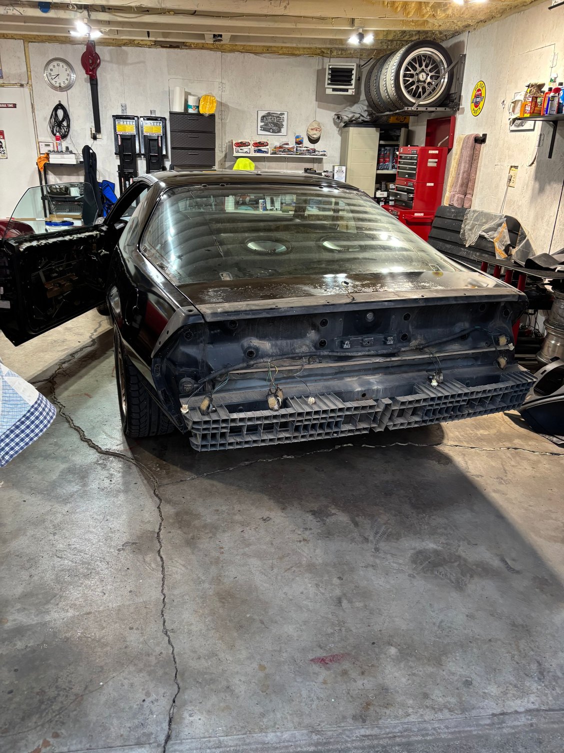

What is the saying….”slow and steady wins the race”…. Also dropped the wheels off at LKQ early this week. Hope to have them back next week....

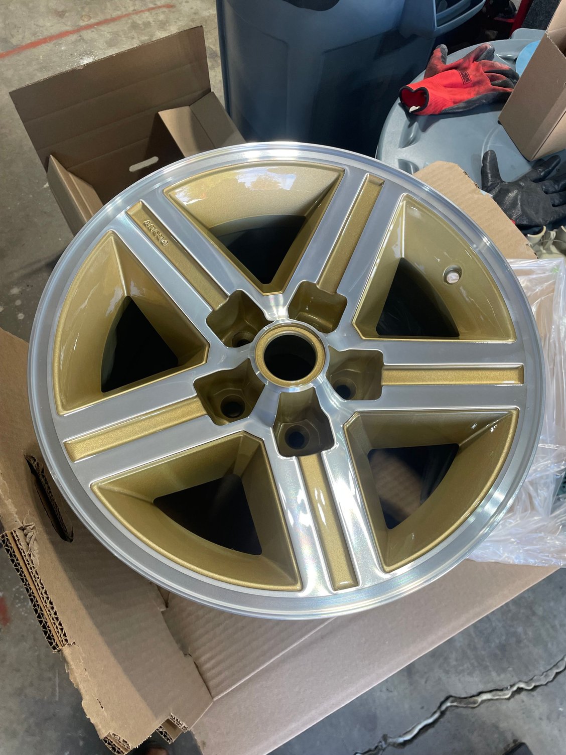

Got the wheels back today, they turned out nice. Fortunate to have a place less than an hour away that does them so I don't have to pay shipping....

Those look great. Did they machine the faces as well?

Thanks. Yes, they did machine them.. If anyone in NE Indiana is curious, they were $160 each to get done. Turn around time was about 2 weeks. The place is in Warren, IN, just south of Ft Wayne.

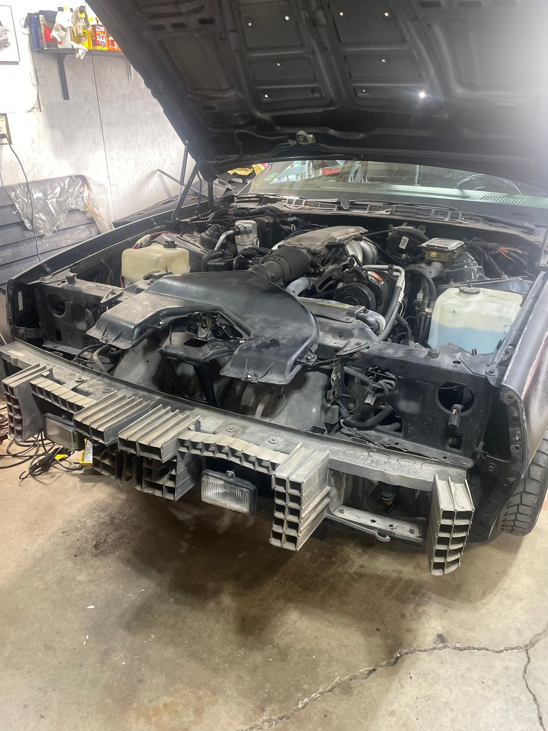

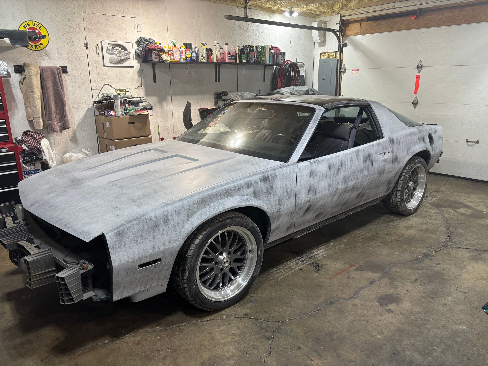

Car is now in primer with guide cote on.
do yourself a favor and get some junk rollers for your car during the paint process.
otherwise they WILL get overspray on them. it is inevitable..
Old Feb 15, 2026 | 12:16 PM
IROCIN's Avatar
Joined: Oct 2018
Posts: 285
Likes: 221
From: Ft Wayne, IN
Car: Irocs 87 Conv 5 spd & 87 T-Top auto
Engine: LB9/L98
Transmission: MM5/Auto
Re: Lets see how this goes....1987 5.7 Paint
Thanks, I do have a set of other wheels, but I think I am going to put the car on jack stands when I paint it, so the wheels will be off.
Old Feb 17, 2026 | 03:35 PM
IROCIN's Avatar
Joined: Oct 2018
Posts: 285
Likes: 221
From: Ft Wayne, IN
Engine: LB9/L98

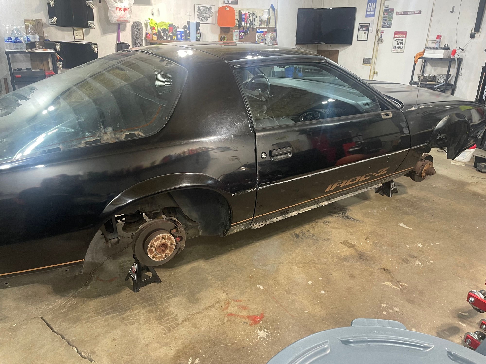

With the almost 60 degree temp today in Indiana, I took the opportunity to pull the car outside and start sanding to save the mess in the garage.

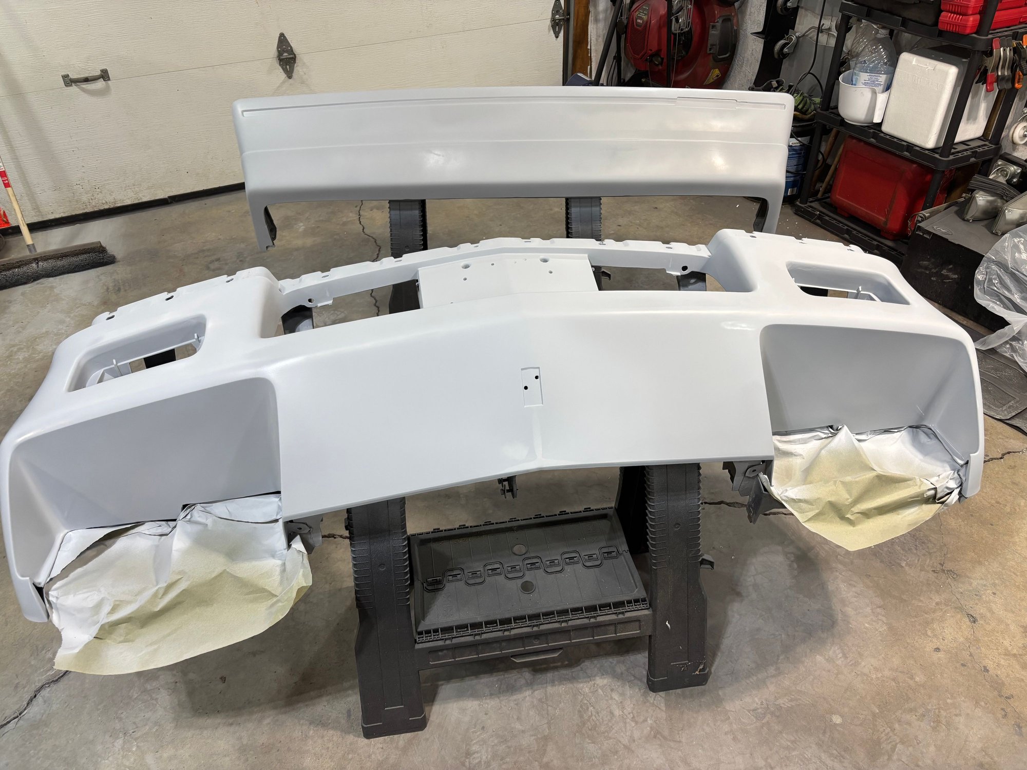

Old Feb 21, 2026 | 03:26 PM
  #42
IROCIN's Avatar
Joined: Oct 2018
Posts: 285
Likes: 221
From: Ft Wayne, IN
Engine: LB9/L98
Front facia and bumper primed today.

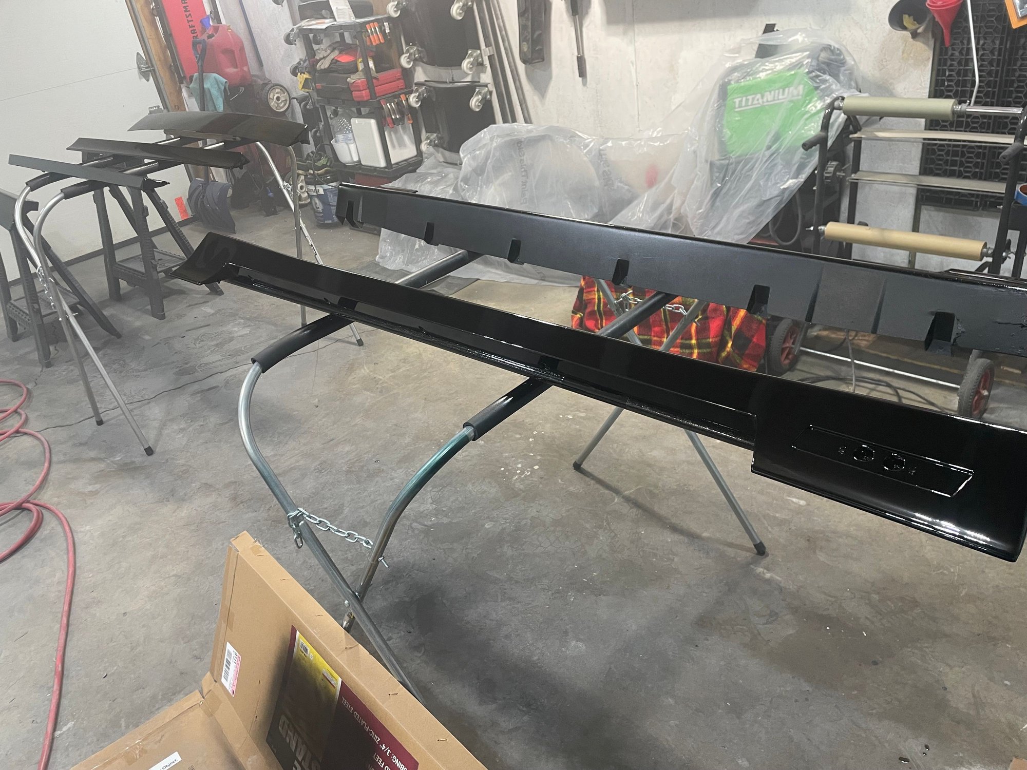

Got some of the ground effects painted today. Will probably do the front/rear bumpers next weekend. Have one run I have to deal with, but overall they look good.
Do the GFX and bumpers need to have additive added to them for flex?
What brand primer, paint and gun are you using?
Old Feb 23, 2026 | 09:41 AM
  #47
bk2life's Avatar
Veteran: Army
Joined: Jul 2016
Posts: 802
Likes: 213
From: az
Car: 91 WS6 GTA
Engine: 5.3
Transmission: 4l60e
back in 1982 yes. Today, no.
Old Feb 23, 2026 | 09:56 AM
  #48
IROCIN's Avatar
Joined: Oct 2018
Posts: 285
Likes: 221
From: Ft Wayne, IN
Engine: LB9/L98
Not using any flex agent. Products are:
Primer/Paint - Shopline Products
Clearcoat/Activator - Transtar Products
Guns - I am using an Inokraft D1 LVLP gun off Amazon. 1.7 tip for primer and 1.3 tip for paint/clear. I also have a black widow HTE gun from Harbor Freight, but prefer using the Inokraft. Both are fairly inexpensive.
Old Feb 27, 2026 | 05:49 PM
  #49
IROCIN's Avatar
Joined: Oct 2018
Posts: 285
Likes: 221
From: Ft Wayne, IN
Engine: LB9/L98

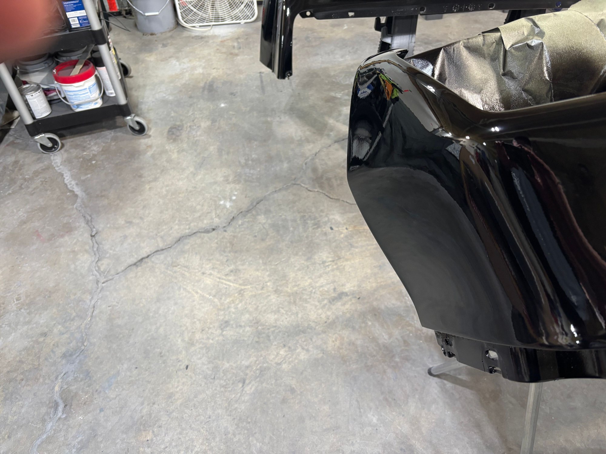

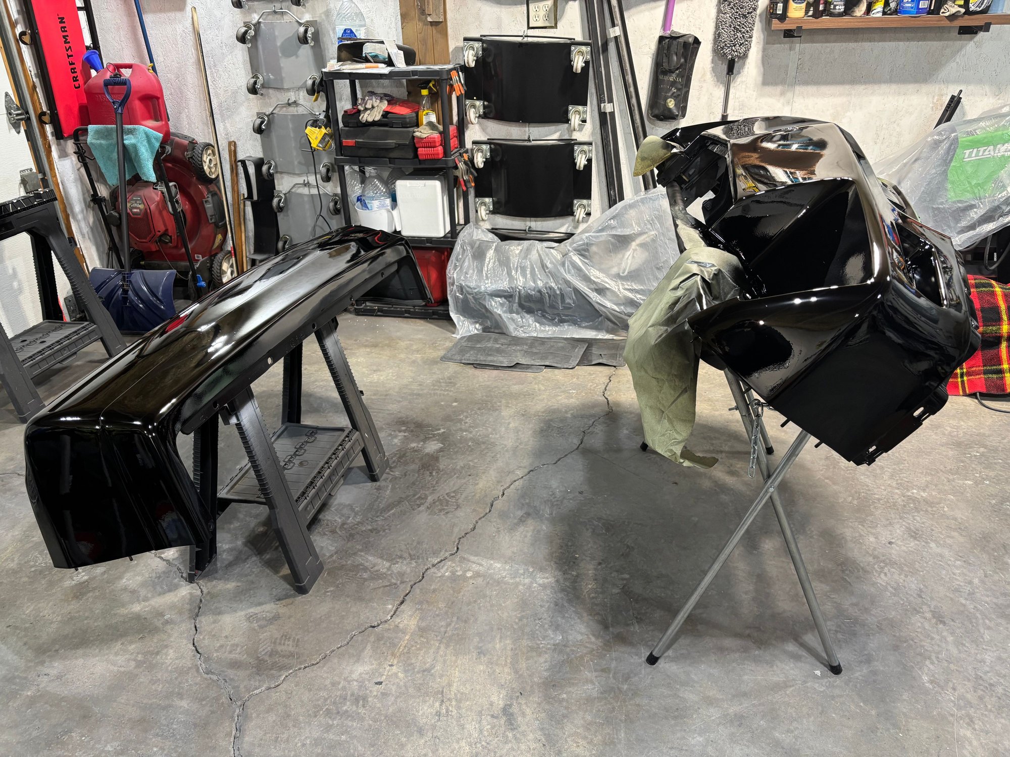

Got the front facia and rear bumper knocked out this evening. Turned out pretty good. Of course, had a spider land in my last coat of clear…😡
