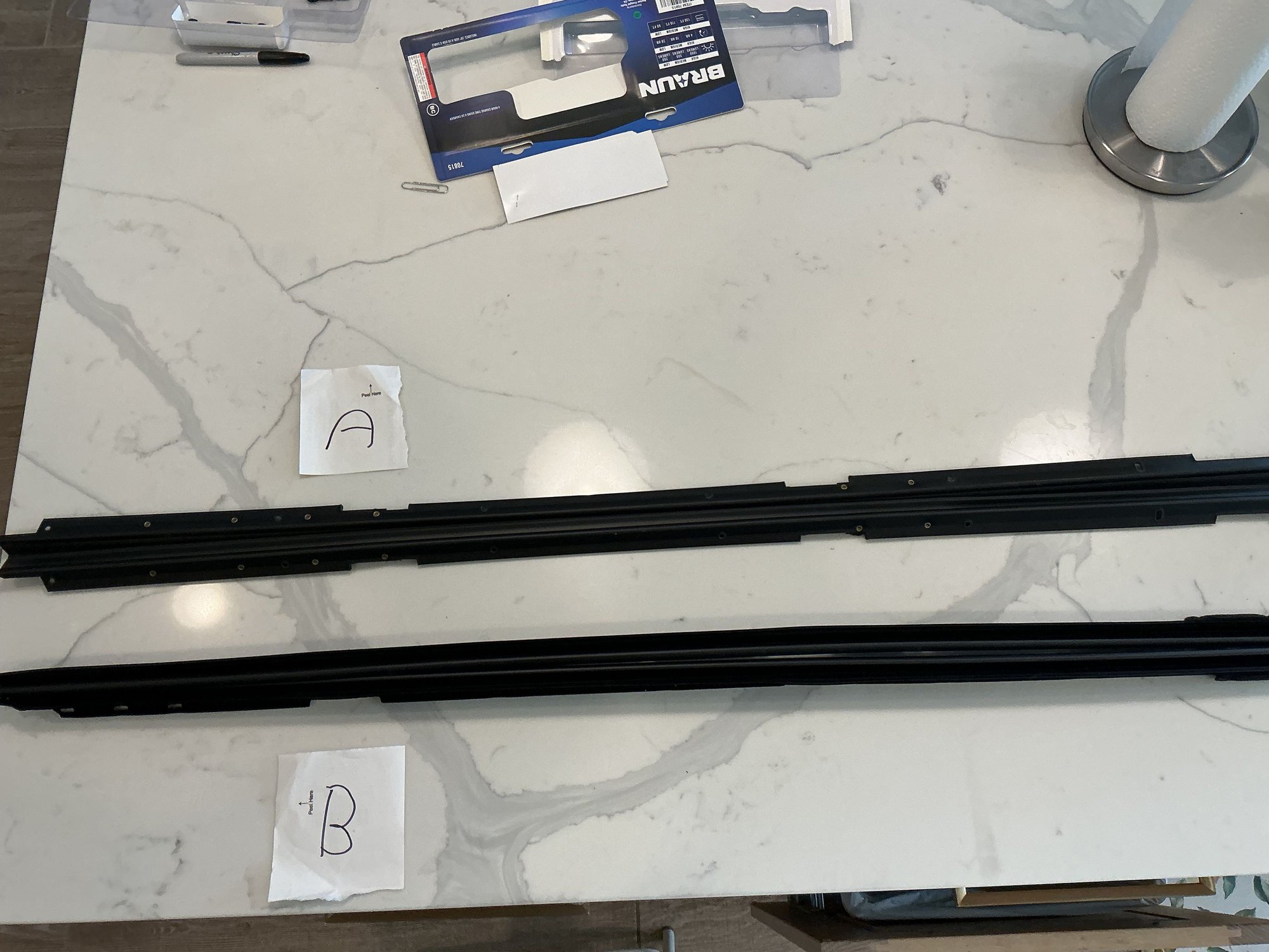

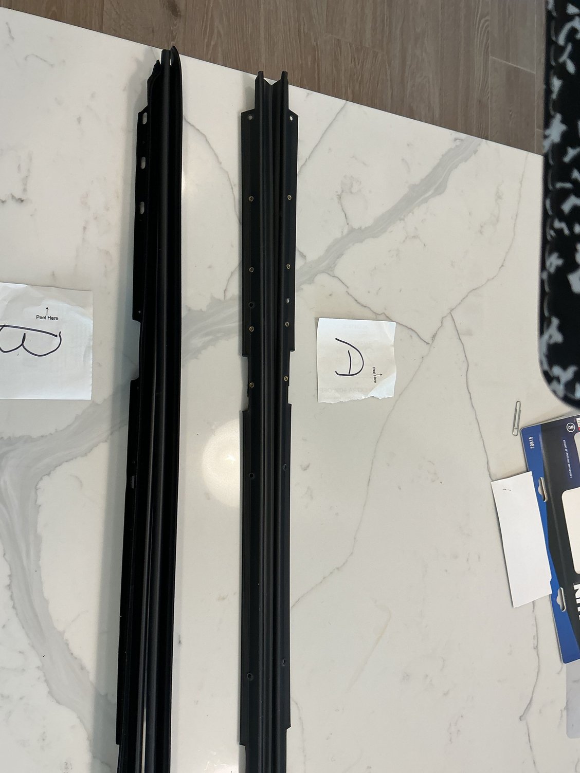

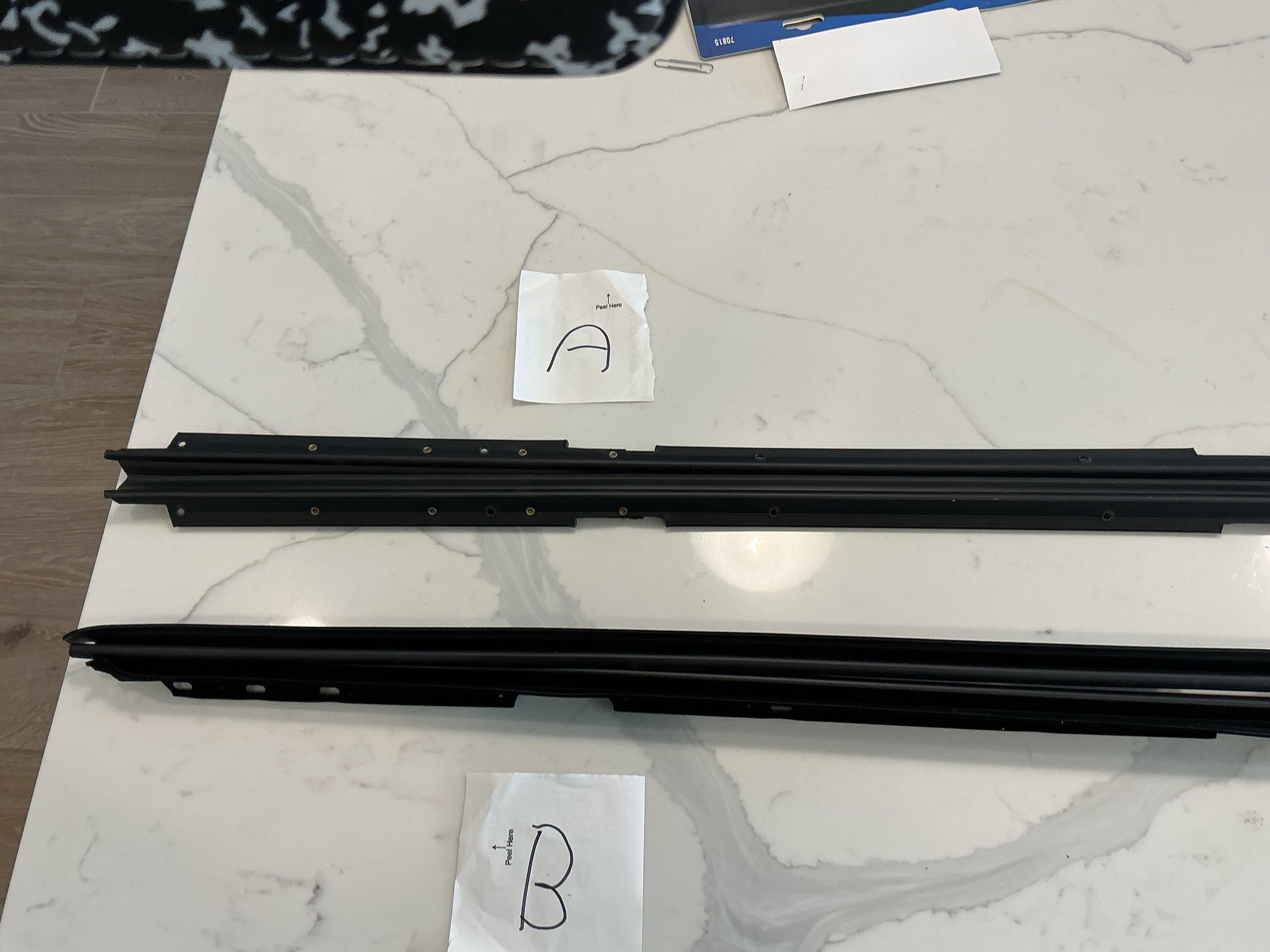

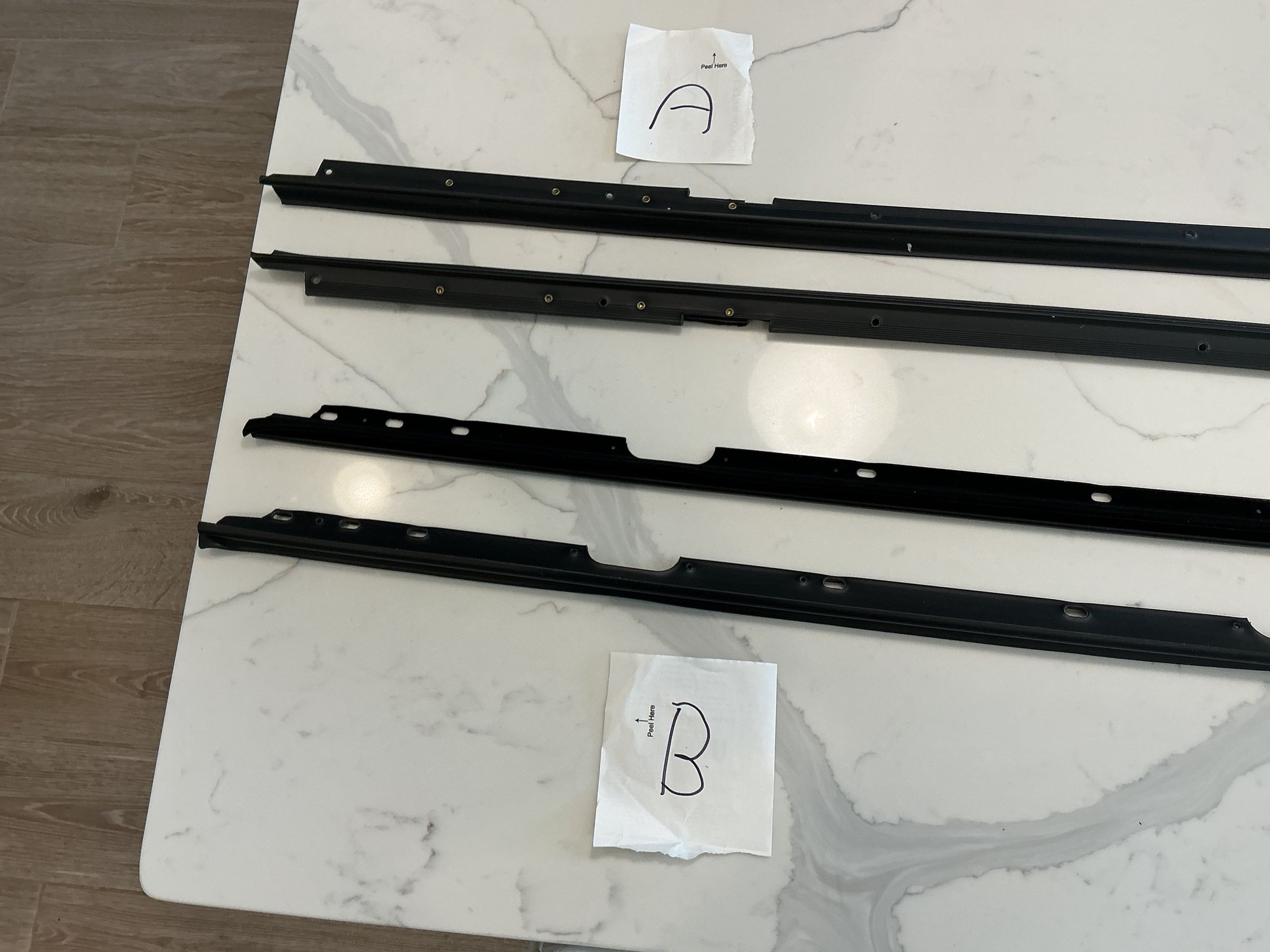

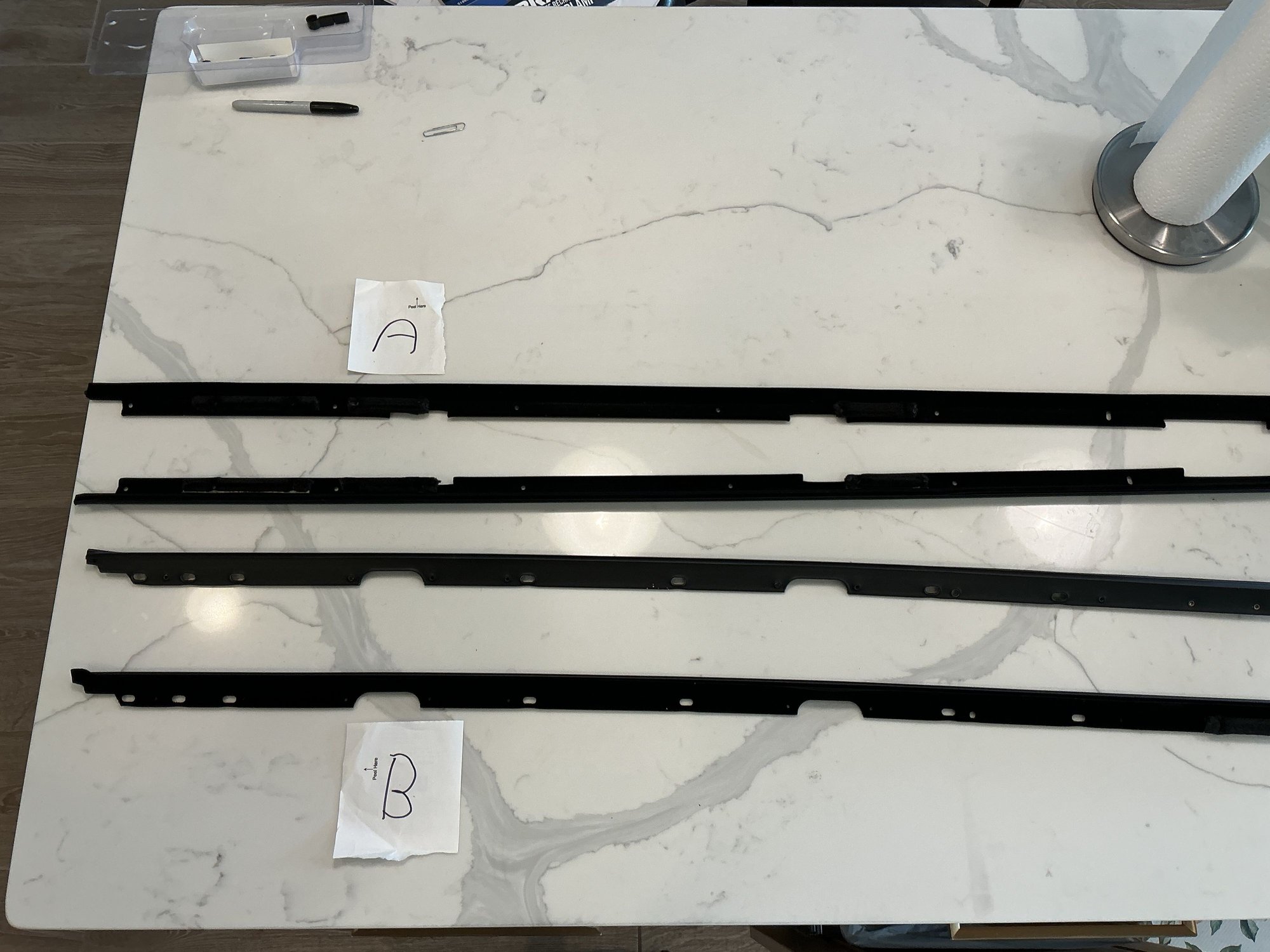

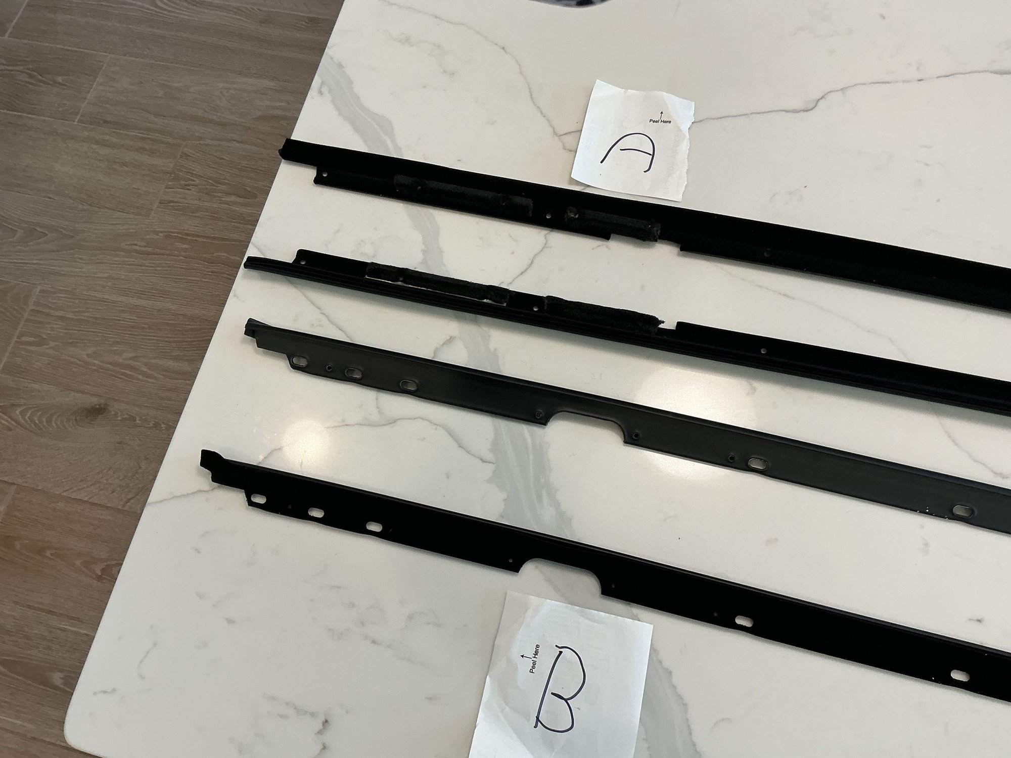

Need HELP NEW WINDOW SWEEPS which is inner and outer? Pictures attached

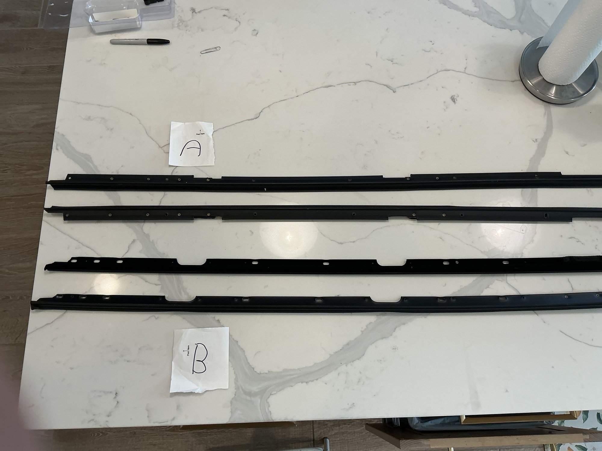

Hi . For my 1989 IROC Z VERT, I bought new window sweeps (Classic Industries IIRC).
I took the car apart a year ago, Before I waste an hour, which is in / out of?
THANK YOU VERY MUCH!

Re: Need HELP NEW WINDOW SWEEPS which is inner and outer? Pictures attached
A is OUT
B is INNER
"For the next guy"
Thanks anyway, Mike C
The ones with the rivets is outer.
MY 1989 Camaro had screws attaching the OUTER sweeps. The old INNER sweeps appear to have had plastic rivets at one time, now replace with screws. I will try to find 1/8 Diameter plastic rivets and likely add some adhesive.
What say youse?

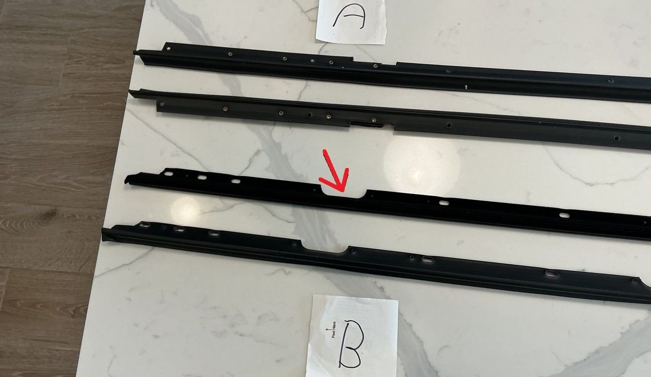

Screws on the outer, rivets on the inner. Your correct, B=outer, A=inner. The giveaway is the U(arrow). Thats for the adjuster at the top of the door frame
Yep, just checked mine. Screws on outer. Thanks.
