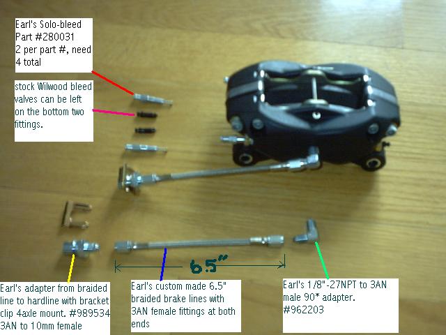

Everything will basically bolt right in ecsept the brake lines and parking brake cables.
I have Wilwoods for a 10 bolt on the Camaro, yet I am also very familiar with a 9" as well. I have a Currie 9" on a Chev truck of mine with rear disc brakes (SVO calipers and Lincoln rotors).
Here;'s a basic layout for braided lines and fittings that will work regardless of a 10bolt or 9".

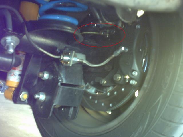

Finished look of brake lines installed, And the Clevis e-brake fitting needed for parking brake calbes. I used Lokar universal steelbraided parking cables.

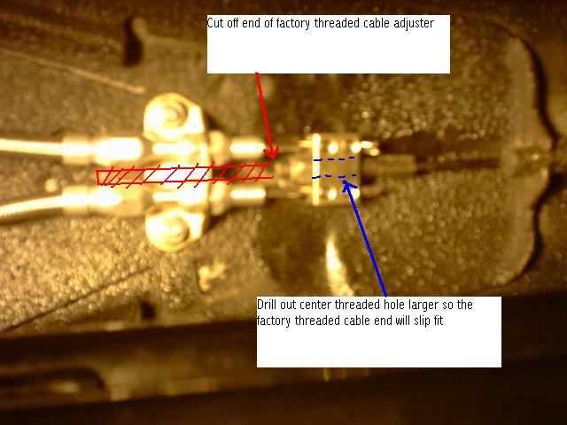

How I attached the Lokar lines to the factory adjuster above the driveshaft.
