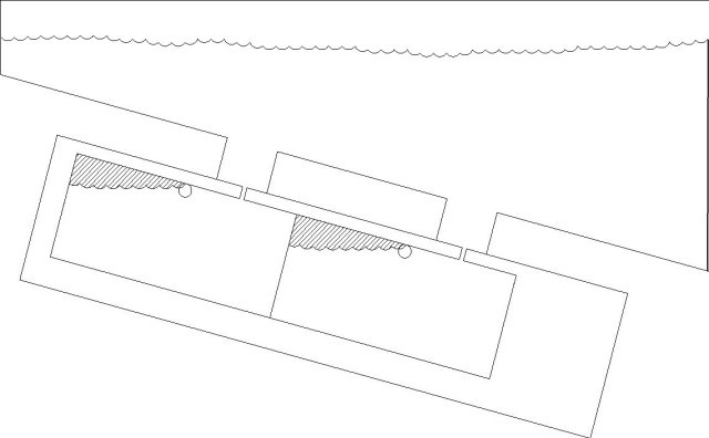

Here's a side view of your master cyl.... the little circles are the holes where the lines hook up.... as you can plainly see, the shaded area is above the line fittings, and will trap air, and NEVER bleed as long as the cyl is on the car. You simply have to get it level. If you do it on the car, you can raise the rear as high as conveniently possible by whatever means, unbolt the cyl and the PV, bend the lines over a little to where it's sitting level, and just kind of gently diddle the piston in and out while tilting it very slightly first one way and then another; and you'll get the air to come out into the reservoir through the little fill hole.

Tilting which ways exactly? I basically backed my car up my driveway and let it sit facing down, jacked the rear end up as high as I could get it with stands, and unbolted the MC from the PV and pumped the piston in and out quite a few times. I didn't see any air bubbles at all so I didn't know if I had done it right. I did make sure to get the MC "level" or as close to it as possible without kinking the lines from bending it too far, basically what you outlined in my first post about the brakes. I guess I'll give it another shot and see what happens. Should I be pumping the piston in and out all the way, or just "diddle" it like you said, move it in and out just a little? Will I feel a pressure build up once the air starts coming out?
