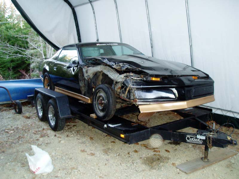

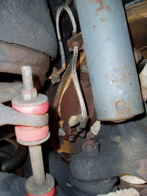

I did lose my '84 T/A to a Russell hose failure up front. The line ruptured at one of their factory crimps. In retrospect I should have at least tried to go after the company, but it was WELL outside their amazingly wonderful 90 day warrantee. Imagine that...DOT approved and a 90 day warrantee!

(Couple pics of the '84/failed hose):
--You can see the frayed braid where it ruptured, just above the bracket on the strut--
I have Earl's on all 4 corners of my '92 because I haven't heard bad things about them. I hope this is just a fluke thing because I'm not interested in losing my brakes ever again. I know it's not fun, but be thankful you lost your hose in a parking lot, not 1/2 way across a bridge with a red light at the other end
Still definitely sorry to hear of your troubles though!
-Paul

Ok, looking at the posts all I can share is my input.. the lines that came with my baer brakes were braided and held up well under hard driving conditions for 25 thousand miles..
This set (the second on this car) had no impact, were not rubbing in any way, and were not installed improperly, there were also not subjected to any ham-fistedness. They also had only twenty miles if that.. they are still very shiny and new with not even a single stainless braid out of place.
still waiting on the word on these, but it is the holidays.. so for me the failure rate is 50% for braided sets, or 1 in 8 when looking at individual lines. I know that the common thought with an uncommon failure is installation error, looking at my car and posts I would hope you all know that is not the case here.
Do I still run them, yes. BUT I find the lapse in quality control to be alarming and depressing. Understand that this can happen, I would expect a failure like this (from construction) to occur early which is why I suggested trying out brakes early and hard with lots of runout.. as mentioned above TEST, TEST, TEST..
I would encourage you all to look at the pics closely and wait to see what Earls tells me before we have a collective freak out. I expect that I will get a nice set of shiny new lines and they will look at whatever machinery made the line I sent them.

Well here is the verdict. They are sending me new lines.
If you look at the first pic I posted of the broken line you will see a small brown mark. They are saying that is a witness mark from something in the suspension hitting the line causing it to break. But are giving me the "benefit fo the doubt".
The fact is that the line was well clear of any suspension parts, on a straight axle, attached to the axles by stock brackets. Last I checked there is no suspension part close to the caliper to hit it, and very little room for it to wiggle. The "mark" could of been caused when removing the line, or any other time but seems pretty darn small, and I don't remember it at all. So that is it, more questions for me than answers, their explanation is not acceptable to me but oh well.. the only concession was that he did mention that it looked like the die that made the part was slightly worn.
