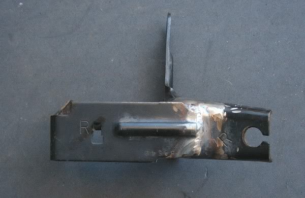

The LS1 cables are longer than the stock early cables . I just made up a bracket that I welded up in the tunnel to mount the cables . The worst part on my 91 was the goofy self adjuster on the e-brake handle .It took a while to figure it out but it works OK now . Well the worst part is you have to pull the whole interior so you can weld the bracket in the tunnel and not catch the car on fire .

My solution... The first go around for this was bolted through the floor. I didnt like that, I so welded it this time. Just used the holes I drilled for the bolts and plug welded it. Should work the same... and it worked great before.
Did the same thing alloy suggested. Stole this piece off the 4th gen. Just didnt use the whole bracket. Im also using the 4th gen ebrake handle.
Using the stock 4th gen e-brake cables. Works 100%...very well...VERY easy....VERY cheap.
J.

I'm glad to hear my idea is a sound one. I figured if I went with everything 4th gen it should work.
Did the 4th gen parking brake lever bolt up without mods?

alloy: The 4th gen brake lever bolts right in. NO mods needed for it. Im running a 4th gen console....but that shouldnt matter. The little rubber piece that insulates the cable as it goes through the floor fits in, but doesnt bolt in like the stock 3rd gen one. Still works fine.
I didnt run the entire 4th gen bracket....but Im not sure. I think it was because I just didnt feel like cutting more parts off the 3rd gen.either way should work fine. I just measured the distance between the single cable hole and the two rearward cable holes on the 4th gen, and matched it. Seems to work fine for me. Cables have enough adjustment in them to mess around with it.
Timothayyy: Using the LS1 brake cables and doing the bracket up like alloy and I are referring to will get your ebrake working. You dont want to park a manual transmission car with it in neutral and only the parking brake holding it... If the brake slips or fails, whats to keep the car from rolling? I always leave my car in 1st or reverse depending how Im parked with the e-brake yanked.
For the brake lines...I cant really remember 100%. But Im using a 4th gen 12bolt. So I didnt change anything from when I pulled it. However, Ive done several 8.8 and D44 swaps into jeeps that started out as drum rears, and made them disc. Its not hard to find some hoses at autozone that will work, and usually have little tabs with mounting holes that you can get creative with. If you have a friend that can weld, then the possibilities are endless for mounting lines. Just have him weld tabs where you want to mount things.
Sometimes simple is better though. I went as simple as possible...and it worked great.

I'm assuming you are referring to lower control arm relocation brackets. They slip over the lower control arm mount on the axle housing and the stock brake caliper cable brackets aren't wide enough to slip over them after the relocation brackets are installed. I have relocation brackets and the easiest way to solve the problem is to cut or grind (carefully) and separate the two bracket parts and space them out and re-weld them together. Sounds much harder than it really was. Probably took me 10 minutes to separate the brackets, bolted them to the housing over the relocation brackets and welded them up. They fit perfectly now.
Here's what mine looks like after modifying them.
The front cable bracket is spot welded to the floor pan. I cut around it with aviation snips and then came home and drilled out the spot welds. I ended up with what you see in my earlier post.

I just cut the bracket at the factory weld and used the outside part with the ebrake attachment.

My bracket/approach is 100% safe. Unless the welds fail...which would be quite surprising with as many and as good as they were. And its 100% RIGHT. Because it works and functions EXACTLY as it does in a 98-02 F-body.
The only thing you need to change is the e-brake handle itself. And since I had a 4th gen console, using the 4th gen handle made sense. Although...in looking at the two, Im sure the thirdgen part can be made to work as well. So Im not even sure that you HAVE to swap the handle out. I would much rather modify the handle assembly or cable than have to worry about sourcing or getting custom rear cables. You just have to have the motivation to get a 4th gen bracket, and then its just a matter of snipping your 3rdgen one, and welding her up. In fact...I didnt weld it the first time. I used 6, 1/2" Grade 8 nuts, bolts and large washers through the floor. That worked well, but decided to weld it for a cleaner look and no holes in the floor.
I went the same route as alloy with the rear lines to rear soft line. I cant remember what the part number for my hose is off the top of my head, but it works very well. I had to cut and re-flare the one side of the LS1 stock lines..maybe the other side to get standard nuts on it...but thats it. Of course, I replaced ALL of my steel lines on the car when I did my swap..so maybe thats why it worked out so easy for me. Who knows.
My rear lines just for the heck of it...
Lots of room for axle droop when on a lift or whatever.
Modified stock bracket to accept the new hose.
Working great for a couple years. No leaks, very simple, easily obtainable parts if I need to replace something.

I agree nothing either you or I did was a hack job. Cutting and welding the brake cable bracket to fit over the relocation brackets exactly like the stock ones, giving it support on both sides is the correct way to do it. I'd like to see how much the bracket on the UMI car flexes when the e-brake is applied. At the very least they should have drilled a hole in the bracket where the tab is and bolted it to the back of the LCA bracket to give it some stability. And I also don't consider re-flaring the lines hacking.

If it's strong enough without the bracket going around to pick up the other side of the bolt, then why did GM spend the extra money to have the bracket built that way? As ghettocruiser said, with it cut and rewelded it functions exactly like it was meant to on the original vehicle it was on. I trust GM's design over UMI's quick solution any day. Just because they are "UMI" doesn't mean what they did was the right way to do it.
And...........I guess I don't understand what the big deal is about cutting and re-welding the brackets. Takes 10 minutes each to do it the right way. And again, it's like ghettocruiser said, you just have to have the motivation to do it the right way.

J.
No no welding involved all I did to modify a set of cables from a 98 to work in my car was cut away some of the jacketing to increase the amount of cable exposed to be the same as that of a 3rd gen. The entire project including adjusting the ebrake took about 4 hours. But most of it was figuring out where to make the cut. I did it that way cause I would rather cut up easily available stock replacement stuff then modify my chassis
Joined: Sep 2002
Posts: 3,685
From: PA
Car: 86 Trans AM
Engine: LS1 (not stock...)
Transmission: Built T56
Axle/Gears: Strange 12-bolt w/ 3.73
Re: LS1 e-brake Question
Sorry man...now that I look at your post I noticed that you have the first half of the "quote" command but not the second part. So it looks like you were the original person saying that...
I know what you are talking about when you say modify the cable sheath. I thought about doing that as well. My car is so modified at this point that welding something else onto my chassis didnt bother me in the least. If for some insane reason I ever wanted to put the car back to stock...hahaha...sorry just read that outloud....I could easily modify whats there to use stock 3rd gen cables again. But...I see no reason why I would ever go back to a 3rd gen rear or 3rd gen drums. So why not make it permanent.
I performed the "sheath mod" on a few jeeps that I did axle swaps in. Usually in a cherokee when Ide swap in a Ford 8.8. But I ended up revising my plan for that as well so that I could use off the shelf cables. More than one way to skin a fish thats for sure.
J.
J.
