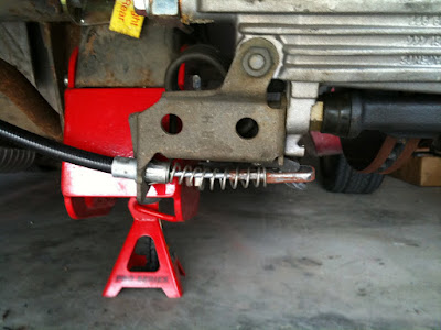

I'm finally getting around to being able to test out the new rear brakes Ed sent me a year ago with my new engine (LS1/4L60e). I went to try the parking brake...and it's sorely lacking.
Before I swapped, the parking brake did not work as it should have. The car had set up for a year or two - and the adjuster in the tunnel was as tight as it could go (no slack left)...and it still wouldn't hold the car (barely moved, but enough to fail me!). So - I bought the PBR upgrade kit from ebMiller and also started my engine swap.
Engine is running now. The parking brake is still just as bad as it was before it seems. We've tightened the adjustment bolt in the tunnel as far as it will go, tightened the free travel screws on the rear calipers (which seemed to help a little, but I wouldn't figure I'd need to do this with new brakes like these), and bled the entire system with new fluid coming out each bleeder.
We put the car on jackstands, removed the rear wheels, and did the above adjustments. Using the regular brake pedal, we can stop the rotors from turning for a couple seconds - then they seem to slip and the rotor begins turning. Applying the brake, then the parking brake and letting off the brake just lets the rotor turn (albeit slightly slowed). Lastly, pulling the parking brake while the rotor is turning with no brake applied somewhat slows the rotor but does not stop it.
I'm more than a bit dismayed at the situation...moreso because I've spent alot of $$$ on this car since starting the brake swap a year ago (engine swap, etc.) and can't even get it inspected to drive it anywhere.
The only thing I can think of is that the parking brake cables I recieved with the kit were too long...but that doesn't answer why the rotor doesn't stop with the normal brake.
Is there something I'm missing here? What more affects the parking brake than the level, cables, caliper, and brake pad? Please help.
I'm desperate here folks...I've got an LS1 swapped thirdgen and can't drive it on the road due to a parking brake.

I got the AC Delco parking brake lines (which i like better than the raybestos) from Rockauto. I measured them against the Raybestos and there was about 1/2 inch difference in the amount of cable outside the hard plastic sheath. I thought maybe this would make the difference.
The slightly shorter cables helped in the trans tunnel where I didn't have to adjust as far. However, I do not believe they helped my parking brake situation at all.
Basically what you've got is the lever inside the car and the amount of lever travel at each caliper. I achieved the same amount of lever travel by adjusting the trans tunnel piece and the free-travel screws on the calipers on BOTH sets of parking brake cables. And I believe the amount of lever travel I'm achieving is a fantastic amount...
But the parking brake still doesn't work. I've got an engine swap (ls1) and a non-accurate tach - so I'm leading toward a high idle causing the parking brake to not hold. Here's the theory:
Engine idles high enough to cause the stall to fully engage (it's a stock stall, not sure the rpm). This applies the same amount of pressure to the rear wheels as you goosing the throttle when the parking brake is applied. Obviously the car will move and then come to a quick stop. This, I believe, is the best these cars will ever achieve. Sad, but true.
My next step is to get with my tuner next weekend to adjust the idle speed as low as I can take it and see if it helps. If my parking brake does not work after that adjustment, my car is for sale. I'm going to lose alot of $$$, and way more time, but I just can't see keeping a car I can't drive legally.
I'll post up more when I get with my tuner. If you're in the Texas area and have a legitimate offer on an ls1-swapped GTA with too much to list, PM me.

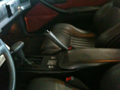

If you're getting al ot of travel I would assume your cables are too loose still. You should be able to mechanically feel the pressure you're applying on the brakes.
That right there is enough to keep the car from moving around and I've got to tug fairly hard on it to get it that far and I'm a pretty big guy. I have the old style e-brake handle that I bought specifically for my 89 PBR calipers and I had to adjust them to fit but it was easy as pie. It was just a matter of getting the correct handle.

My handle travel is good. I was referring to the lever travel on the caliper. I've got an original 87 parking brake lever, the adjuster in the trans, and a set of 1990 correct-length AC Delco parking brake cables. These hook to some of Ed's PBR calipers. On those calipers, I'm pulling the lever nearly all the way back to the cable mount.
I'm hopeful adjusting my idle down will fix the problem. I'm not sure if I could bring myself to tear this car down and sell everything for...the parking brake.

Got the car back from the shop today - they couldn't figure it out either. I went and took a bunch of pictures to show what is going on thinking one of you could chime in/check yours and maybe we'll make some progress. What I found the most intersting is that the little pin that is pushed in by the parking brake lever on the caliper isn't really being pushed in - it's being pushed over (and not pushing in both sides). The pictures will explain better than I can.
The full album is located here. They'll appear in higher res there.
Both sides look to be doing the same thing, so I'll show the right side as the pics came out better.
Parking brake handle travel:
Caliper Lever not pulled:
Caliper lever pulled:
Parking brake not applied - notice caliper lever and pin:
Parking brake applied - notice pin now...at an angle?

One more. This is the left side with the PB applied. I got very minimal additional piston extension. It also looks like the side with the pin is pushed further than the other...
Anybody? All help appreciated.

I'm certain the proble is with the caliper as well. Everything else has been eliminated.
