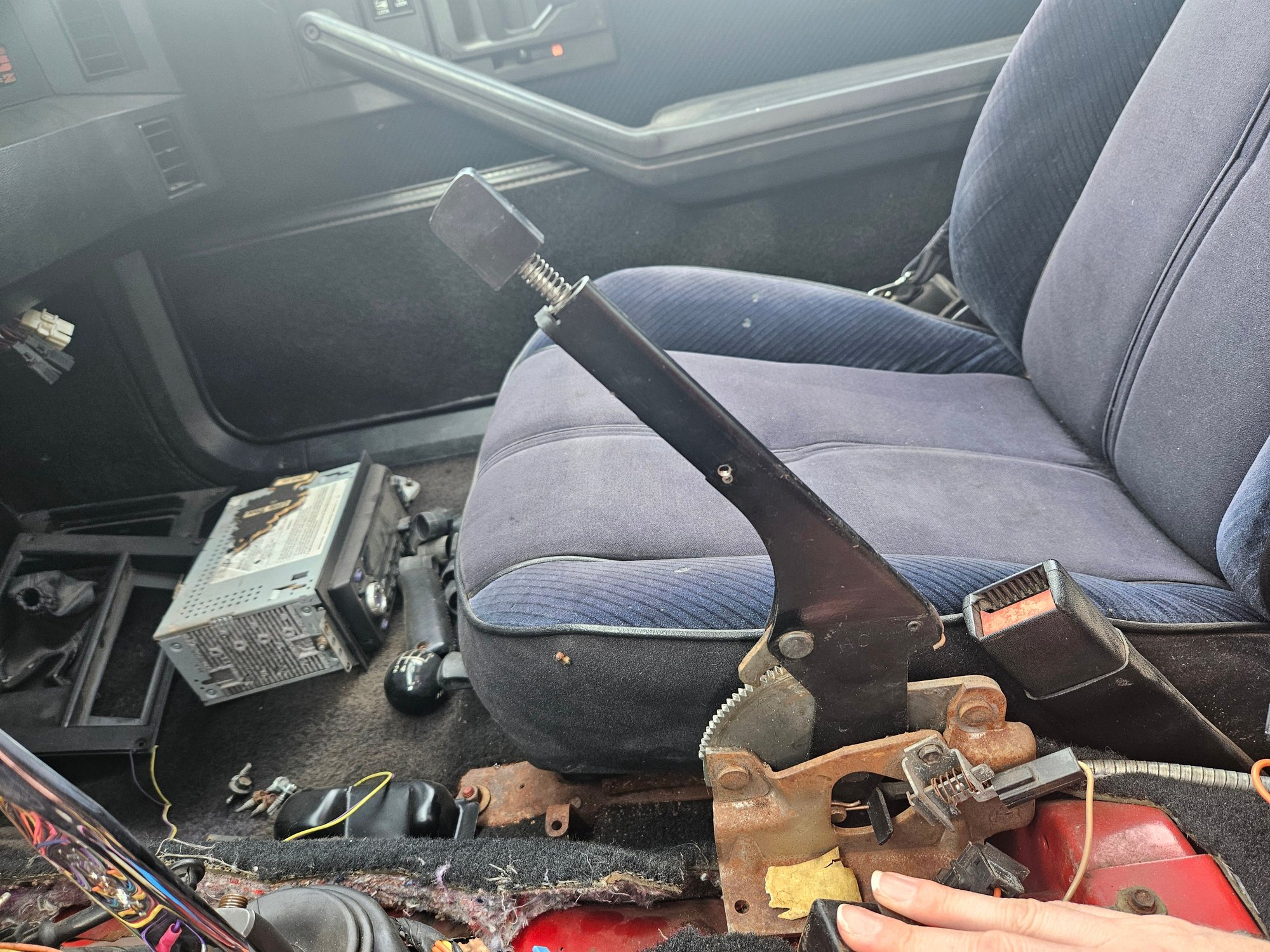

Yeah I must be stupid because I have read the service manual instructions like 20 times, and I still dont understand where or how youre measuring the free travel. I am trying to do this on my new pbr conversion because the e brake cables fit the frame etc but will not hold the rotors still. The springs on the cables themselves are compressed to the max. I cannot pull the ebrake any futher even though the ebrake lever inside is only at maybe a 70 degree angle so it has more to go. Rotors still turn with ease.
E-brake cables are on an 85 iroc, with 9 bolt 3.27 gears originally disk brakes from an 87 gta, with 1990 to 1992 ebrake cables.
Ebrake totally off
Ebrake totally off
Ebrake pulled up as much as it can go
Ebrake pulled up as far as it will go

Ok so one of the calipers the adjustment screw was stuck so bad I bent my 3mm allen key. Had to swap the caliper out for a different one. The 2nd caliper is actually veeyold, I've had it for 18 years sitting in a box from autozone remanufactured pbr caliper.
This one though, started out where the free travel adjustment instructions made sense. It was so tight between the lever and the caliper housing I adjusted it to fit a .026" feeler gauge inbetween them.
I thought great, how I thought it should work according to the instructions, is how it works. Problem is everytime you pull the e-brake, the lever can go futher and futher as far as free travel. Then the free travel gets to a maximum (ebrake no longer stops the rotor) and resets back to the .026" I set (stops the rotor again). It just keeps repeating. This can't be correct. Correct?
The passenger side doesn't do this ratcheting effect and stays at the constant free travel and ebrake always works. Issue over that side is the free travel is way out of spec and the cable is much tighter to begin with so cable travel is very short. But you pull the ebrake lever and it holds the rotor where I cant even move it if I out the tire on and try to turn it.. So I'm like um is it good or is the cable wrong (same part number as the left side for 90-92 camaro z28)? is the caliper also bad (this caliper is 2 months old)?
I have never used these calipers and dont know what good ones should work like.
I can take more pics of the free travel of both sides if youd like.
