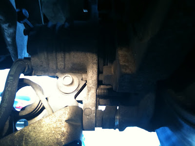

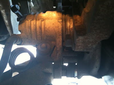

Thanks for the update BADMAN. I went and visited esc's shop today (thanks esc!) and got to look at his working PBR setup. I snapped some photos of his left rear caliper as we worked the parking brake:
Not applied:
Applied:
This shows me that there is definitely something wrong with the pin moving to an angle on my calipers. I'm going to go out and adjust the free-travel out (as we've already tried adjusting it in). I've got a voicemail on Ed's phone...maybe he's got more ideas. I'm hesitant to just buy more calipers as these are brand-spanking new.
What's also interesting about the photos I took of esc's car is that the piston didn't really move outward when the parking brake was applied...

Larry, I noticed in your pics that your lower guide pin boot is off. If you get moisture and/or dirt in there the caliper won't adjust correctly, I'd take a look there too. Make sure the pins are lubed up good.

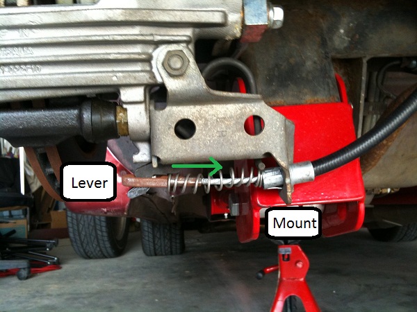

Ed - thanks for chiming in. It seems I'm getting closer, with the pb working when I have the car in reverse. I understand that the pb isn't meant to stop the car while moving, I was just referring to the normal testing method here in tx:
1. Pull parking brake
2. Put car in drive
3. Let off brake
4. If the car moves, you fail.
Thus far, my pb will fail me when the trans is put in drive. If I use reverse, it holds fine. This makes me think it is an issue with the pad, as it is grabbing when going one direction but not as well the other. What could cause this? I'm leaning toward either more free travel adjustment (which I hate, my caliper lever doesn't naturally the gap the instructions describe, and "applying slight force" makes this gap vary enough for the directions to not be very accurate) or uneven pad wear (I've got less than 20 miles on these pads not including pb testing...not likely)
what would your next step be Ed?

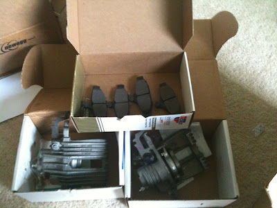

Well - I bit the bullet and bought a new rear set of calipers and the best ceramic pads I could. I know that the problem lies at the caliper and past, so hopefully doing a basic caliper replacement job will eliminate some of the trouble I'm having. If these work, maybe Ed can have pity on me and buy my calipers back to reman...

First thing is to determine if your cables are adjusted properly. Each caliper has a lever that the parking brake cable attaches to. It should be pulled toward the mounting point for the parking brake cable on the caliper.
When the lever is pulled toward the mount, it pushes on a pin that is attached to the bracket that holds the inside brake pad. This pushes the pad out and applies pressure to the rotor. The lever should move enough that the pad is firmly pressed against the rotor and you cannot turn the rotor by hand/with a cheater bar. The length it travels varies.(depending on pad condition and the adjustment in the transmission tunnel/at the cabin lever).
Once caliper lever movement is confirmed, your issue resides either: at the caliper/pad/rotor or at the force being applied to turn the rotor (engine). Before continuing, verify that your engine idle while in gear is normal (my LS1 ends up around 550 rpm, yours may be different).
If the idle checks out, we know the issue is at the rotor/caliper/pad. Free travel adjustment adjusts how parallel the pad is to the rotor. There are instructions linked to previously in this thread that detail how to properly adjust the free travel - follow them. Your calipers may/may not need adjusting.
Hope this helps
