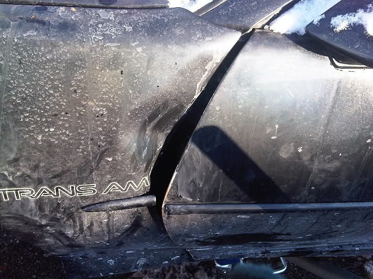

Oh, and one last thing. Here's what happened when I had the driver side on jack stands and attempted to open the door. Evidently, I have a failing door hinge pin. Grrrr.....

failing door pin? if the hinge is even still attached to the car is a friggen miracle from the looks of things. Are you sure its the door pin and not a structural issue with the car?

Yes, I'm positive. Everything was perfectly aligned until I put the car on jack stands and tried to open the door. That's when all hell broke loose.
