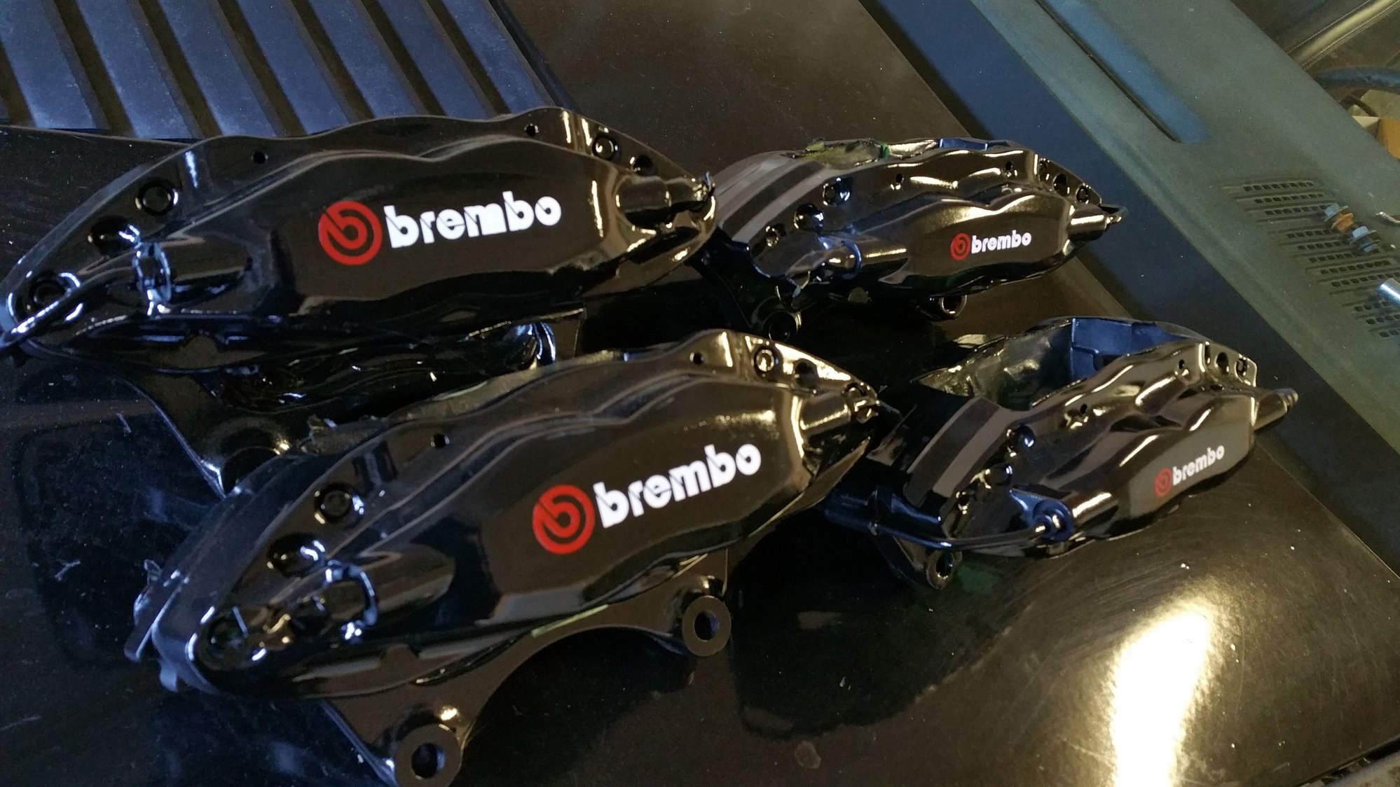

Here are my calipers painted today, going on the car next week! Still not sure what decals to use. Does anyone have a good link to caliper decals or stencils? Help!

looks good, I got my decals of ebay, I just typed in brembo decals, lots to choose from, hope this helps

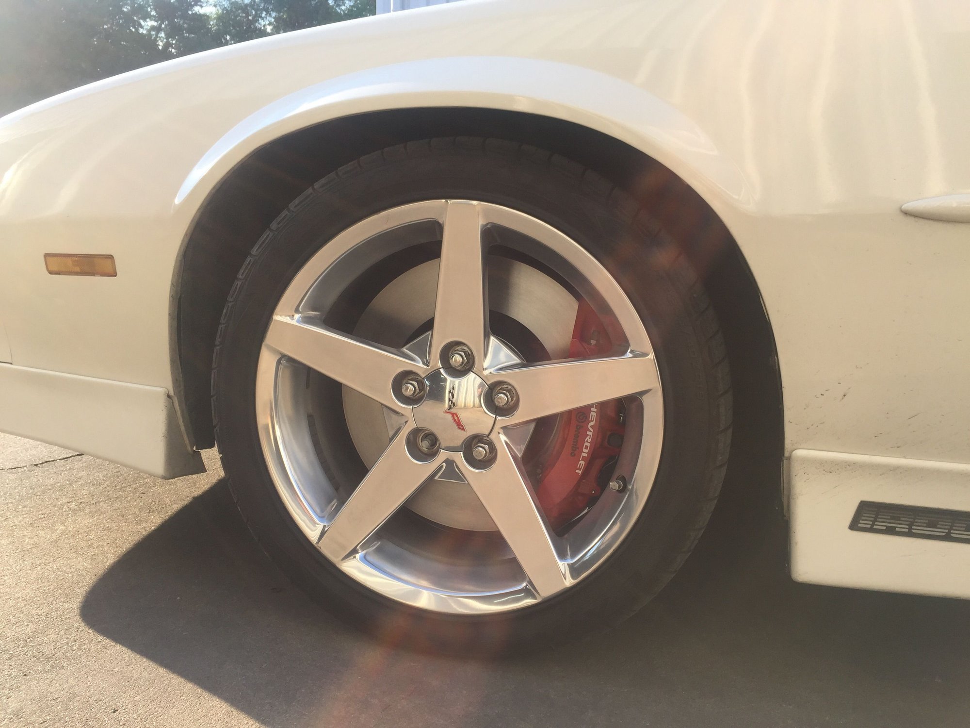

ok guys, got my wheels on! brakes fit great! but I did have to sand a little of my caliper, but just a millimeter or so, but do any of you guys know what to do for a park brake? how about a hydraulic parking brake?? the line lock wont work, I have been told they will burn out, so using a hydraulic brake looks great and should work great,? anyway hears a pic of the car with the wheels on!! reply if you have any info, thanks

nobody on e-brake set up?

I have been working with Scott on my SS Brembo swap as well... I have not ordered the bracket just yet. Mine are going on a 9 bolt. I just need to figure out how to modify the flanges because my 9 bolt has drums. I ordered a custom black and red decal on ebay. The pads and rotors came from Brake Motive. Rather than opening the hat of the rotors, my machine guy is going to turn down the axles and hubs. This way I wont have the fitment issue again.

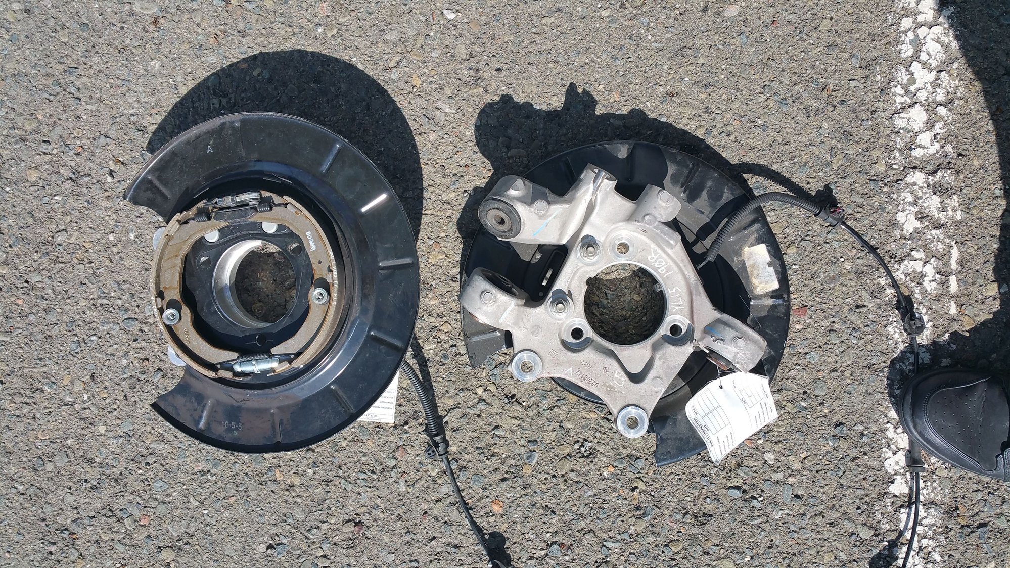

Just got my rear knuckles and backing plates. Now all I need is Scotts bracket and spacer.
