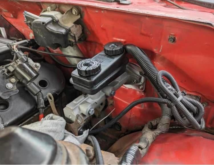

A few more pictures of third gen F-Body manual brake installations from manualbrakes.com
manualbrakes.com
