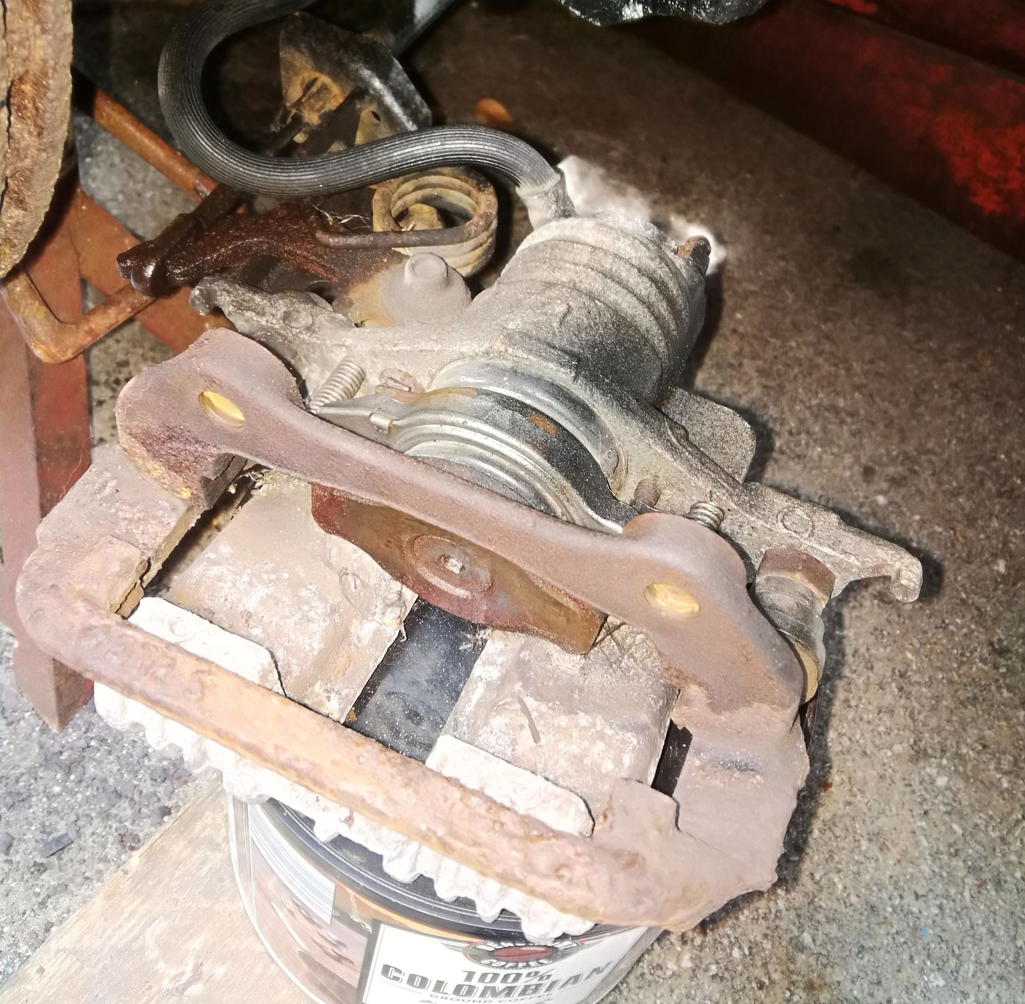

Hello.
I'm doing rear rotors and pads on an '89 Iroc with aluminum single piston calipers. The parking brake mechanism is preventing the piston from sliding back far enough to get the room I need for new pads. Is there a kind of star wheel I'm not seeing I have to release? Thanks

My piston is able to move until it hit that pin coming through the caliber from the parking brake mechanism. I thought that pin had to go back more for space but I managed to wiggle it together.
This is a weird setup with the bunny ears on the pads and the little springs on the piston

Hello. I got it that day, there's precisely enough room to fit the caliper with the new pads on the new rotor if you line everything up perfect without touching the parking brakes.
It's a perfect fit though it takes some wiggling and getting the angle right.
I compressed the piston fine with a C-clamp, the top plate doesn't spin and it works the threads with the clamp the same way the brake fluid would from the other side.
edit for clarity: I compressed the piston back as far as the pin from the parking brake would let me without messing with it. Then I put in the pads, keeping the caliper mount flush with the ends of the pad and that slipped over the rotor, after a lot of wiggling.
I made this thread when I didn't think that could fit over the rotor without getting more space from that pin to compress the piston farther back,
