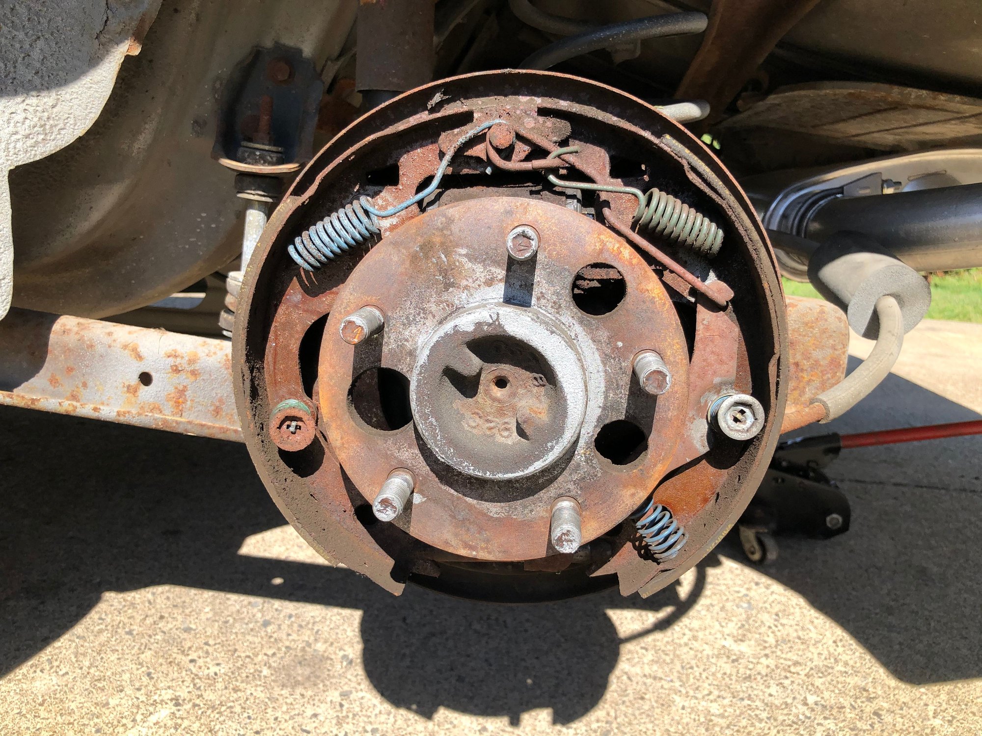

Thanks guys, they were metric - the factory lines had 12mm headed fittings.
What a peach those retaining springs are!
Almost 3 hours for the passenger side, about 25 minutes on the drivers side. I made up a sleeve from an old motorcycle exhaust (couldn’t find a socket that’d fit in the opening and slip over the wheel cylinder. There is a brace on top of the axle which can be used to lever against, put even pressure on the retaining spring. Once you hear the most satisfying click ever identifying one side has dropped in, the other can be tapped in with a small chisel and hammer.
