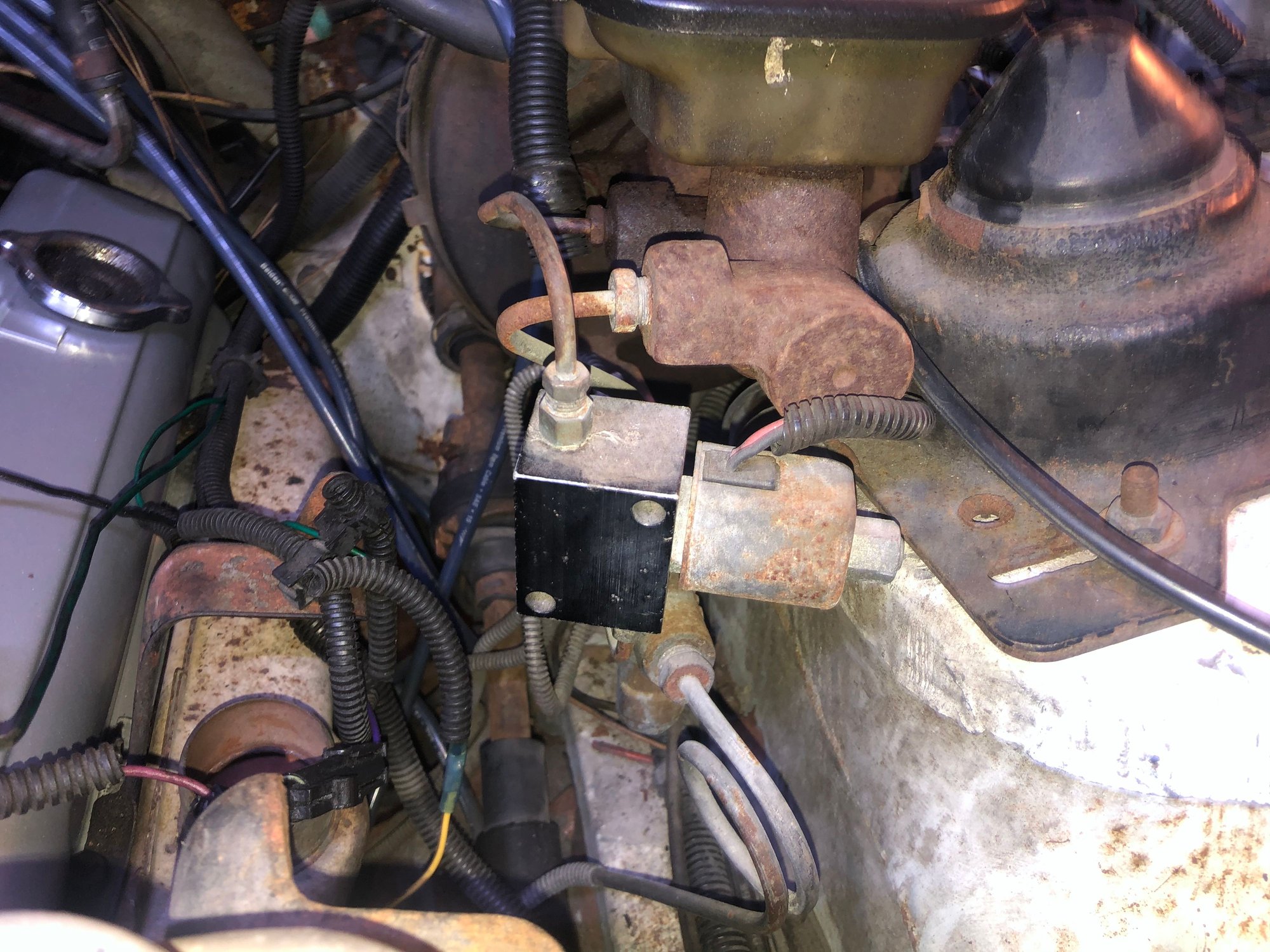

Anyone know what this module thing is on my brake lines?
I’m unsure what this does and haven’t been able to find anything about it, I’ve had a switch in my ashtray since I bought the car that has seemingly done nothing that I could notice and I’m wondering if it might be hooked to this and also wondering what this even does if anything I’ve looked at a couple of buddies engine bays of there third gens and haven’t seen them on there vehicles

Linelock.
Locks the front brakes for awesome burnouts and heating up the tires at the track

Re: Anyone know what this module thing is on my brake lines?
Oh SWEET lol I had no idea, if I were to wire it back in, do you know what kind of amps that would pull? Just so I know what fuse size to run
Also how am I able to tell if this one is “nhra compliant”?
I'm not sure, on amp draw. As long as it doesn't leak, i'd think it would be good. May need some more research
It looks exactly like the TCI 861700 that I just bought used here on TGO. The website has the details.
https://www.tciauto.com/universal-rollstop-kit.html
Resellers like Jegs have a more pics.
https://www.speedwaymotors.com/TCI-8...it,334542.html
