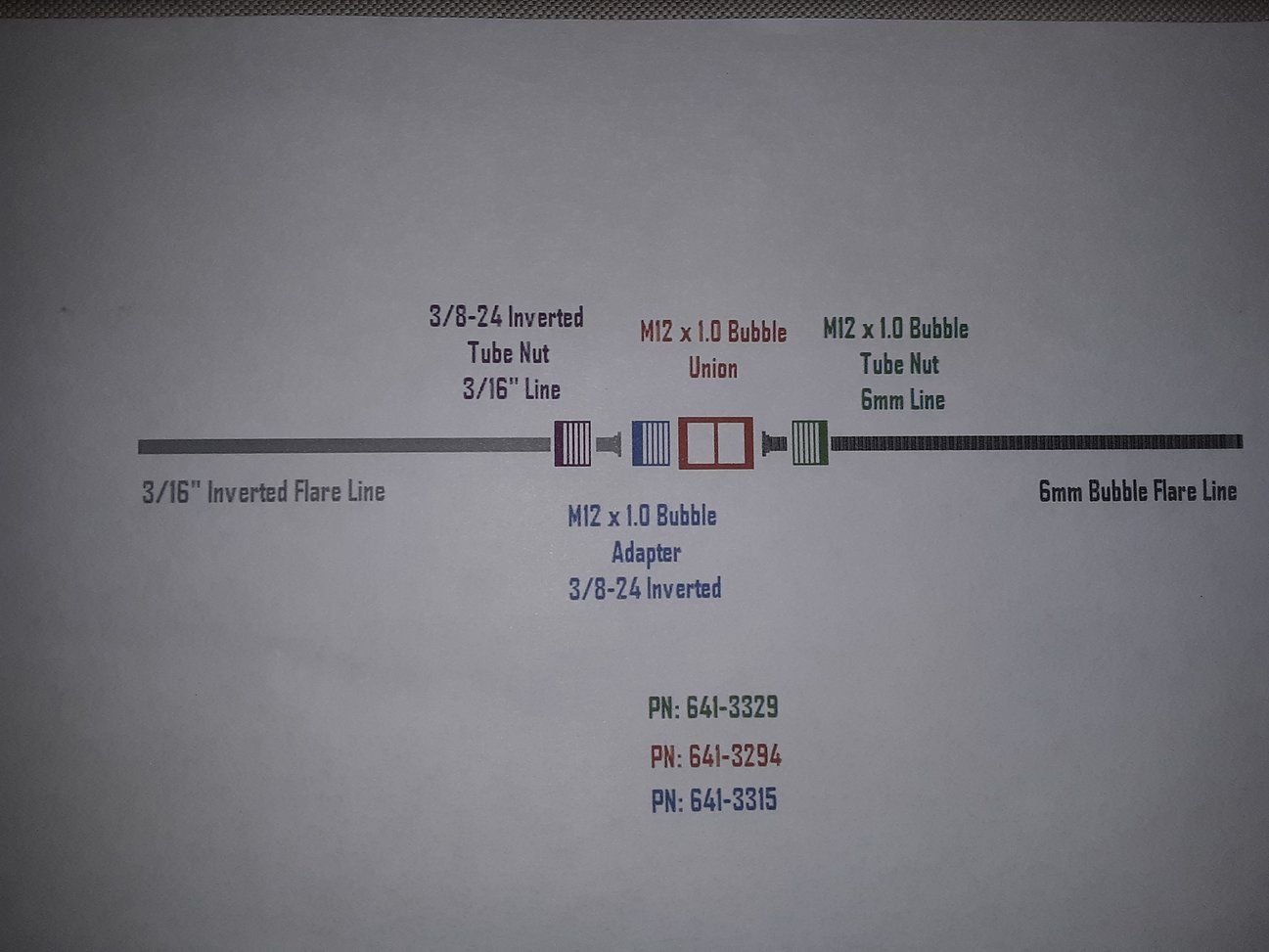

Napa Part Numbers:

You're not going to find an adapter that goes to metric bubble flare. You'll have to do inverted flare.
I desperately tried to find one when I was doing brake lines for my car. Even called SJM Manufacturing and spoke to the engineer/owner and he said it's not sold off the shelf but they'll make you a production run with a minimum order quantity.

5am and i just orderd the brake line and tool to do both ends.. with this tool..ya can do both double flair.. and bubble ISO Metric.. so No more [size=13px]adapter[/size] fittings or what have you.. ill use the tube nuts off my old lines..and make some nice tight fitting brake lines.to fit thye UMI K member. and cross over..25" of brake line is on the way also. (side note: will have some classic tube SS lines for sale) pre bent to factory specs! and they are 100% the same as what came off my car... so today ends with a beer at 5:05am and bed!
Old Jun 6, 2021 | 08:13 PM
vorteciroc's Avatar
Top Answer: 1
Joined: Jul 2006
Posts: 2,924
Likes: 803
From: 212 is up in this Bit@#
Re: 90 to 92 brake line fitting size..
As soon as the very first time that I touched this tool... I was addicted!
Now I have been spoiled, and can never go back.
These Sets new are now very affordable... also the Set is usually only around $200 used.
I purchased this Set about 20 years ago... and back then I think it cost around $1,400.

Nice. sets.. was thinking it was going to cost $100 just for a good tool to make the lines..when they told me $40..I was like. take my money! all my other brake Hard lines are stock..
just need to 3/16 front lines set up for ISO at 1 end to braided brake line. and Inverted Flare at the other.to Line lock... in 3/16th line...and it will work with SS 3/16th line..(Polished SS 3/16 line)
AND i GET TO USE my old master cylinder hard lines to make bench bleed lines. for the new set up..

and ...The front Brake lines the way I wanted Them!
