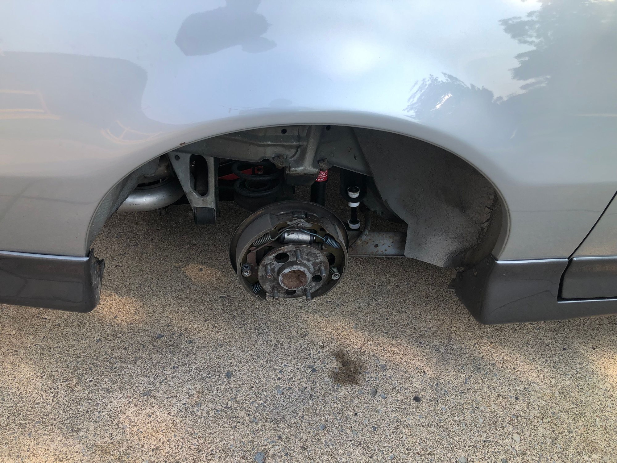

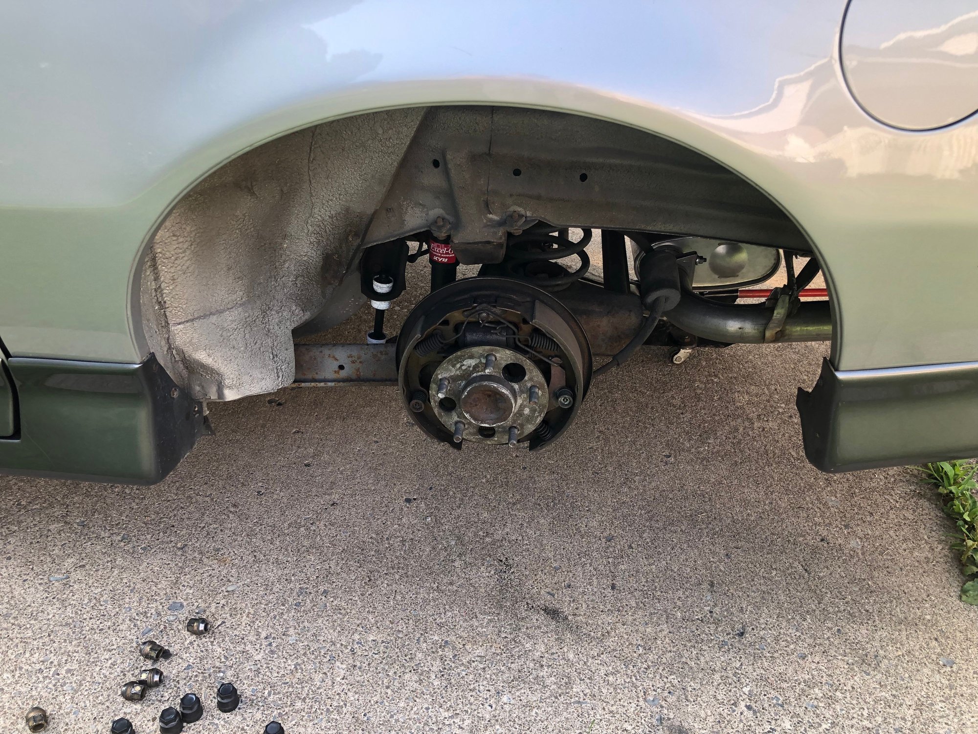

New shoes, wheel cylinders & drums.
Drivers side is doing all the work. I’ve bled and re bled the rear brakes repeatedly, I have a good pedal.

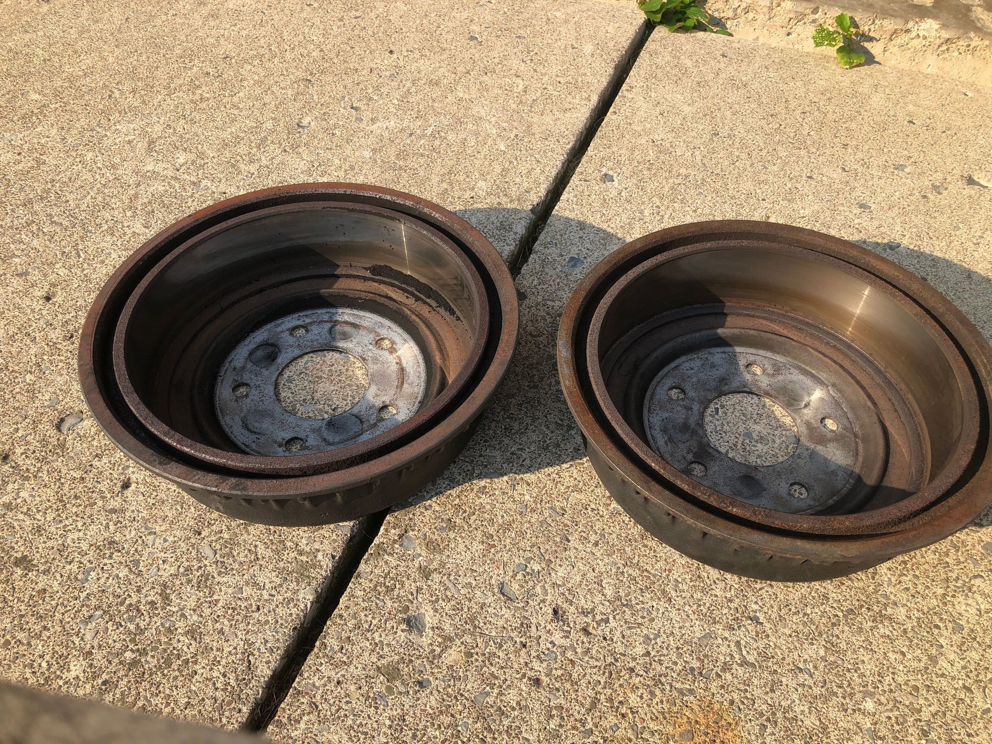

There appears to be a caramel colour in the passenger drum each time I take it off, little to no evidence of brake dust.
ive just finished sanding the shoes, going to give it another go.
no dampness under the wheel cylinder boots.
thoughts?
