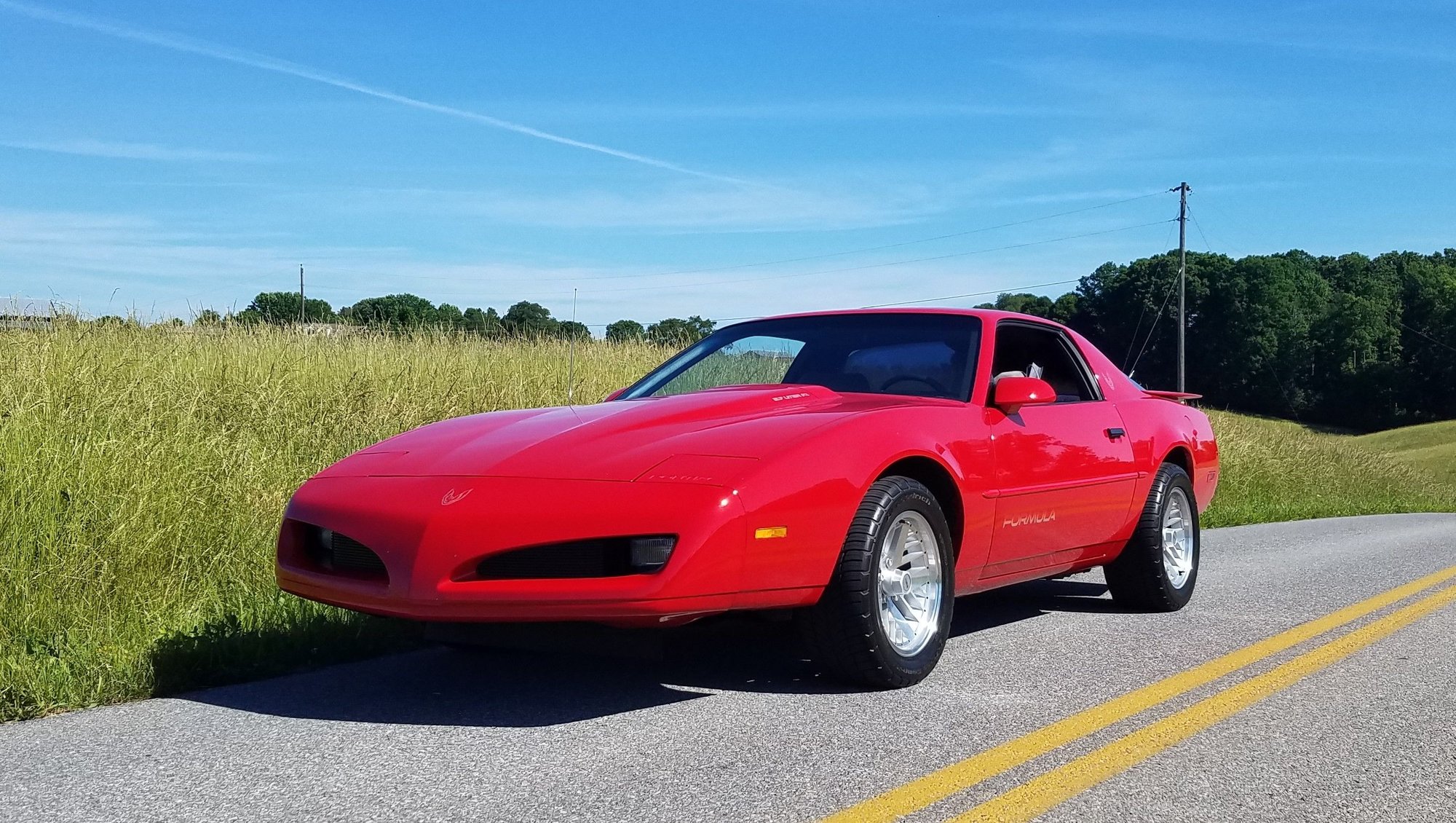

I threw in a photo of my Formula just to share.

Great looking car.
