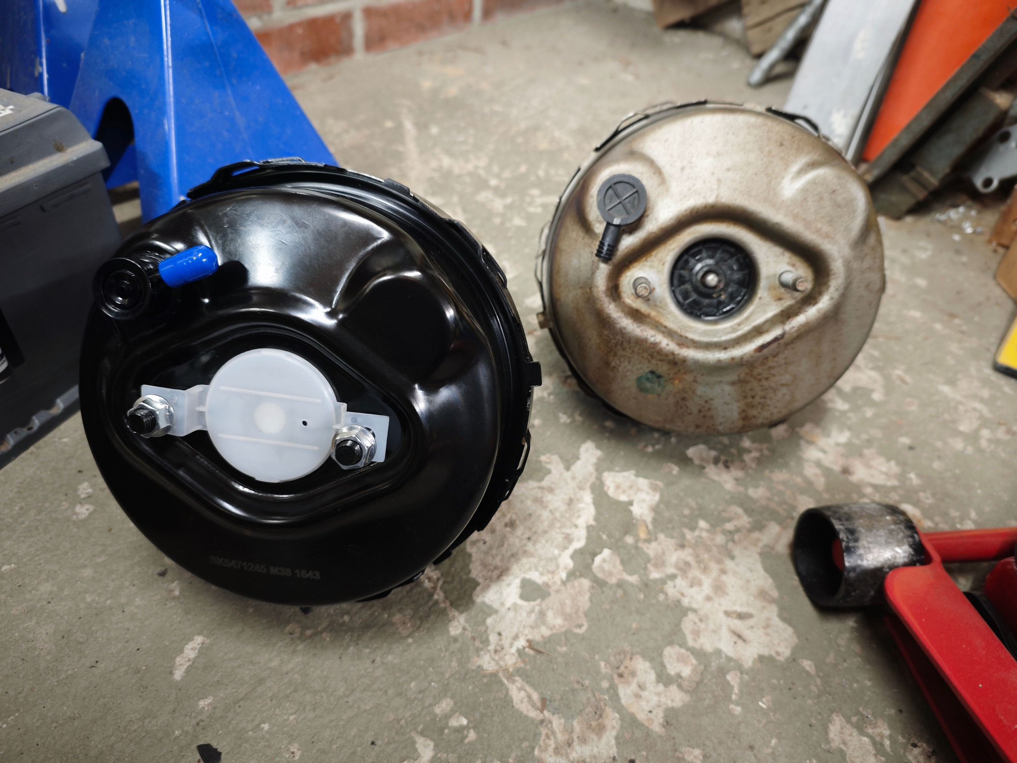

Don't know if you still need a new brake booster. I bought the skp from Rockauto and it is like nearly everything made in China but it looks like the original.
It is not installed yet but will be the next days and then I can tell about the function

Yesterday the booster went in together with a new master cylinder. No issues at all during installation. The top right nut under the dash is hard to reach but everything else was straight forward.
I had to replace both because the mastercylinder leaked fluid to the brake booster.
​​​​Vacuum check before installation was ok
