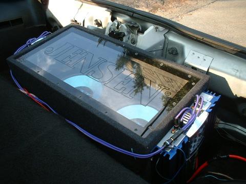

Nothing wrong with Explod!!
I don't know about there high's and mid's, but I am very happy with my sony explod system. Check it Out
3-10's in box I made,
Exlode Amp,
Pioneer 300W 4way's,
and a 1.5 din Pioneer head unit.
Lots Of Sound!!!!

If i were you id take back the amps to bestbuy becuz there stuff sucks. when i did my system at work i got everything from work excupt the installtion wireing kit. like the hugh 4 gauge wire and all that, so i went up to best buy around the corner from our store to see if they had stuff, well they did and it was 20bucks cheaper so i got it had it installed and everything was fine till those big fuses that u put into the holder broke but internally.
it didnt blow the fuse but the connections broke inside and i went asked for a new fuse from them, they gave me a new one out of a new kit and i put it in again the damn cheap *** fuse broke.
so i went to our radio spot in our store and looked to see if we had a 60amp fuse all we had were 40 so im stuck with those and well i put one in and the damn thing hasnt broken yet.
and i work at pepboys and if pepboys stuff is better then best buys, go with the place u probably wouldnt think of goin at first, like pepboys.
