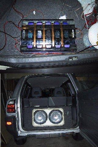

Its not 12 guage, the idiot shop at best buy said it was because they thought he was an idiot and to buy something from them. It was 8 because it origionally had a weaker system, but today we just wired in a 4 guage. So its plenty stocked.
the subs were wired normal ch1&2 to one sub, and ch3&4 to the other. That was really weak and so we brided 1&2 to one sub and 3&4 to the other. The HU has RCAs coming off the front and rear, so its got 2 sets of inputs. THe ground is no longer than 18inches 4 guage wire. Everything is connected so securely that they dont even wiggle. We have a huge fuse under the hood by the battery. The box is a Homemade bandpass, and i suspect that it leaks out the glass.... I found the amp here: http://www.dragondistributing.com/bossripper.htm *its the RIP995) and heres pics of things (btw the subs arent in that car, thats my dads and we just set it there while we were workin on it )

oops, heres the pic
