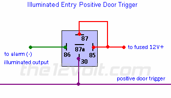

i found that site and i got htere for anything electrical before i go either here or any of hte other forums that i belong to
its great for other stuff to
in the spring i plan on adding a relay so i can dimm the lights w hen the door is open, and keep the radio going untill the door is shut after the ignition is shut off

Originally posted by super_kev
I noticed that my key won't stay back (like all our other cars) to keep just the radio on, is this the problem on all thirdgens? So you're installing a switch to bypass this and just run juice to the hu and amps, right? What size relay are you planning on using? And how are you going to dim the lights? I don't have a bulb in my dome light, and I put some of those blue colored bulbs for the two lights by the doors. Not very bright, but enough so you can see when you get in. Plus they match the color of the car.
not what i had in mind, this is what i was talking about
http://www.the12volt.com/relays/page5.asp#drto
http://www.the12volt.com/relays/page4.asp#iep
hope this helps you out

Oh ok, now I know what you're saying. Pretty cool idea.
