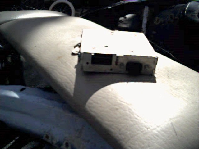

yup i just found out that if you have the performance sound option you get an amp right behind where the ecm is. i attached a pic...

That's an aftermarket amp in that pic--not factory at all.

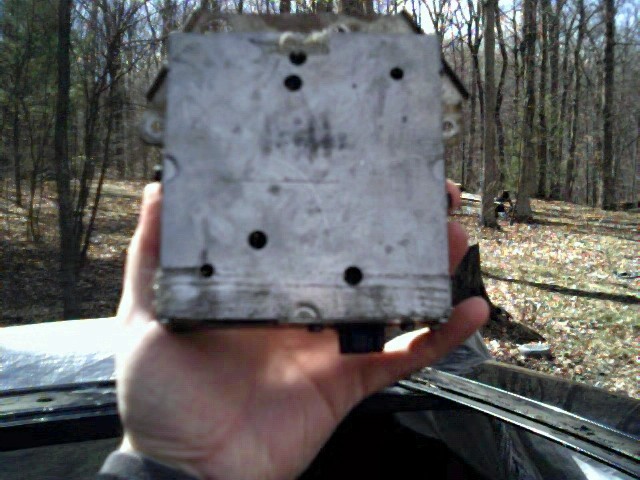

another
factory amp
its a delco amp
