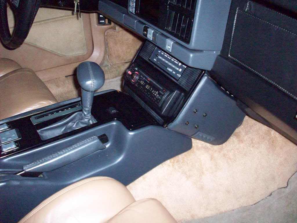

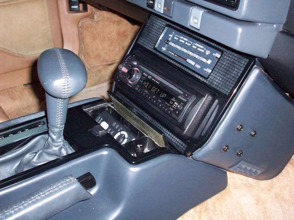

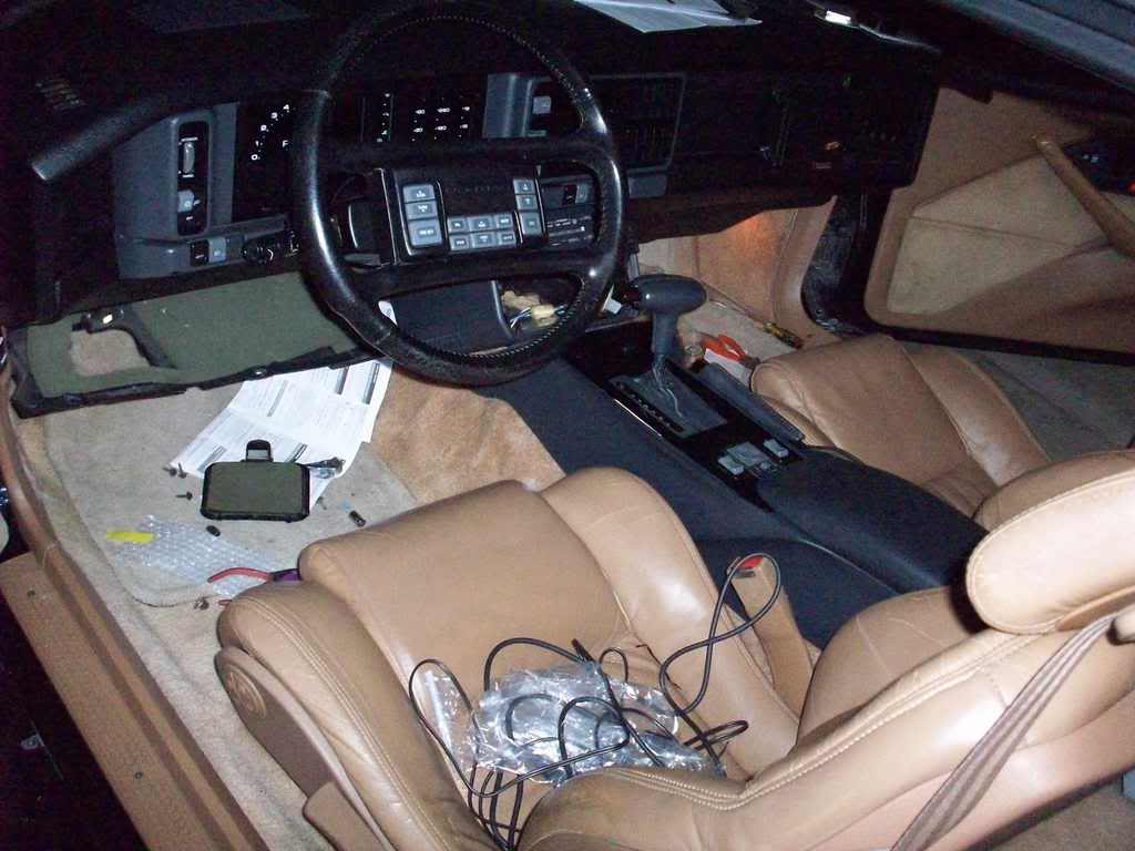

thank you very much again. I have the Haynes repair manual, and the owners manual and neither one said anything about the convenience center. It was all worth it though... Seriously, I you did live around here, I would take you somewhere for lunch or something just for ****in looking for me. That was the first project I did on my own on the car, or any car (im 16) so when I screwed it up I panicked a little bit. I know only basic things about electical wiring, but I'm really glad how it turned out. I ended up re connecting the HD tuner to the same electrical connections as the first time and it worked like a charm. I must have shorted something out, trying to do it too fast the first time. I crimped all of the connections, and then I wraped electrical tape around the power connections just to be extra sure. I ended up puttin the HD tuner under the passenger seat, and running the wires under the center console. here are a couple of pics, and a video I took (of course youtube made it soo dark you cant see anything.....) I also figured out that if you take out the ash tray, the remote fits perfectly its really cool.

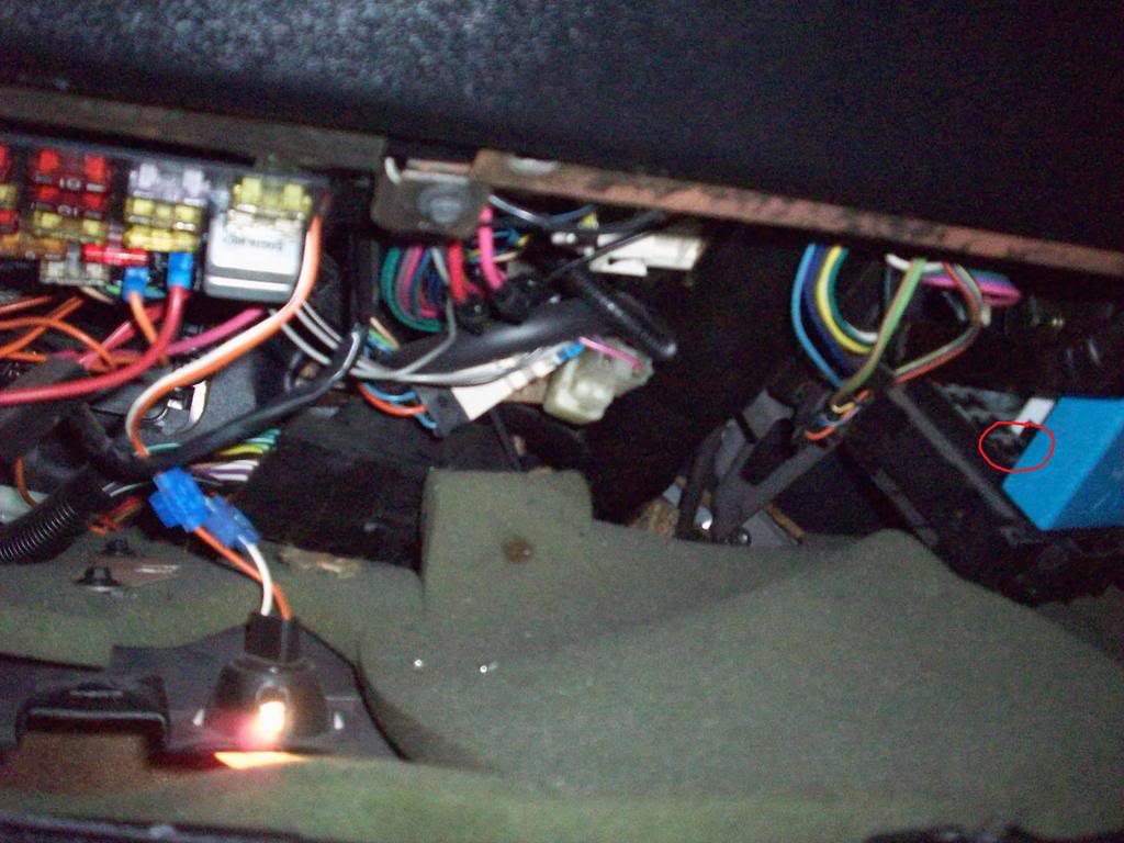

Here in this last image I circled the place in the "convenience center" that the 20" amp fuse was in. It wasn't that hard to get to, but it still wasn't fun in 20 degree weather... damn, you should have seen how excited I was when I saw it was blown!
