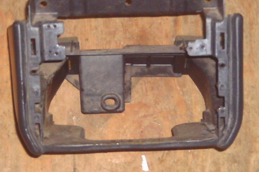

What do i need to put a raido in this firebird pod?
I'm missing a front plate or peace that goes to this pod where do can i find one? what else do i need to put a radio in this pod?

find a front plate on ebay. Need an install kit like this one to fill the hole. Maybe even a newish radio pod on ebay to replace the missing tabs. Looks like wiring is converted or hacked.

You're going to need to replace that "pod". There has obviously been a stereo theft at some point and the mounting tabs have been broken off.
You can make some mounting points but it is not really the easiest thing to do, for someone that doesn't have good fabrication skills.

the problem is your pod there is broke on both sides where the oem trim face snaps in. mine is too its cheap plastic and doesnt mean it was broke into

My radio pod looks just like yours, with the radio mounting tabs broken off. See the attached pic of the one I just bought off of eBay. I still have the original tape deck so all I need are the mounting brackets that attach to the tape deck and the screws to mount in. That should be fun to find! The radio pods themselves are easy to find, always a few on eBay, just have to find one with the tabs still attached.
