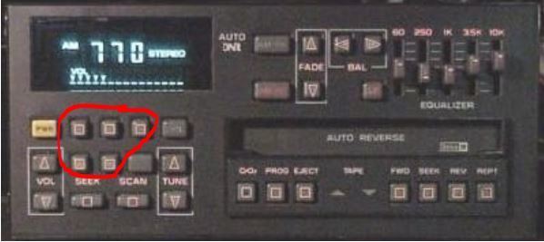

Hello Everyone,
My radio is currently in lock mode and the mute button did not work. Has anyone ever called GM to try and unlock a radio? I called today, and got some instructions but they were stating to push preset button combinations. Unfortunately since they are not labeled I am not sure which are the presets. This is a stock photo below and I assume the buttons circled are the presets? Can someone confirm with me if that is correct, and if so which button is which? Thank you,

That's not how you unlock this type of radio.
If it's a GTA radio than the only way to unlock it is by plugging it into a GTA (with all the other SWC parts intact and fully functional ) and pressing on the MUTE button. That's it..... that's how you unlock a GTA radio.
If it's a Bonneville (or Grand Prix) radio the only way to unlock it is to plug it back into another Bonneville (or Grand Prix). There is no other option unlocking these radios; ( **some** Bonneville radios can be 'hacked'; Proof = a pic of a fully functional 'hacked' DELCOLOC Bonneville radio in my 95Z. )
