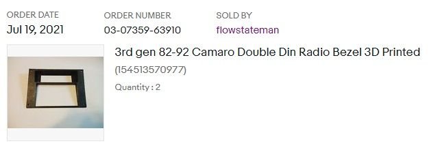

Double Din install Life hack
I got it to work, custom made brackets to install the stereo and to replace the HVAC controller bracket.

Where did you get the bezel?
eBay....

Thanks! Looks better than the one I got.
