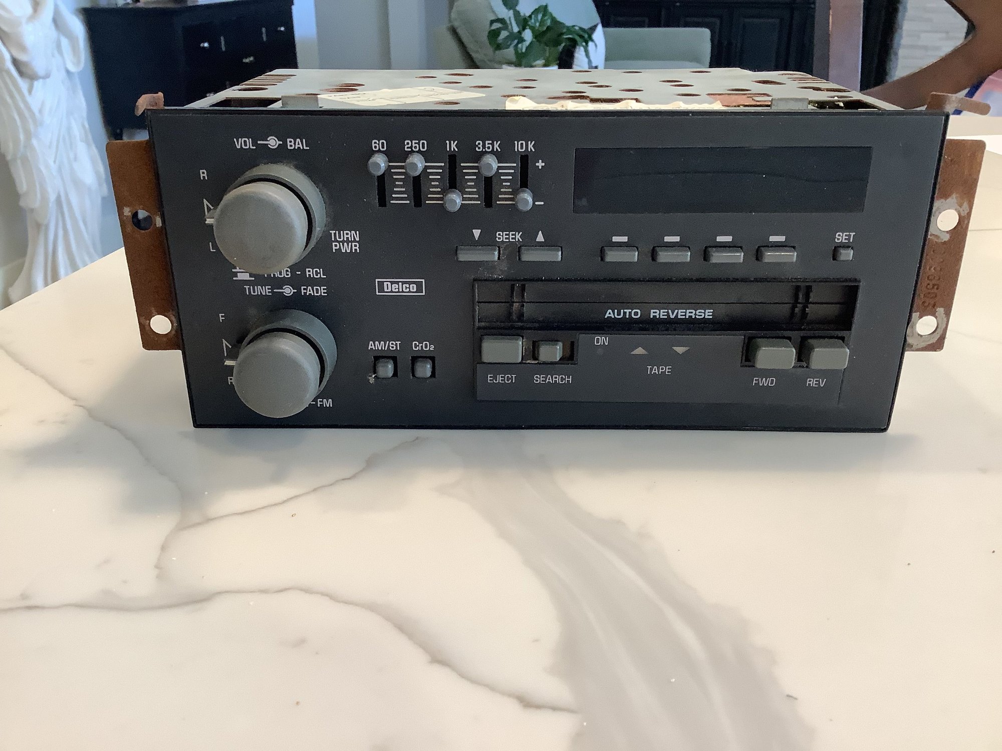

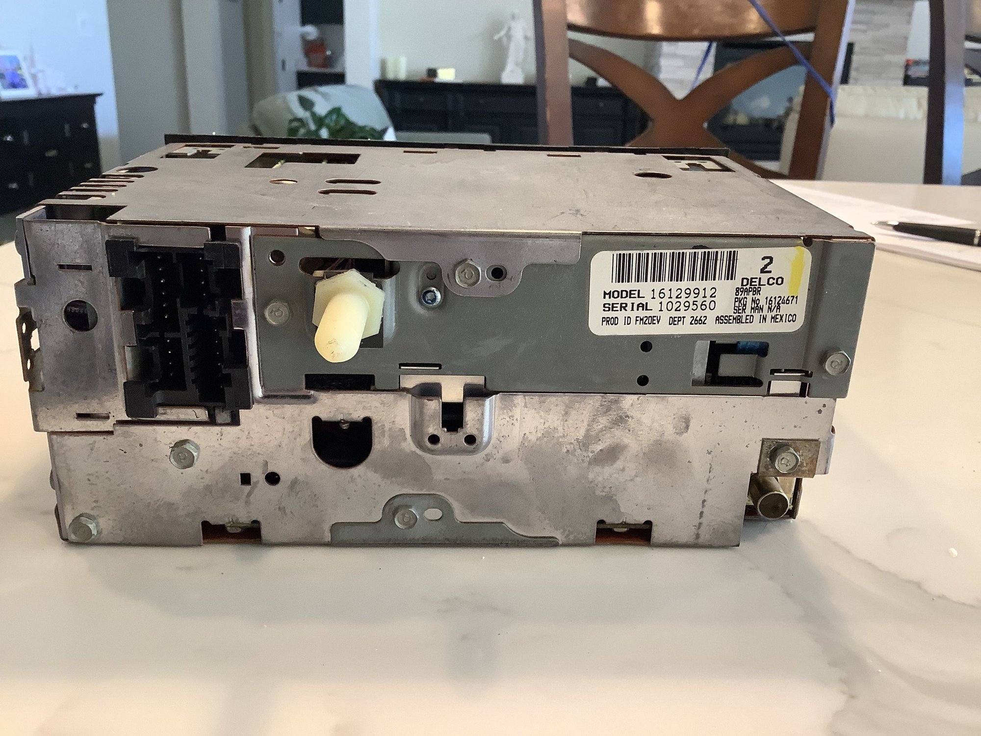

Hi This came with my car and have not tested it yet. I want to buy an aftermarket “Adaptor” harness that is correct, so I can test the unit in my. 1989 IROC Z Vert.
My SPID label is long gone. The IROC’s original order form states
“1SD IROC Z CONVERTIBLE PREFERRED EQUIPMENT GROUP #3 includes”
”AM FM RADIO W/ SK & SC, CASSETTE W/ SEARCH & REPEAT , GRAPHIC EQUALIZER , DIG CLOCK, W/ EXTENDED RANGE SOUND SYSTEM”. Does this sound like the radio in the photos?
How many speakers did my car originally have? Dash and rear 1/4 panel locations? Was the rear speakers Woofers”.
What year model vehicle the radio out of?
Is it compatible with my car?
Speakers 8-10 OHM front, 4 OHM REAR?

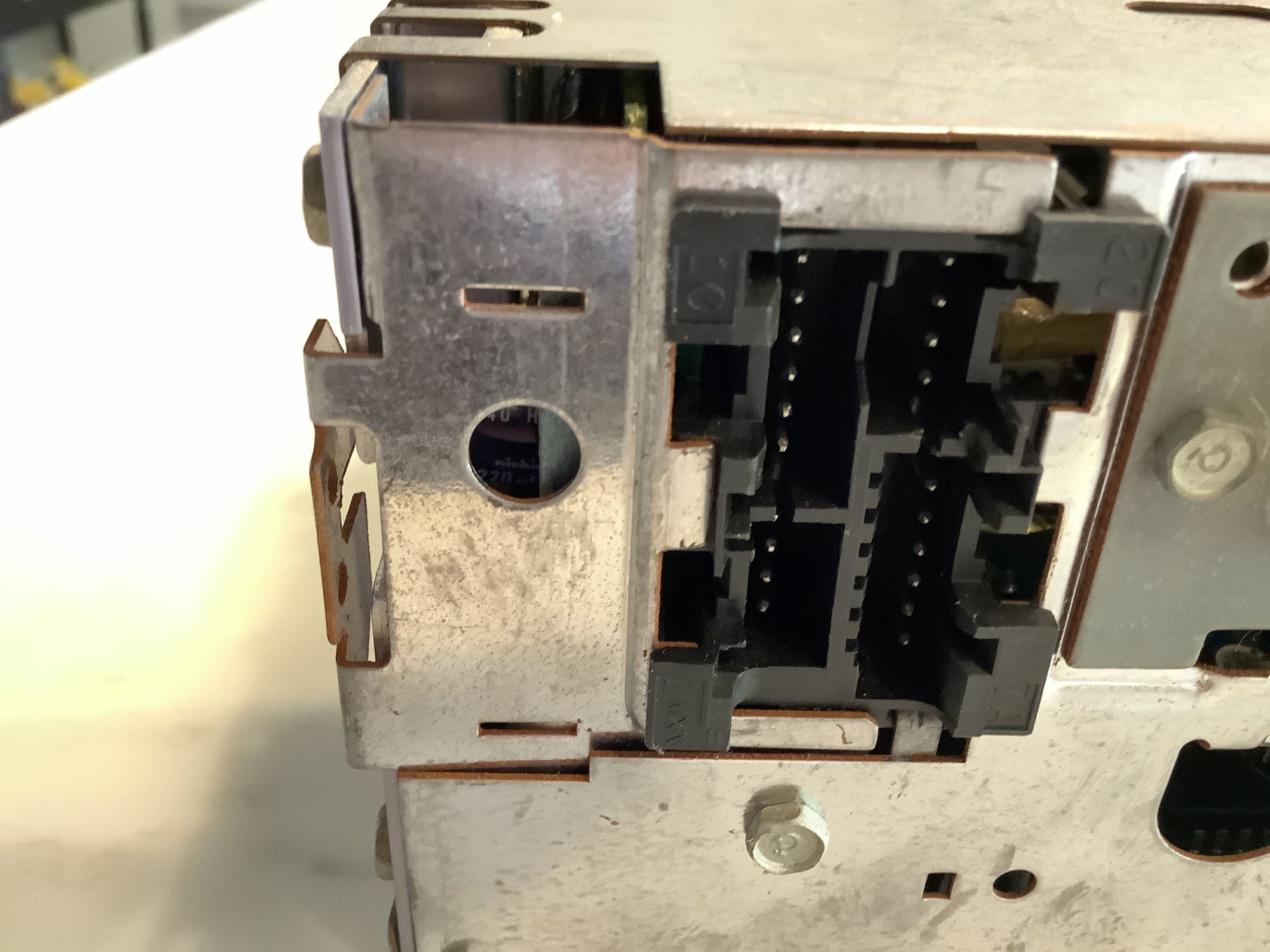

If I remember correctly, the radio’s connector plugs into my OE harness. (My car is not readily accessible right now to double check)
Thank you, Mikeceli

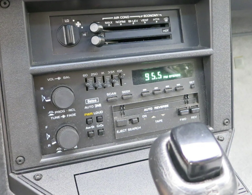

Some of the more expert audio guys here may have more to add, but that is the radio that Firebirds used for the UX1 option from 1990-1992. The Camaro one looks extremely similar but has very slightly different buttons and coloration, this one i think
It should plug in and work exactly the same as the Camaro one as far as I know. Stock speakers were 10 Ohm front and Rear. You can Run 4 Ohm rear but if you less impedence in the front it can cause damage from what I understand, so you want to stick with 10 Ohm or wire up resistors

OP here, Is my radio a UX1 ?

Yup,..... for Camaro; EQ = UX1.
The 89 Chevy UX1 radio should look exactly like the picture that @ughmas posted.
Your 89 dash harness radio plugs should be a direct match for the 90-92 Pontiac radio in your first post. ( no adapter needed. ) The Chevy radio correct for 89 will also use the same radio plugs.
10 OHM 4x6 in front & I "think" the convertible speakers were round 6", hopefully a convertible member will chime in with specifics.

ya, thats what I have in my Formula. Mike - you need to adjust your equalizer
