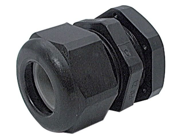

I ran the power wires two different ways. When I originally ran the wires for my amp, I drilled a hole in the passenger-side fender well near where the factory wiring enters the cabin. Later, when I ran the wires for my fuel pump hotwire kit, I drilled a hole near the top of the engine bay on the driver’s side, close to where the hood latch cable enters the cabin. In both cases, I painted the holes and then used something like this:
