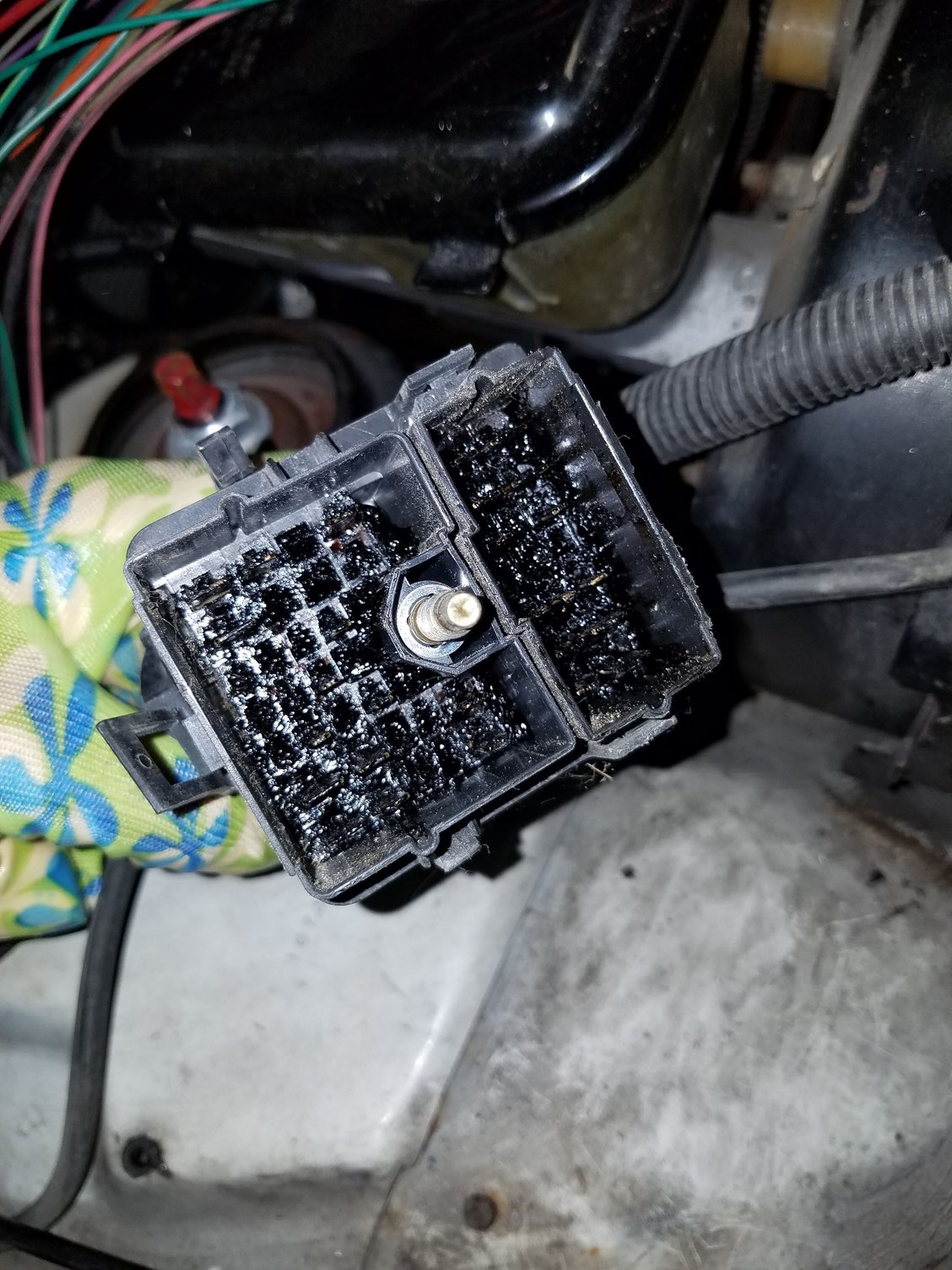

My c100 block on my 91 305 tpi to carb coversion camaro looks like this, now what

What you're looking at is GM P/N 9985313 Grease, Corrosion Preventive, Self-Skinning.
