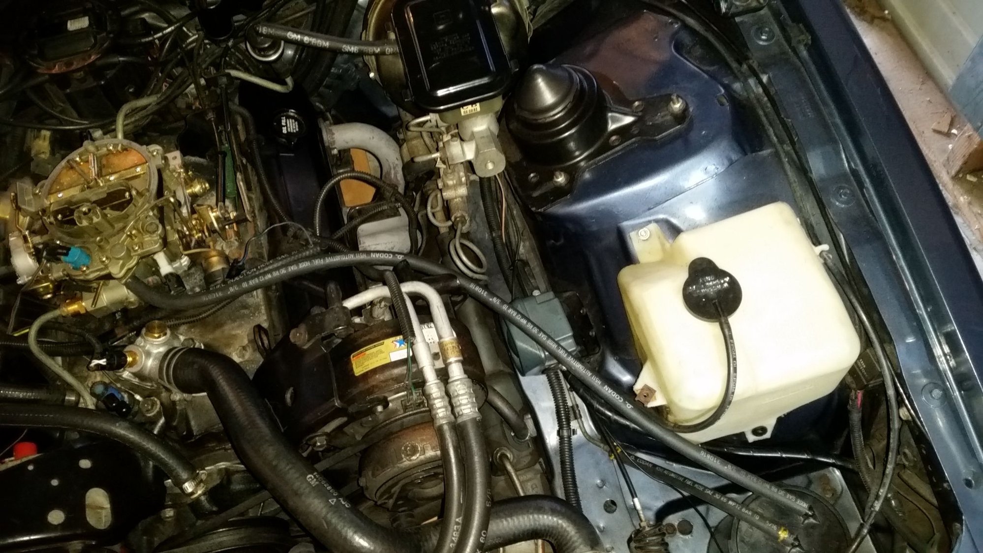

I know I'm a bit late here, but isn't the line you've got hooked to the "H" port on the carb supposed to go to a tee junction off the PCV line instead? That's how it reads to me, anyway.
Very similar to what I was doing with mine, or trying to at least as I've been stupid-busy til now.
Pic shows what I started with. Note I deleted the control valve at the time, but since been reinstated. I now have a new control valve and CCV. I'm currently trying to find a suitable replacement caniste
r as the original is now discontinued. Need to find something that will fit it's place first go as I'm in NZ and postage gets expensive quick!

some ccc-qjets are missing one of those ports, hence the 't' fitting into the PCV line.
