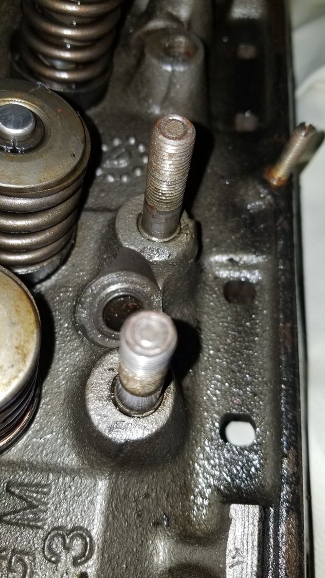

For your SBC, rocker studs come in 2 usual configurations - for 3/8" rockers and 7/16" rockers, but both types of stud will have 7/16" threads on the bottom to thread into the heads.

No, you have 3/8" rocker studs. That # is for the part that the rocker goes on, up at the top. Their thread is 3/8"-24 (fine) for the nuts.
From what I can recall from the earlier posts, you have those "repair" type studs (not "performance") with the 3/8" -16 threads (std) where they go into the casting. "Performance" ones, with the hex, are usually 7/16" - 14 (std thread) on that part. But that's not important to the issue at hand.
You can pick up a nut at HD or wherever to verify.

Re: 350 Small Block Carb or Timing Issues
Hey guys, so they are the 3/8 stud but the part that screws into the block its 7/16. I found some comp cams 1.5 roller tip rockers for pretty cheap so im going to get those instead of having to worry about my old ones getting any worse. I think im going to need new rocker studs because some of the ones i have came out pulling the old rockers and they dont have that hex on the bottom like almost every other one. The place where my brother works should be able to machine the heads. Also the water jackets look pretty gross so i was thinking about hot tanking the block to get it all cleared out. Idk if there is anything you can do yourself to clean it out instead of having to do that but if there is that would be nice to know.

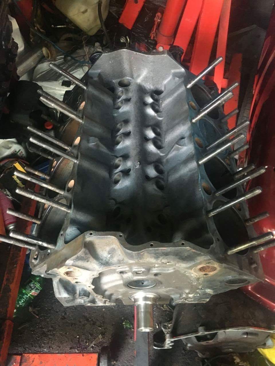

So thats what the block looks like (this is a pic from when the guy i bought it from was assembling it). I didnt know that there was a roller and non roller block. All the caps are lifters are out and labeled. The only things still in the car are the crank and pistons. The cam looks fine but the bearings are absolutely garbage. The crank looks like i could be machined but it has some grooves you can just feel.
one trick to buying junkyard engines is,if you can look at the vehicle dont buy an engine from a vehicle were the body is in great condition.
95% of the time this means it has some serious mechanical issues(blown/damaged,worn engine) and should be avoided(like i said,most times this is true,not always)
if it has a rear (or front)or side impact and lower kms often times you can get a really good engine but like anything,its the luck of the draw.
if you can do it,buy a running vehicle and get everything together to make the swap easier with less little things nickel and diming you to death.
so,as far as the swap goes:
1)if you have an automatic trans and you are switching to a one piece rear main seal block you will need a different flexplate specific to that block,for camaro/firebird it is 153 teeth
2)if you have a standard,same thing .the flywheel(or flexplate in an automatic) is specific to the one piece rear main seal because the crank is different.153 tooth flywheel/flexplate
3)the mounts from your existing engine should work as far as i know
4)you will need an oilpan specific to camaro/firebird to clear the k/member
5)you will need either headers or exhaust manifolds specific to a camaro/firebird
i hope this helps,we suggested the roller block because a roller cam is generally better(more aggressive lift with less valve-train stress),you can reuse roller lifters and the one piece rear main seal blocks usually leak a lot less.

#196
Ok, thanks for all the advice. I called a few local machine shops and they wanted a lot to re grind the crank. Autzone has a kit with a crank, main and rod bearings for $125. I also though absot putting a 305 in the car. No its not what i want and its not great but it would get in on the road. Ill look into it some more and try to get back to you guys soon. I start school again October 1st and i really want to get it done by then but im unsure if ill be able to
