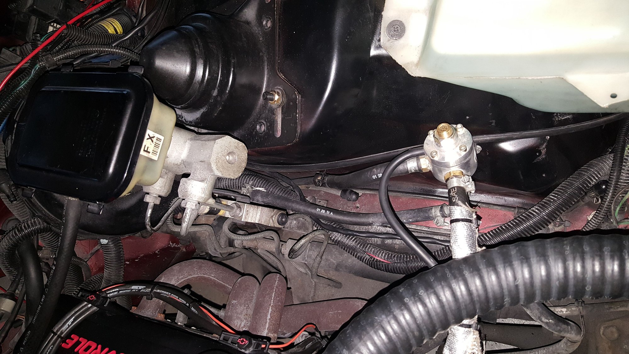

I have a 87 iroc, initially was TPI fuel injected. I swapped to a carbed 355 and am having trouble starting the engine when it is warm. It turns over for maybe 20 secs before it catches. After this, it will start immediately after I shut it off, but if I let it sit for maybe 15 mins after being warm, it will start hard again. I have a 750 double pumper Holley
What Have I tried?
Temp Control Carb Spacer
Replaced 60 psi fuel pump with 14 psi pump with pressure regulator (with return line)
Set fuel pressure to 3-5 psi
Wrapped Fuel Lines
Adjusted Floats to decrease fuel in bowls
Replaced starter with racing started (wrapped also to reduce temp)
Someone help me PLEASE!!!! Have had this issue since the engine swap two years ago, and have taken it to several shops and no one knows what to do.

That much fuel disappearing in 30 minutes makes it sound like a leak rather than a fuel boil\evaporation issue. But you've changed carbs, so that seems unlikely. But, you might want to take a peek down into the intake anyways to see.
What type of fuel line are you using? And what are you using to insulate it? What are your engine temps like? How are the lines routed? Obviously, the hotter the fuel is the faster it'll evaporate. I think modern fuels might even evaporate more quickly due to the ethanol in them.

It is 1 of 3 things: boiling/evaporating, leaking, or draining back towards the tank through the fuel lines.
That might mean that there is a vacuum created in your tank while running and the fuel is getting sucked out of the carb when you stop the engine. Is your tank vented properly?
How hot is it under your friends hood compared to yours?

Something ez to try is leave the gas cap loose so no pressure can build See if the problem persists. You may get some odors but you can deal with that for now.

Tank may not be vented properly. How should this be done? Also my engine runs at 165 degrees. Using the IR gun the carb gets to 90 degrees max on a hot day, no feul bowling. My regulator has a return line. I also have another fuel line that is not being used and it has a rubber cap on it.

I do notice that after sitting, the fuel pressure drops on my fuel line pressure gauge but maybe this is expected?

Tank may not be vented properly. How should this be done? I also have another fuel line that is not being used and it has a rubber cap on it.
That unused line most likely went to your charcoal canister, which I'm betting is not there either. There is also supposed to be a "UFO" valve under the car by the driver's rear wheel. Together, these take care of your tank venting. Cap them off and you now have problems.

If a vacuum is being created in the tank as the fuel is consumed, then it is entirely possible. But if your cap is vented, a vacuum should not be created. Do what midias said above - Something ez to try is leave the gas cap loose so no pressure can build. See if the problem persists. You may get some odors but you can deal with that for now.
Leaving the cap loose would also prevent a vacuum from being created.

Took the gas cap off and drove it, still has the same issue. I still have the UFO valve in place and in line. The canister is gone. UFO valve. Car has 70,000 miles on it.

This is very strange. It has to be a problem with your car, because you said that it does not happen when you swap your carb to your buddies car, and it still happens if you put his carb on your engine.
I'm starting to run out of ideas.
OK, describe your fuel supply system (type of pump, regulator, pressures, etc).

Here is my current setup

1) You MUST be using a bypass regulator.
2) Change the line routing to this. The only thing you need to change to this is a log type of fuel line at the carb.
But for a test, you can get away with a tee.

i have a Mallory 3 port bypass regulator. I have attached my setup so you can check it out. I am not sure how to change my setup to put the regulator after the carb. Do you have any pics of how to do that or can you look at my setup and tell me what I need? Regulator
Fuel Log
Gas line entering regulator

I am slightly confused with the fuel diagram you posted and wanted to know if you can help me get mine setup this way. Currently, my main fuel line goes into the regulator (IN)) the goes out the regulator (out) and then goes into the fuel log which feeds that carb. From the diagram you posted, I need to take the main fuel line and go directly to the fuel log then out to the (IN) of the regulator, but if I do that there is no connection for the gas to exit and go to the regulator. My fuel log connects on one side of the carb, and two spots and there is no other connection open, which means my regulator wont be in the loop at all. How and where do I add the regulator after the carb? Take a look at my pics that I posted so you can maybe draw right on them if need be. Thanks!

This is easy. You want to achieve the same as this.
https://www.jegs.com/i/Aeromotive/027/17249/10002/-1
But you don't need to purchase a $561. fuel log. You already have everything you need, except for a tee fitting. Or here are some much cheaper logs.
https://www.jegs.com/i/Speedmaster/7....1006/10002/-1
https://www.jegs.com/i/RPC/707/R2157/10002/-1
https://www.jegs.com/i/JEGS/555/100825/10002/-1
https://www.jegs.com/i/JEGS/555/15190/10002/-1
You will want to connect the tee at the input of your current dual feed fuel line.
So now you have created an additional connection. Connect your fuel pump directly to one port of the tee (FP directly feeding carb).
The other (new) port will connect to the input of your bypass regulator. Block the OUT on the regulator.
It works like this - your regulator will now control how much fuel is sent back to the tank, instead of controlling how much is sent to the carb.
Yes I know, not volume - pressure. Regulator controls pressure. But you get the idea. See it now?
