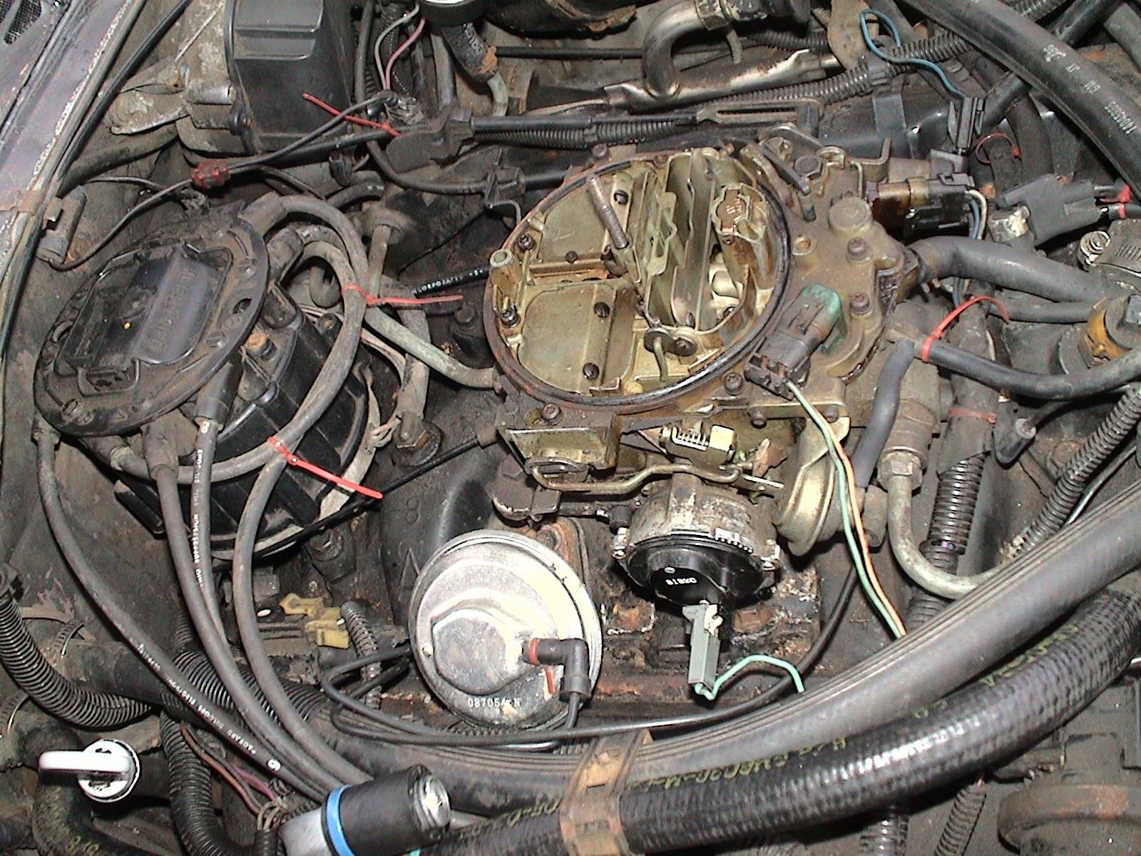

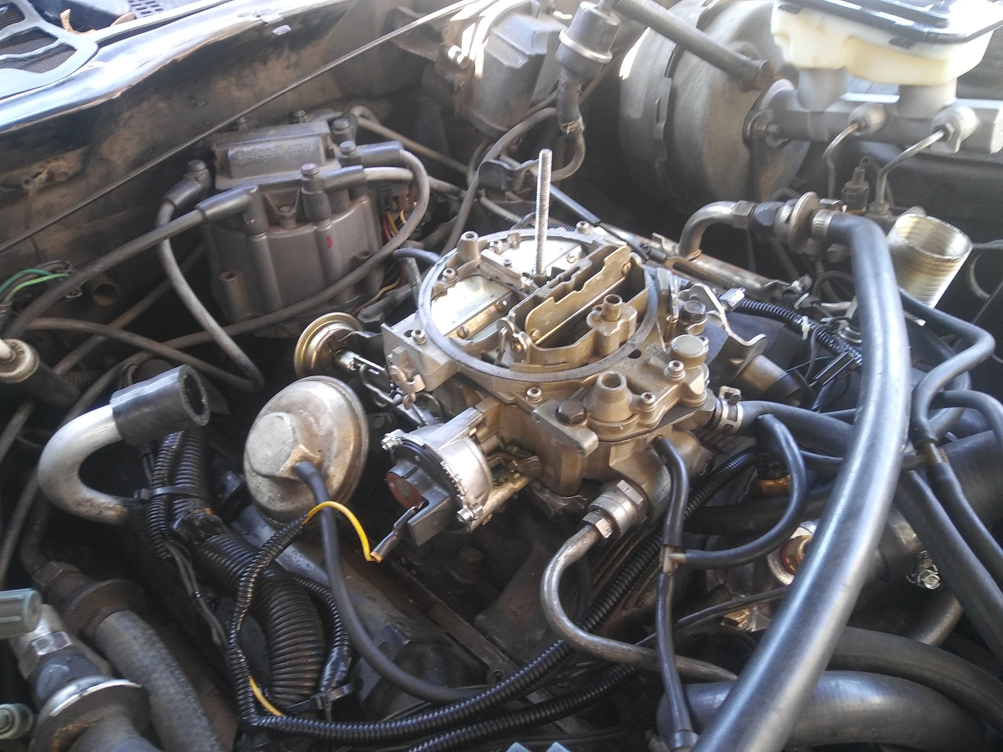

Did anyone notice that his picture shows a manual M4ME Quadrajet - not a computer-controlled E4ME.
Don't stop there...
2) EGR plugged into vacuum
3) Vacuum line connected to TVS with other port open
4) computer controlled dist with manual carb
OP
you have two options at this point
1) Continue on the path the car is on now and properly install the existing carb with the appropriate distributor and some method to engage the lock up
2) Return the car to stock operation with computer control.
I can only add that option 1 may be easiest and least expensive in the short term. option 2 could be more difficult, require acquisition of the proper carburetor and trouble shooting all of the associated sensors and gadgets required, that may or may not be now present and functioning. Option 2 will most likely provide the best fuel economy, drivability and power in the long run. I would go back to factory no question, but I have a few boxes somewhere that should have any parts I need and I've done this a time or two.

there's some evidence that the 'reliable' mechanic perhaps didn't understand what he was doing.
did it really pass smog like that?

I don't think the "mechanic" is fully aware of what's going on in your engine bay. He has the EGR plumbed wrong. I'm very surprised if it passed smog like that.
Being in CA, you had best find someone that is INTIMATELY familiar with the E4ME.

Looks Like Someone Embedded This Hose Into The Other One .

Both if possible. A carb specialist may turn up his nose at a computer controlled carb. You need someone familiar with 80's GM CCC carbs. Call around maybe.

That is exactly what I thought at first. But looking from the other side, that line is just right up against the sensor.

If you still have the original carb that came from the car, it likely can be sent in to be rebuilt.

you need an E4ME if you want a factory carb replacement
the one you have now is the M4ME, it does not have the mixture control solenoid.

Originally Posted by juanmhiii
I plan on getting a new carb and seen two on rockauto.com the only thing is one has open loop without solenoid air horn and the other has a closed loop with a solenoid air horn is that a big integral part of the function because i was just going to go with the open loop one. Thank you.
in your engine picture I noticed the distributor is not set in the proper position .. what is the timing and when you adjust the timing can you go advance and retard ? I have done that before on my 1973 Impala .. tricky when you remove distributor and re install back as the gears make it a bit of a PITA...
this is how it should look OEM MY 1984 V8 H..no idiot worked on this since I purchased it in july 1984.

proper position of the distributor is kinda irrelevant with the wrong carburetor installed and no TPS signal going to the ECM to adjust timing. If it's running as it is, the only timing advance is the built in limp home advance within the ICM.
I'd put off dickering with the distributor until the correct carb is installed and functioning.
