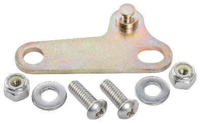

One item you forgot - throttle valve geometry correction adapter for the carb.
Old Mar 19, 2021 | 09:48 PM
Chip1977's Avatar
Joined: Mar 2021
Posts: 26
From: North Carolina
Car: 1986 Z28
Re: Distributors
This what you are referring to?
https://www.jegs.com/i/JEGS/555/157300/10002/-1?gclid=Cj0KCQjwl9GCBhDvARIsAFunhsmXHThfnosHAWse1h_OwRVi7HNZ3o4E8QVtX6fZgf8BeHWNIzFuIBcaAjd5EALw_wcB
Old Mar 19, 2021 | 10:10 PM
NoEmissions84TA's Avatar
Joined: Feb 2017
Posts: 4,185
Likes: 576
From: Meriden, CT 06451
Re: Distributors
Yes, exactly.

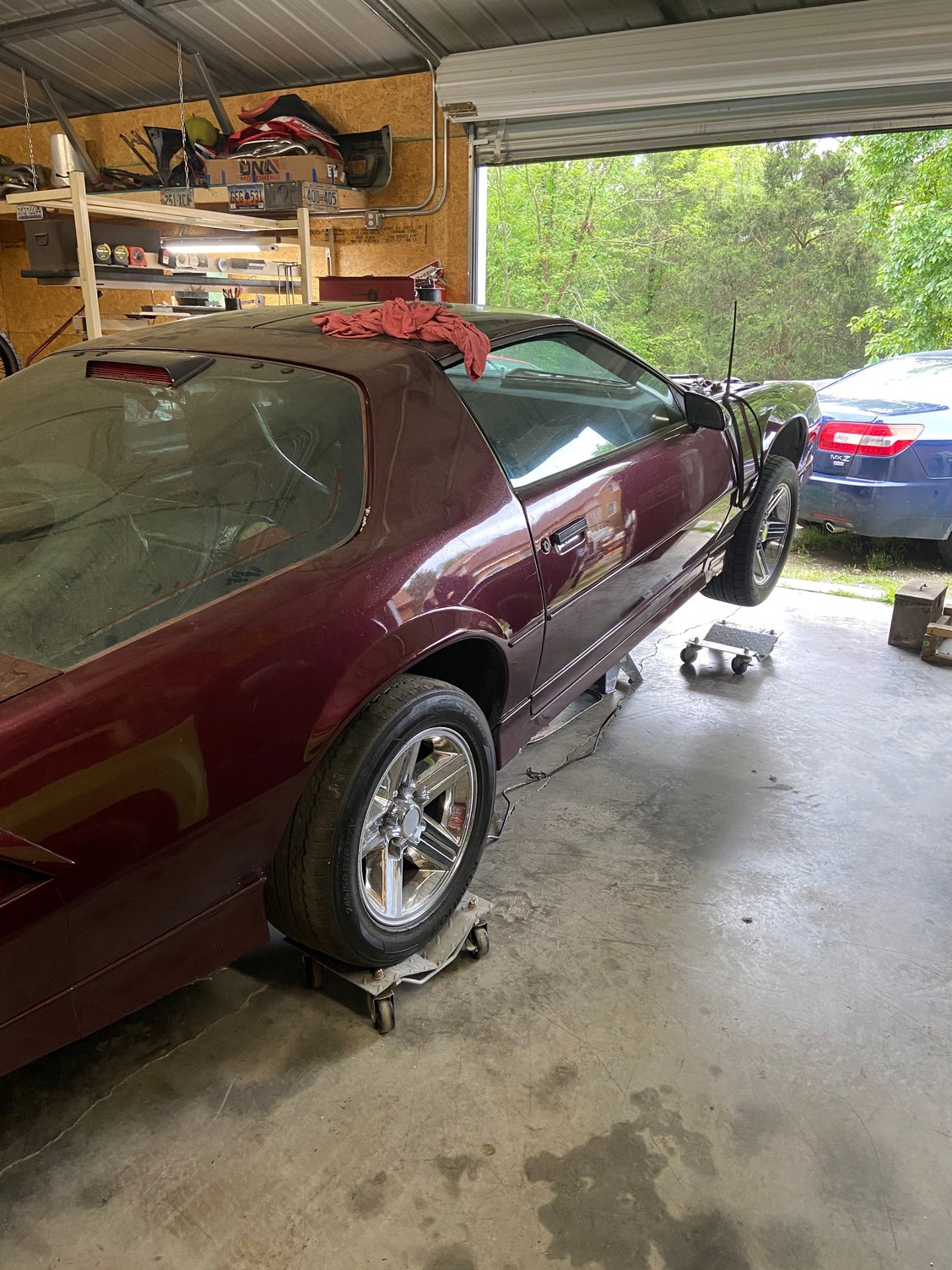

Old Mar 19, 2021 | 11:01 PM
Chip1977's Avatar
Joined: Mar 2021
Posts: 26
Car: 1986 Z28
Re: Distributors

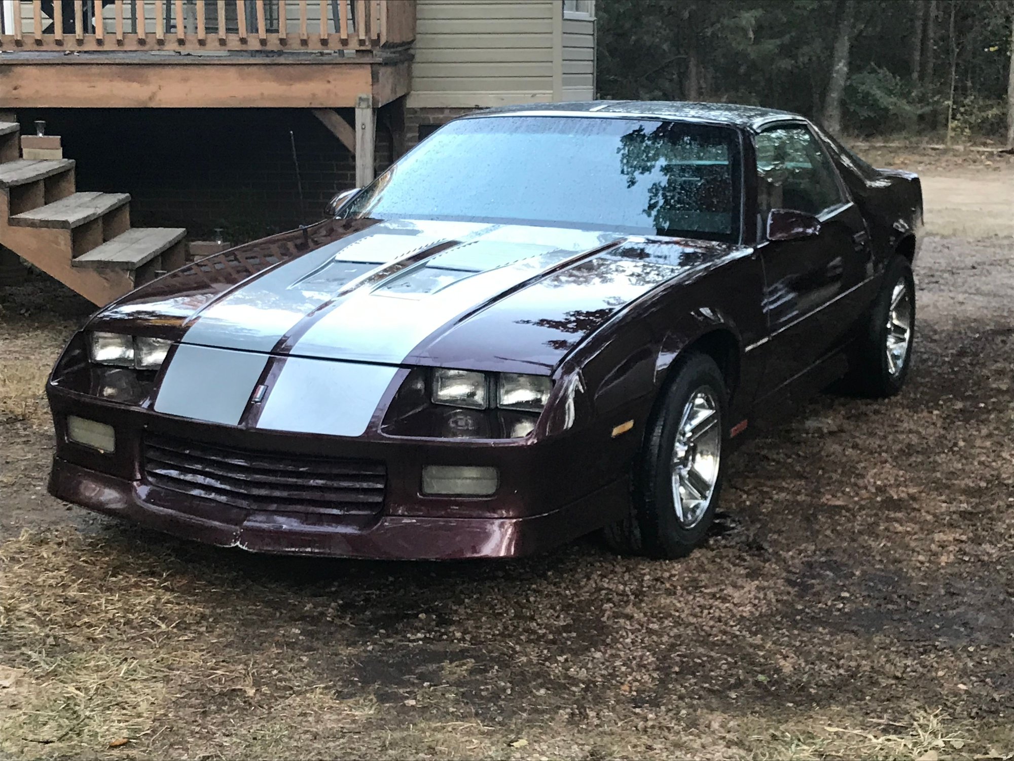

Old Mar 19, 2021 | 11:03 PM
Chip1977's Avatar
Joined: Mar 2021
Posts: 26
Car: 1986 Z28
Re: Distributors

Re: Distributors
Yes, exactly.
thank you. Already ordered.
