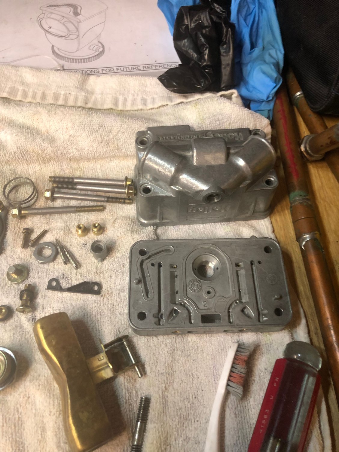

Here are a couple pics of the carb.
Like I said, its not bad.

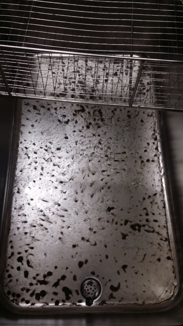

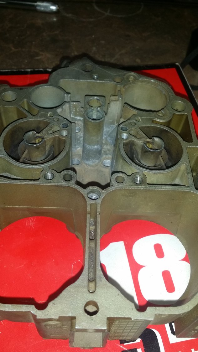

Simple green and vinegar solutions in a heated ultrasonic cleaner here. First bath is around 2 hours of cleaning at 160°F in Simple Green and water mixture. 2nd bath is 30 minutes to 1 hour in a mild solution of vinegar (the kind you clean with not eat) and water. Then it gets a fresh water dip and blow it all out with compressed air. On carbs that have more corrosion than usual or that I am going to zinc plate, I use a very mild solution of muratic acid in water in a bucket and dip them with the plating wire already attached until they are clean. Carb then goes directly in the plating bath bucket while still soaking wet. The muratic acid will eat the coating after a short time as well as any corrosion leaving a nice surface to plate.
This was an Edelbrock 1405 in the bath after 2 hours and what was left after the waste solution was drained. It as a mixture of dirt, carbon, varnished gasoline, oil and corrosion. The Edelbrock also had alot of glittery metallic debris in it that appears to have been left in the casting after they machined it. After the first soaking, it gets a second soaking.
Quadrajet bodies had only been through the simple green bath. The vinegar removes almost all the corrosion... Notice the idle down tubes have been removed from them prior to the baths.
