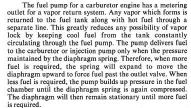

Just asking out of curiosity; what is the purpose of the 1/4 inch return line on a carbureted thirdgen with mechanical fuel pump? I have a '73 F#rd with mechanical fuel pump and it has never had a return line...

As I recall, it is mostly a vapor lock prevention. Not saying I'm correct but that is the theory.

Re: Fuel Line Question...
