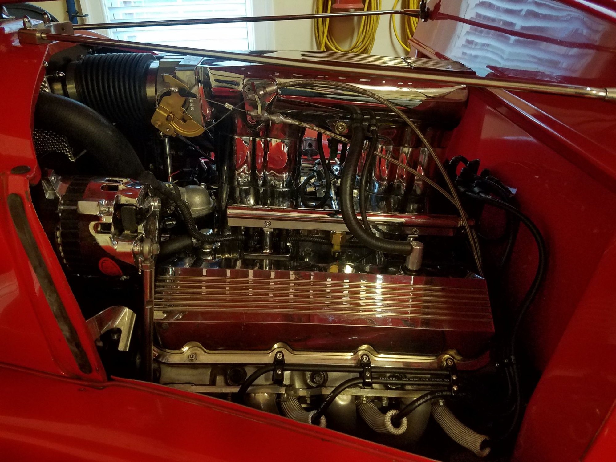

Re: 87 iroc 5.7 going carb
My TPI Set up before the change
Old Sep 17, 2023 | 10:09 AM
Chaddyboy's Avatar
Joined: Aug 2023
Posts: 79
Thats a beautiful machine.I still have to figure out my throttle body cable connection as mine was originally a multiport.Ps I bought a 340lph fuel pump and it destroyed my regulator diagram split open not good.
