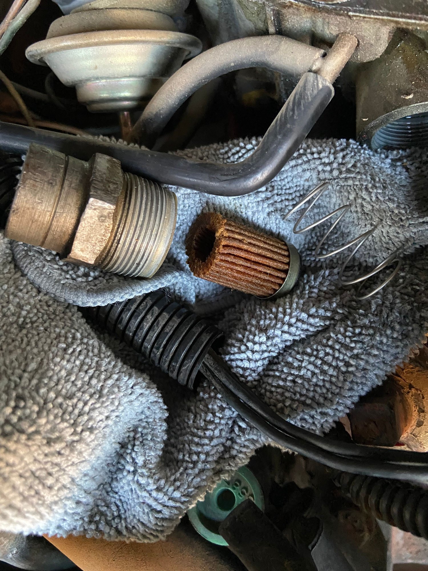

Recently bought this running (I know right?) 3rd gen and had a bit of time after work to start looking over the motor and noticed my fuel line is cut and joined together by a rubber hose, decided to pull off the line from the carb and noticed this lovely mess of a fuel filter.
Did 2 seconds of google and found out I need to run the short fuel filter with this carb, but would anyone know where to find a replacement fuel line so I can at least have a smidge of peace of mind? I do plan on dailying this when its back to its former glory.

You can get fuel rated line at any auto parts store.

I ended up doing what Shifty said; is bending my own after getting some inverted flares to match the fuel pump and my aftermarket carb. I don't like what the modern gas does to rubber fuel line after a few years. If I had the stock Qjet I would purchased one of the following to make the job easier.
