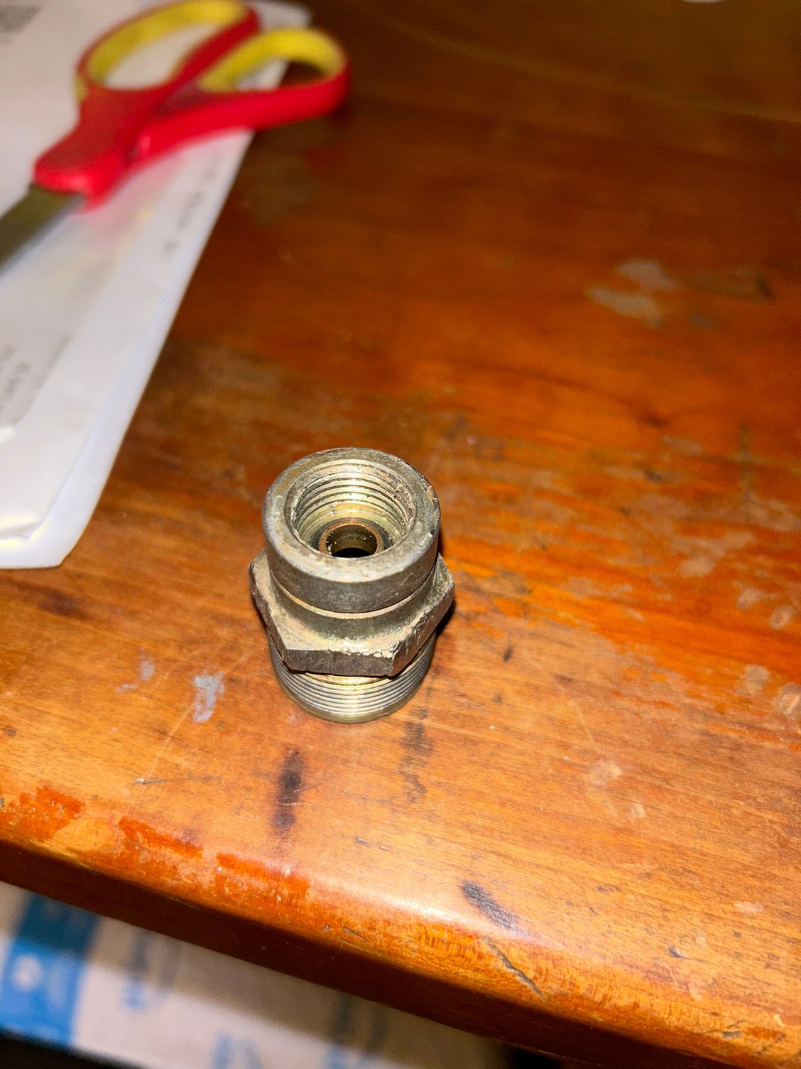

If there is a book, I wish I had it, because I’ve got a new problem now.
I was finally able to remove the inlet after cutting a greater section off and slamming a 5/8 socket on there with a breaker bar, and I noticed that there’s a little rubber gasket within the fuel filter housing.
I’ll need a new inlet line so I picked up this dorman replacement (which isn’t the right size and has to go back to the parts store) which has the o-ring on the line itself:

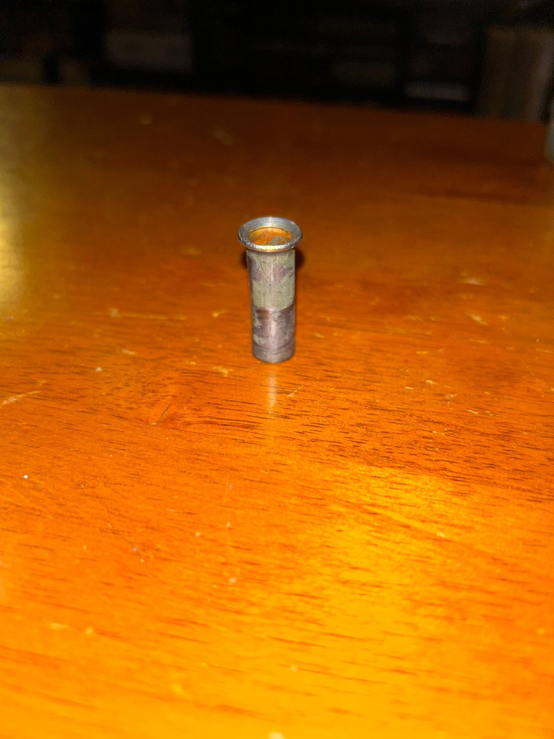

What I removed from the stuck 5/8 threaded fitting, however, looks like this:
I don’t know if that o ring is SUPPOSED to be attached to the fuel line or supposed to be attached to the filter housing, but I know that the filter housing I ordered ain’t got it.
Can anybody weigh in on what I should be looking at with that gasket?
I also realized the reason (or at least one of the reasons) I was leaking gas constantly was because the little nylon gasket between the carb body and filter housing was simply not there at all so I guess this fuel like break was a blessing in disguise: I would have never noticed it otherwise.

Yeah whatever you have in that pic with the O-ring, that's a power steering fitting. Typical Saginaw O-ring setup. Not the right thing for a carb at all.
Carbs always have yerbasic inverted flare like the last pic. Stuuuupid eeeeezzzzy to create yerself with yerbasic double-flaring tool (folds the tubing over inside itself, then flares it, such that there's 2 layers of metal where the nut clamps it, as you see in yer pic). Get one. Once you get used to using it, it's AMAZING how often you'll run into uses for it.
Can't answer about "book". Not sure there ever was one, but if there was, all the GM part #s are LONG GONE. These cars are ANTIQUES: older than 25 years. Any kind of "book" you find is gonna be ... worthless. Wrong line of inquiry. Instead, learn to deal with the generic properties of the parts you're working with. In this case, 3/8" tubing, inverted flare.
The pic you had at first, with that big brass nut and the thin nylon gasket, is the right thing. It's also inverted flare where the line goes into it; just like stock. If your stock line wasn't pre-destroyed you could just hook up to it. Oh well.
Problem you now have is, the place you need to put the rubber hose splice, is about the WORST POSSIBLE spot to do that, because of the bend in the line pieces that are left.
Here's what I ended up doing on my own car some decades ago in a somewhat similar situation. Exactly the same except different. I flared the OE steel line as described, then used a section of braided line and its fittings to hook from the carb to the remains of the steel line. I'd suggest that some similar approach is probably best in your situation.

I’m not certain this is a power steering fitting. It came straight off the Rochester and looks nearly identical to the initial picture I posted save for the gasket around the center. I took a new picture that looks more similar to the replacement I posted up top:
The only real difference I can see between the replacement part I haven’t yet received and this filter housing I removed from my carb is that gasket. Are these totally different parts?

The brand-new Dorman piece with the O-ring on it is the thing I was referring to as a power steering part, not the fuel filter housing.
There's no "little rubber gasket" in the fuel filter housing. What you're seeing, that dark-ish discoloration, is merely where the flare fitting on the end of the steel line, was seated on it. There is no gasket in a flare fitting. It's all metal-on-metal. The material the line is made of seals directly against the seat in the fuel filter housing.
In my pic, the blue fitting screwed into the fuel filter housing is an adapter; 3/8" inverted flare <–> #6AN, somewhat like this https://www.summitracing.com/parts/sum-220667b. Then there's a blue swivel 90° #6AN hose end with a red hose nut; again, somewhat like this https://www.summitracing.com/parts/sum-250687b. You would still need to slide a flare nut on the end of the remains of the OE steel line https://www.summitracing.com/parts/urr-ps2125 and then double-flare the line, and use an adapter at that end, perhaps somewhat like this https://www.summitracing.com/parts/fra-491942-bl, and another hose end, probably a straight one, like this https://www.summitracing.com/parts/sum-250690b. Of course you'd also need a short piece of braided-stainless PTFE line such as https://www.summitracing.com/parts/sum-220988. Quite simple and straightforward really.
