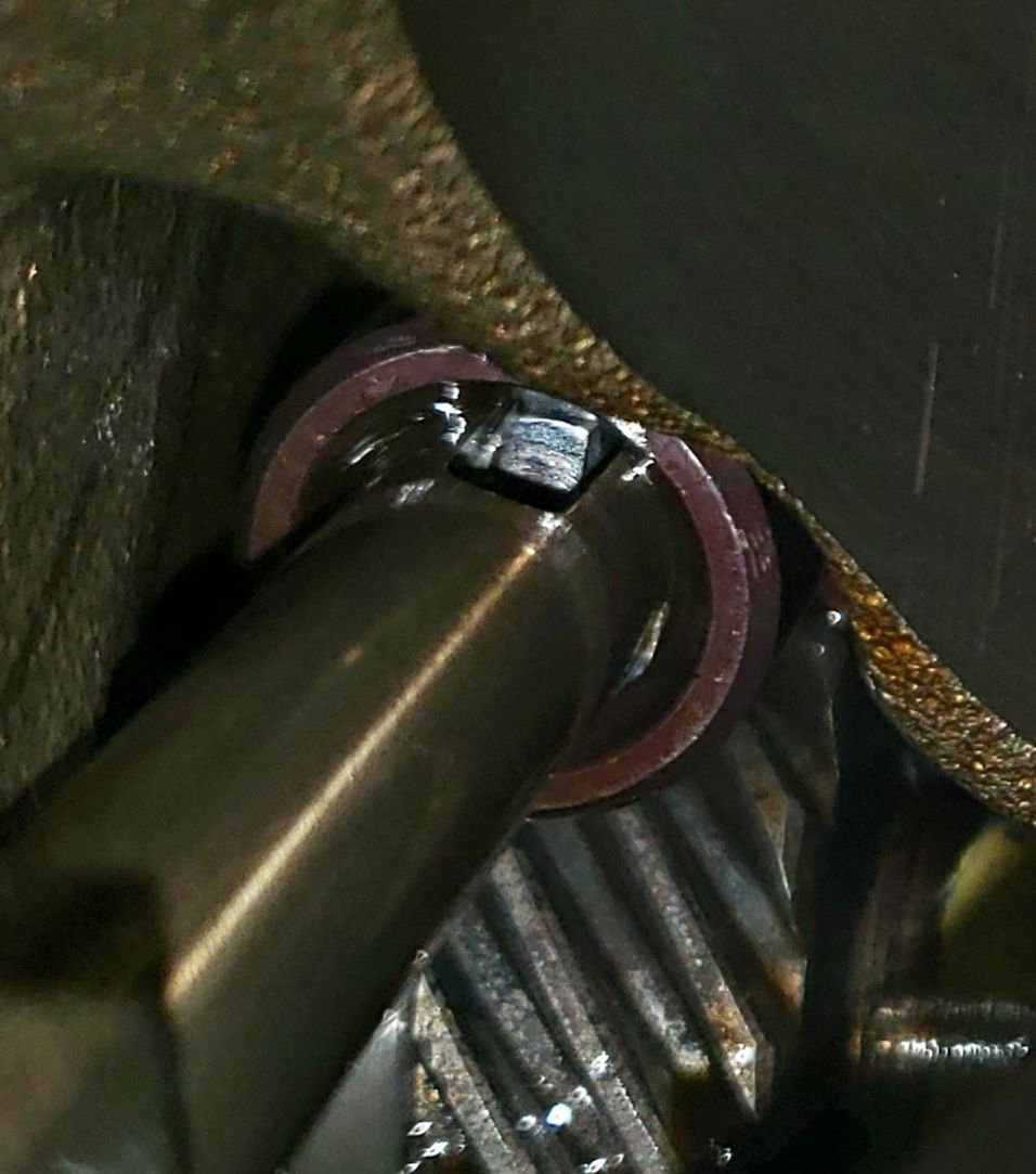

Old Oct 12, 2023 | 12:37 PM
Yakmastermax's Avatar
Joined: Mar 2023
Posts: 5
From: Albuquerque NM
Car: 1989 Corvette, 1991 Corvette, 1985
Transmission: ZF6 and 4+3
Re: Oil pump drive engagement check, distributor, LT1 Intake conversion
Picture with the pan pulled
How does this engagement look?
Not enough or adequate?
Old Oct 12, 2023 | 03:43 PM
Posts: 28,027
Likes: 2,498
Looks fine to me.
