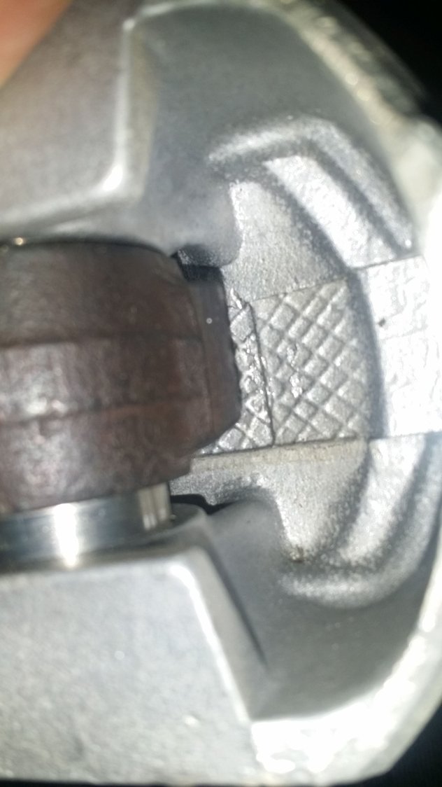

Well I can only speak before and after. The vehicle spark knocked enough to have loads of knock retard. A couple of tanks of top tier cleaned it out well enough that it stopped spark knocking.
I have also never seen an engine run on conventional oil that did not have some kind of buildup on the back of the pistons and oil control rings. This piston was out of a carbureted engine that had over 150K on it when it hydraulic locked and bent a rod. It was running top tier fuel and synthetic oil.
I also had a Vortec that I ran GM Top Engine clean in every couple of oil changes to help keep the manifold from carboning up from the EGR. Far cleaner when I tore it apart than others I have had apart. Techron was also great for helping prevent the Vortec poppets from sticking. I had one that kept getting misfire from sticky poppets. I cleaned it using straight Techron into the fuel pressure test port to run the engine, then used a bottle of it about every 3rd or 4th fillup. Never had a poppet stick again.
