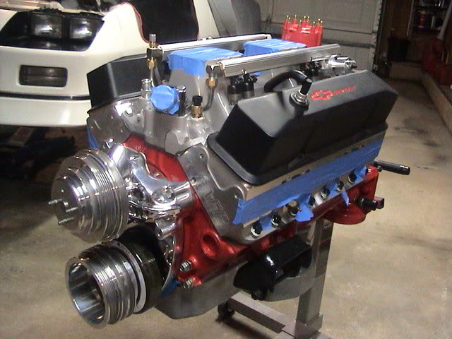

sorry guys for getting back to this so late...
I got it in!....it was almost a combo of all the above....well except for having the wrong parts. It was just a very tight fit and ther was a slight burr that I had to get rid of....and I did a search...and also found that I could take some really fine sand paper and smooth out the dizzy shaft...
all in all it was a nightmare but it is in..sometime I feel so stupid but oh well!
thanks for all the ideas....I know I can always count on you guys to come up with solutions.
we'll get this motor together in no time..
heres where Im at
heres where Im at

Most likely it has more to do with the cam/oil pump drive engagement, but strange things can happen.
There is another very remote possibility that the distributor has the wrong gear on it (reverse rotation cam - YES, Mildred, they are different, like a Comp 411 versus a Comp 413).
you got a stock dizzy around to compare it?

I had to change my MSD distributor gear. I needed to put on a bronze gear required for a billet cam.
