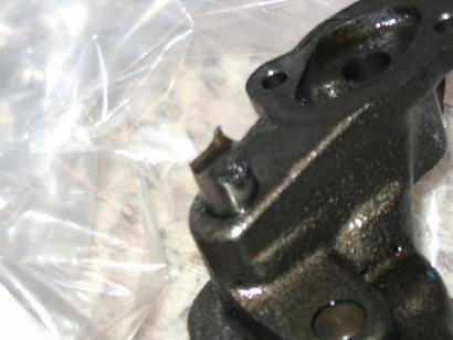

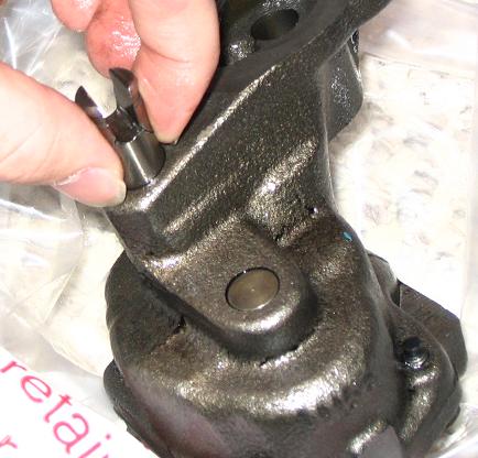

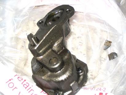

Well, I got my oil pump off today. BOTH of the 'ears' on that the oil pump driveshaft fits into on the pump sheared off. The mechanic who took a look at the pump said it looked like it basically hydro-locked and snapped them both off. Weird.
I kept the pump as a momento so I'll have pics later.
BTW - turns out there was otherwise no damage to the motor. Got a new pump in it, 5L of real oil, and she runs like a top with great oil pressure.

Here you can see the parts that broke off.

Have you opened the pump up? That is take the cover off and see if there is any crap in the teeth of the pump? And can the old pump drive be rotated without binding?

Yup, spins nice and freely. No grinding, hanging up, binding, roughness, etc...
I still think it was because of that Lucas stuff. That stuff is so thick, it seems to me like it basically hydro-locked the pump, and the two driveshaft teeth gave out before the gear teeth.
