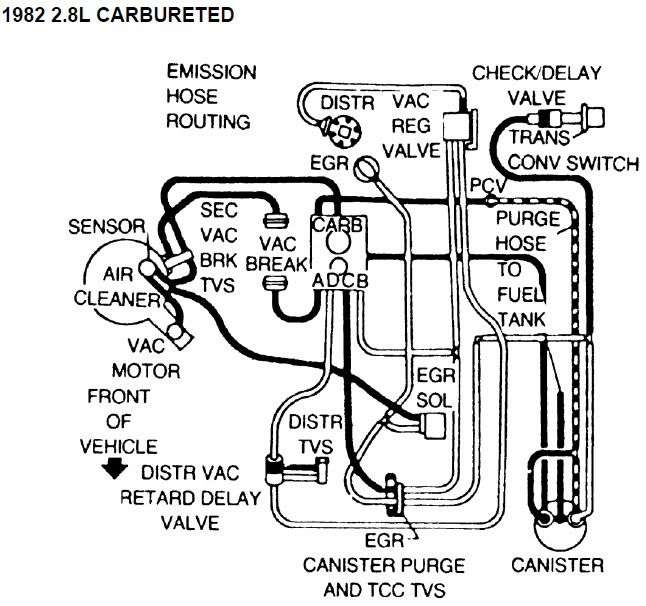

To start, The car runs fine it’s a 1982 SE 4 speed automatic. I recently replaced the carburetor with an OEM Remanufactured Rochester Carb. When reinstalling I noticed the previous owner had capped off most of the old carburetor which was probably why it barely ran and died often. I have since replaced all the lines based to the best of my comprehension off of this diagram I got on another thread and the car runs good enough to get to work everyday at the least but I can tell there’s still lines where there shouldn’t be and I was wondering if anyone had a IRL picture of another 82 SE engine bay with the carb cover removed so I can better gauge where these lines need to be. Thanks so much and forgive my lack of knowledge and experience. Carburetors are still super new to me.
