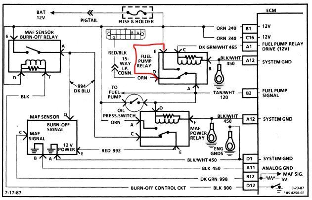

How does one jump power to the fuel pump on an '89 IROC Z LB9 TPI ? Thanks.

Looks like you could jump out the E to D terminal on the fuel pump relay or the orange to orange wires? If you remove the relay than it would be E to A.
Never done this but diagrammatically it looks like it would energize the fuel pump as described.
